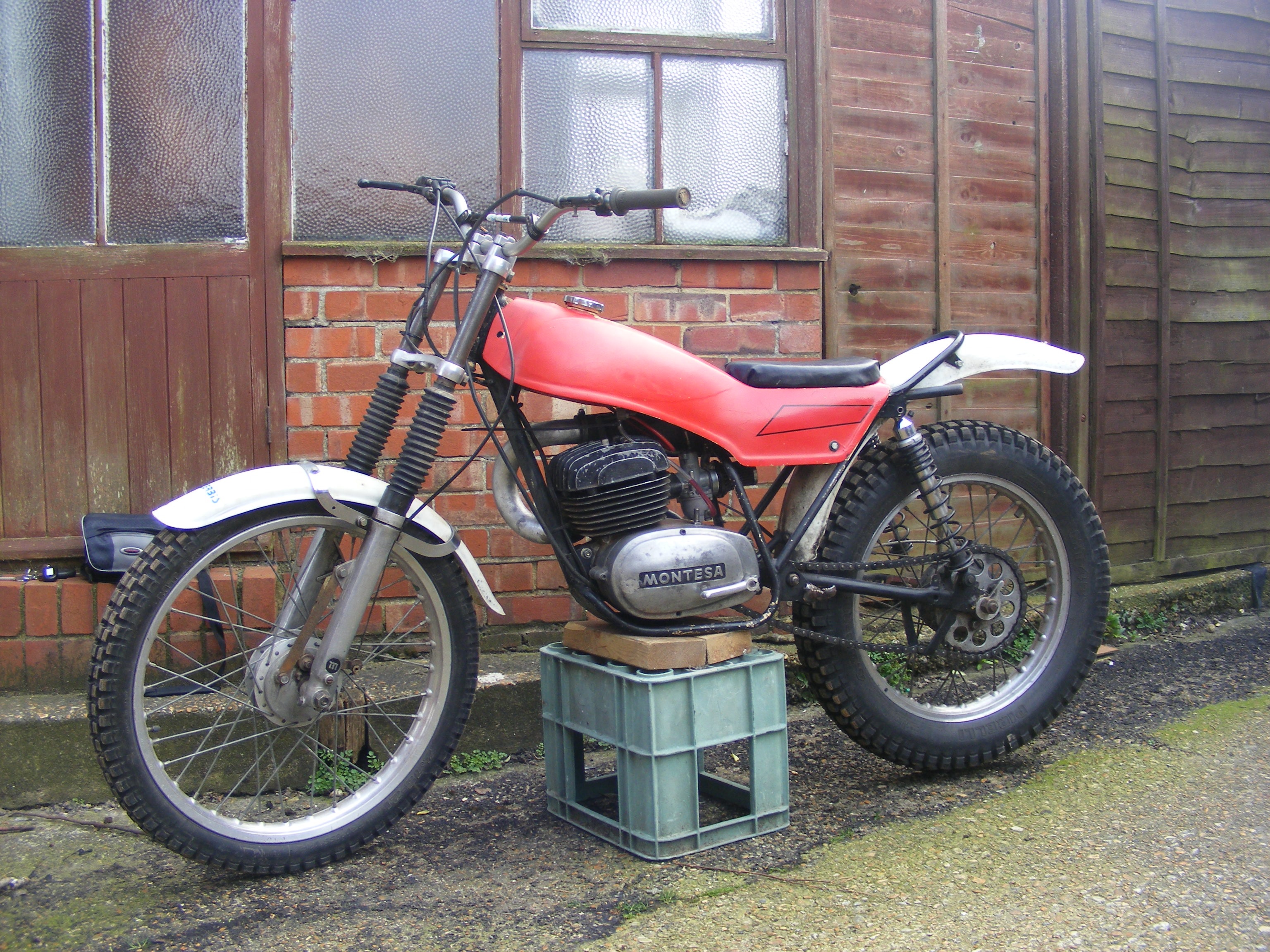

Hi, have started to rebuild a 1974 123. Stripped her down, now sending frame for powder coating. Cleaning the front and rear shocks, all looking good so far. Will post pics as I progress. Thanks Mike
