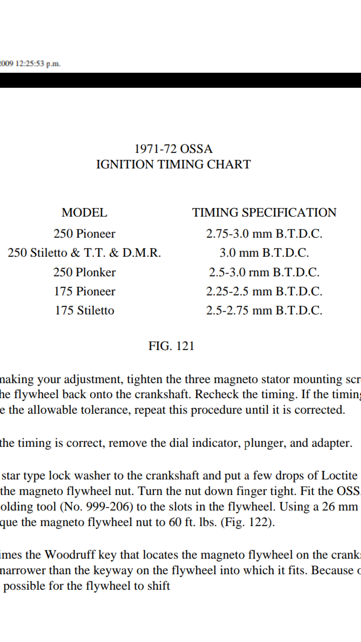

Anyone know the timing setting for a 1984 250 gripper tr80? (** edit 1984 doh **)
Found this for older models, is it near enough?

Setting at 3mm btdc would not do any harm as a starting point, but the manufacturers specs must be around some where! Not too sure if your Gripper may have electronic ign. Fairly convinced it’ll be on contacts breakers so go with 2.8mm btdc for zappy pick up or 3.25mm btdc for a bit less go and a softer engine??‍??

Thanks for that, didn't imagine it would be far out... it's electronic ignition on this one.

Have set it at 3.0mm will see how it goes..
