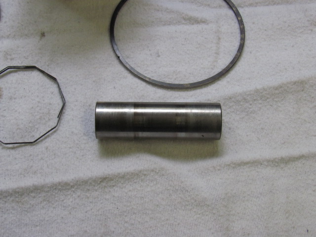

As you can see, the piston pin did not want to come out of the piston without some encouragement.  The threaded rod and two sockets provided the persuasion, but there was a surprise involved.

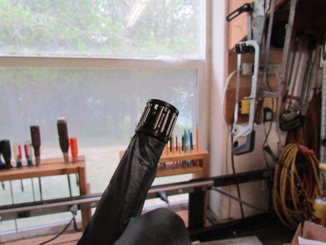

The surprise is that one of the needles in the upper end con rod bearing was missing out of the cage.  I don't know how long it has been missing or if it just flew off when the cage was released from the piston pin during dis assembly today.  I noticed it was missing when the cage came half way out the end of the con rod, but I have no idea where it went or how long it has been AWOL.

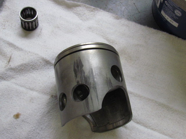

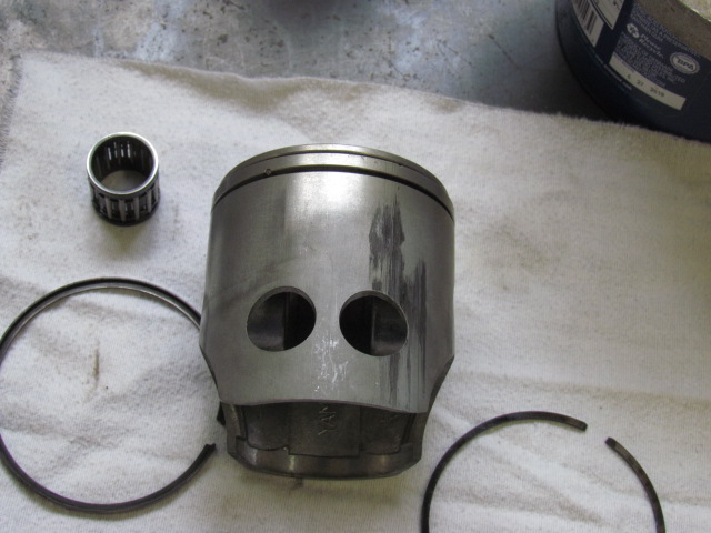

As far as the piston itself goes - looks like it is a stock diameter 69.96 mm.  It has the reduced diameter above the top ring and there is a ring expander ring under the bottom ring.Does that make it a 311 part number?
There was some scuffing on the piston just to the left side of the intake port, and this by itself does not seem to be a big deal, but the rings are grooved in this same position on the piston for a short span of about .25" or 6mm wide.

Rings - I was surprised to see the "L shaped " top ring on my 74, because the previous owner did not say anything about having changed pistons and furthermore, the L shaped top ring came along later on the 75 model. Right?
So I am wondering if this piston is really off of a 75 or later machine? Maybe someone can tell me for sure.
And inside the piston skirt it says YAMAHA, so it could be a 311 part off of a DT 250 or IT 250?  The top end of the piston is definitely a smaller diameter than the rest of the side walls. There are some numerical markings on the crown of the piston, but I am not sure what they mean.  You can see these in the pictures.
Rings- this piston has two rings and a ring expander inside the bottom ring.  There was 1/4 inch of damage of both rings near one end of the top and bottom rings.  looked to be vertical scratches about .005" deep
The free gap measurement on the top ring was 6.68 mm, free gap on the bottom ring was 7.22,, These are roughly in the ballpark.
The installed end gaps - top ring .019" with .020 being max.  (ring is pushed down into the empty bore and end gap measured)
                                     bottom ring  .015 with .016" being max
The last test is with the rings re-installed on the piston. The gap from the inside of the groove in the piston to the adjacent surface of the ring in the same groove.
Top ring .003"  Max .0031"
Bottom ring:.002  Max .0031"

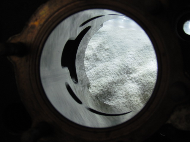

There does not seem to be any wear ring or lip around the upper circumference  of the cylinder.

As far as the missing needle bearing out of the cage - what do you guys think?  I think there was some cyclic vibration with this bike as it warmed up.  The vibration seemed to go away after it was warm - So the bearing could have been missing for years I don;t know.  I've only had this bike for one year. 5b70cd161463e_TY250topendteardown013.JPG.65f1e4dec322d15719a779ec38352f85.JPG The other needles look good with no flat spots and the cage is not cracked that I can tell.
Are the marks on the bore able to be felt with a fingernail? If they can be then you will probably need to go to the next size piston. Any of the quality aftermarket piston kits will be .5mm larger for each oversize where Yamaha had steps of .25mm

I would be looking nearby or in the crankcase for the missing needle roller and next time if you warm the piston up, the pin will push out by hand

you can be sure I tried that. I even turned the bike upside down on the handlebars, but nothing fell out.  (wish it did)

Are the marks on the bore able to be felt with a fingernail?  yes barely.
If they can be then you will probably need to go to the next size piston. Yes unless they can plate the bore back to stock size.
