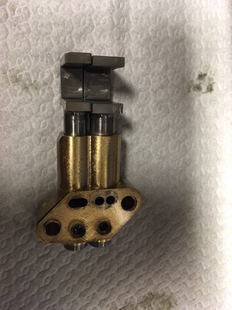

The pump is brand new.  I looked at the Morgo Website and it appears the latest type (square slider) pumps don't have springs and balls under them!  Interestingly, my pump doesn't have Morgo written on it.  I think it as a 3 digit number.

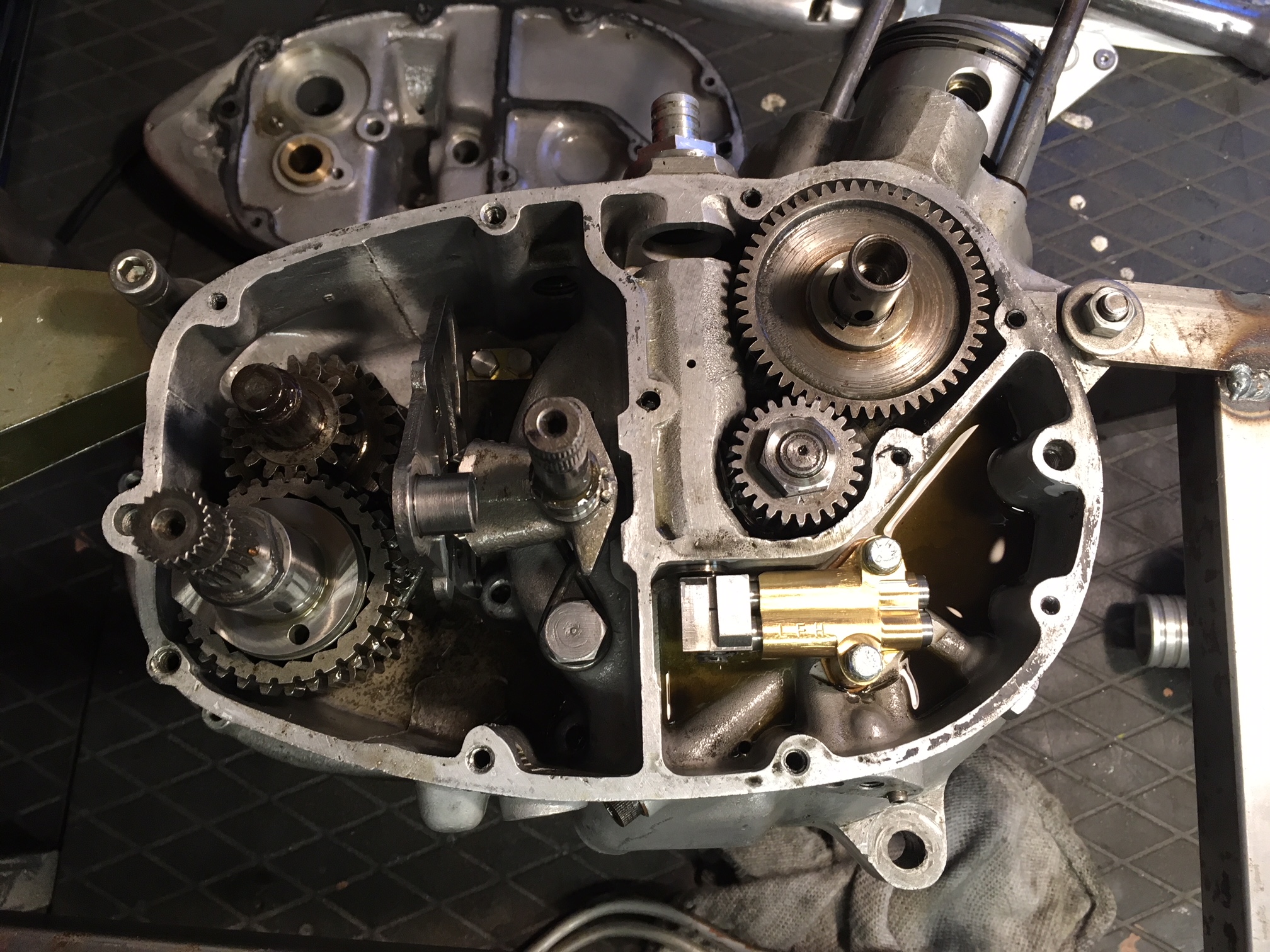

Managed to upload a couple of photos by deleting some old ones :-)
Should the oil pump chamber have oil in it?
Countersunk holes on back face of pump may indicate it should have balls and springs to stop wet sumping in my opinion.

There are valves, they are under the screwed in caps on the end (opposite the driven end)
