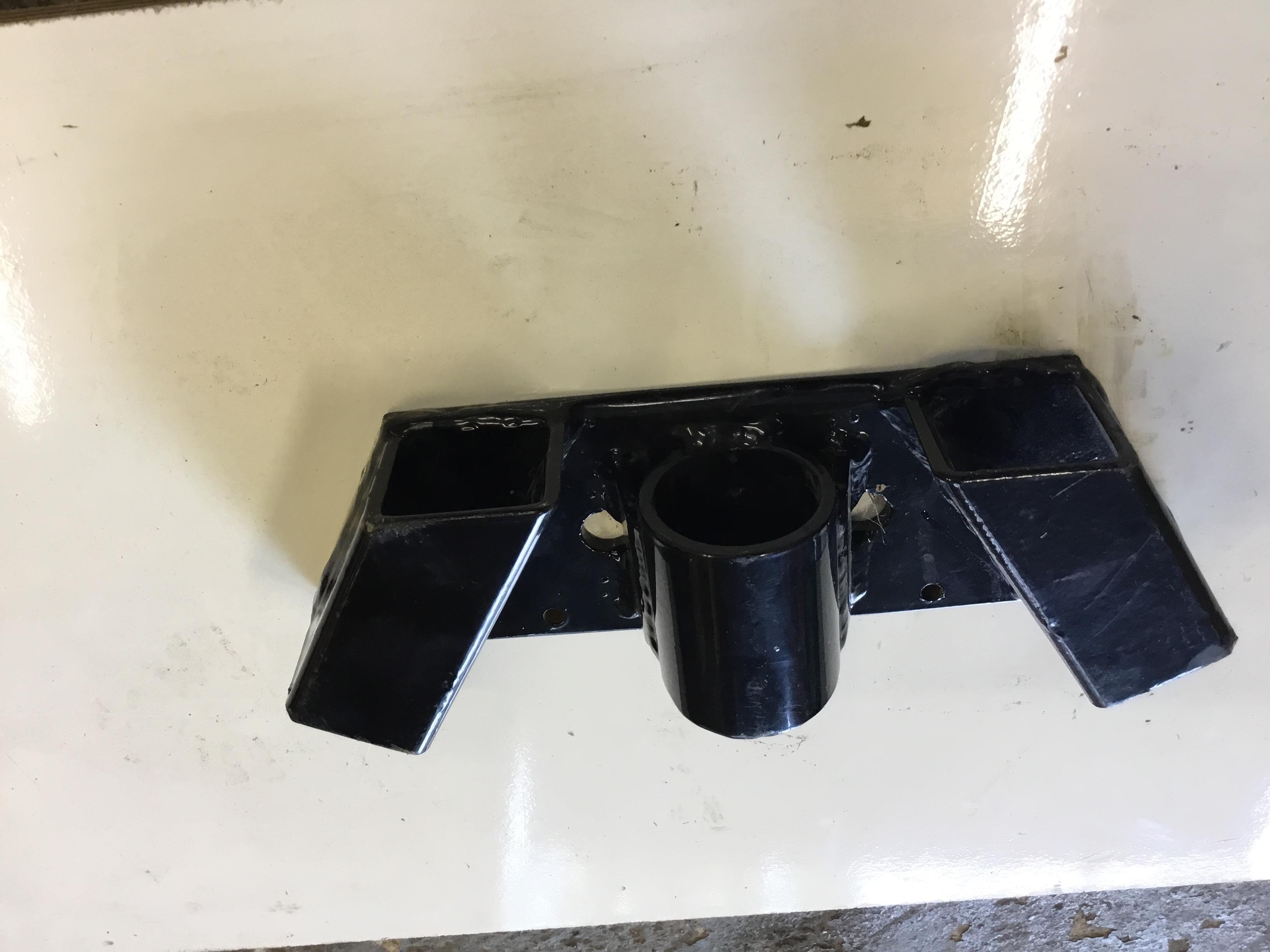

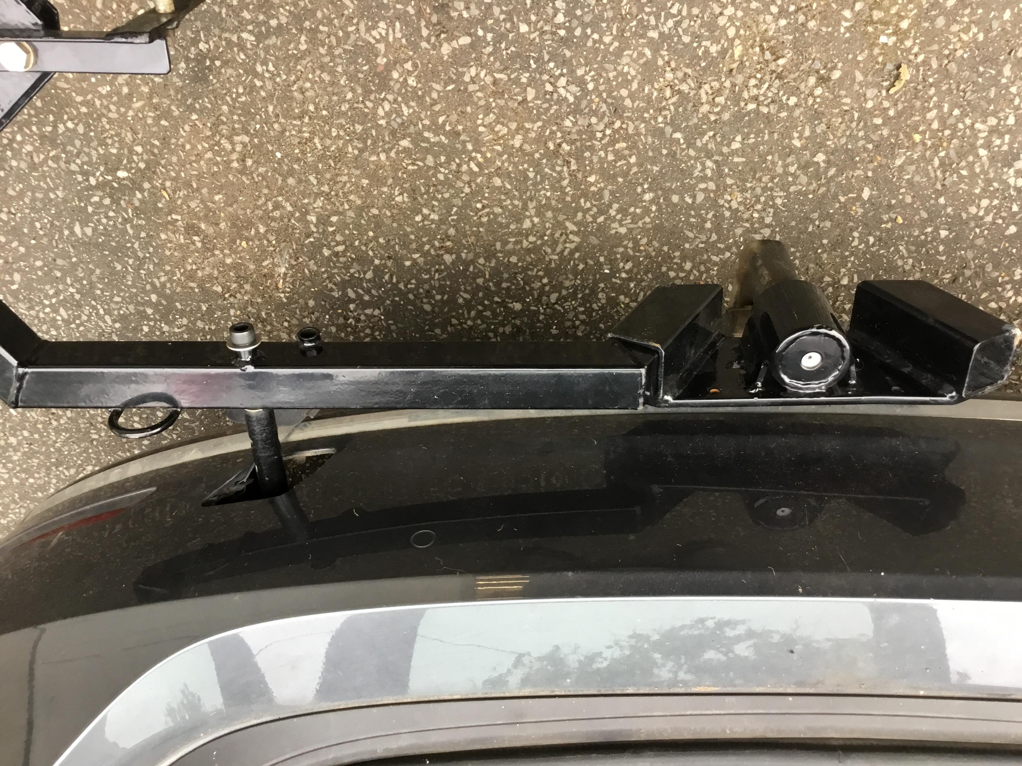

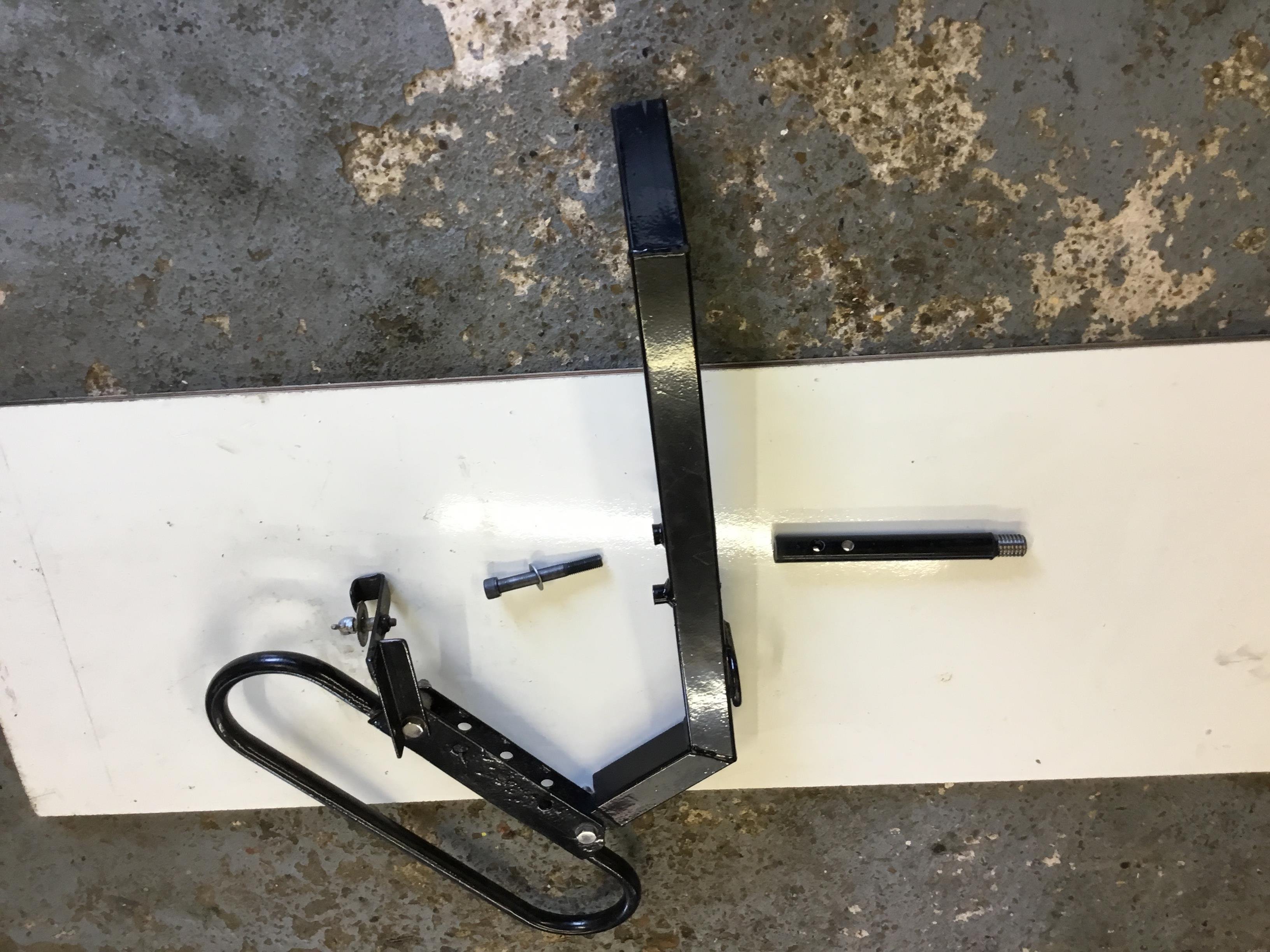

I have had the same problem with three BMWs with factory fitted tow bars, the best solution was to modify the mounting plate so that a thick walled tube fitted over the ball and then made a threaded fixing which screwed into the rear towing eye socket, the front wheel loop was them modified to also bolt onto the aforesaid threaded fixing.
If you want I can fit the rack tomorrow and take photographs.
The other advantage is if I get stopped I am not limited by the tow bar weight limit as some of the weight is taken via the towing eye socket

To go back to the original request for help I thought some might still find this interesting.
I have tried to attach some photographs of one of the racks I modified to go on a factory fitted swan neck type tow bar and uses the rear towing eye fixing to stop the rack moving. These racks have worked on four different BMWS, 3 series and 4 series. The relative position of the tow ball and towing fixing does seem to change model to model so they have been modified a few times in the last 15 years.
The towing eye fixing is a strange thread, eventually I identified it as an ACME thread, and again this has changed model to model.
