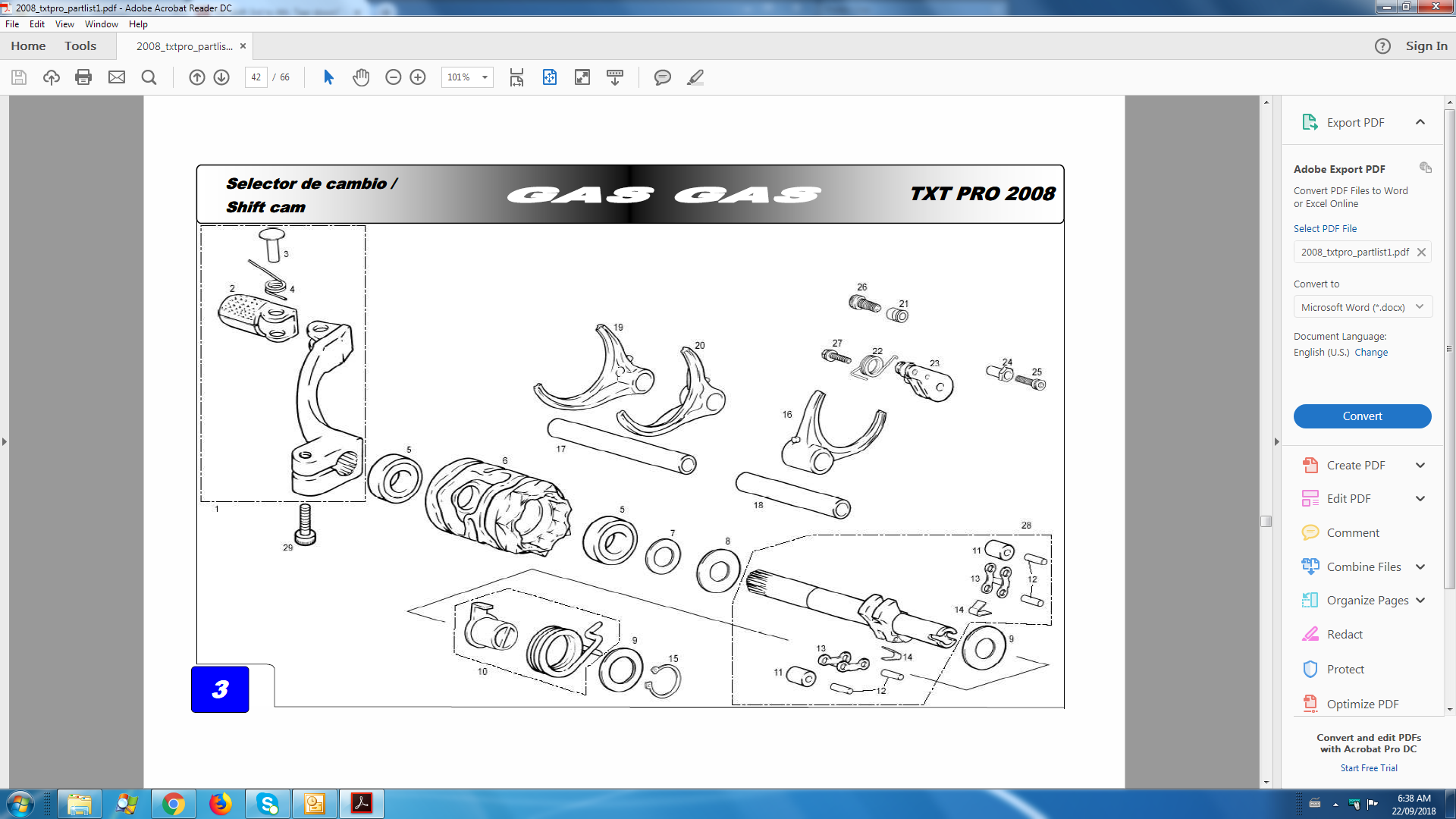

Very interesting Peter. Is your top hat and spring part #10 in the attached diagram?
 10 is correct, the weld breaks away. This is always good to check before tear down. 10,11 and 12 is probably the cause. Buying the whole assembly is the easy way.
The crossbar on #10 will break and spin inside the cylinder after a hard hit. My guess is #13 cracked and you have to buy the whole shift shaft assembly #28

On my 07 the crossbar on #10 is not welded but pressed in. It is like a fuse, your bike will shift if it is good or won't at all if broken. After it breaks you can tap it out and replace it. I found a piece of deadbolt wood frame reinforcer fits perfect and I keep it as a spare.
I acknowledge that I'm not the original poster (bikerpet) but I'm interested in this repair. What (major) wrenching operations are required when replacing #10? When replacing the entire shaft? Can one do the work after only removing the clutch cover and clutch/basket, or does the case have to be split (after removing the engine from the frame, then removing the cylinder, et al)? Can the shaft seal (#5) be reused or does removing the shaft damage the seal?

  • The common kickstart quadrant/idler damage - both have bits missing. There is evidence of bits going into the box and damaging the boss that holds the RH end of the rear shift fork shaft (17) and slight damage to the face of the fork in that area (20). Other than that things look undamaged in the gearbox luckily.

  • I've inspected the top hat (10x magnifying glass) and the weld is definitely intact, and the bar is also absolutely undamaged. Even if this was damaged I believe the gears would still shift, just not recentre correctly and need manual repositioning. This was confirmed by Hell Team. In my case the gears would not shift 3rd to 4th whatever I did, 1st to 3rd where fine, suggesting this isn't the culprit anyway.
  • Inspected the shift drum (magnifying glass again) it appears perfect, no visible wear on tracks. Slight polish to the internal and external stars, but nothing that looks like wear. Bearings smooth and good.
  • Shift drum shaft (28) has about .05 - .07 mm runout (clocked between centres in lathe) toward the shift lever end. Rolling it on a surface table shows no perceptible bend through the main length. The measurement in the lathe is a bit iffy - there was .05mm wobble right at the top-hat end of the shaft, running on a centre. I decided it wasn't worth trying to nail this down as I reckon it's probably what I'd call straight in this application. Perhaps an incorrect assumption.
  • Inspected the forks - neither fork is absolutely dead flat back to back. I've had them on the surface table and both have some small deviations, but nothing that really looks significant. Again the Hell Team advised that unless they are badly damaged they would not effect the shifting. The pins show no sign of wear. The surfaces of the forks that engage the discs have differing wear patterns - RH rear fork (20) only has polish at the tips. (19) & (16) have polish along much of the surfaces. None of them look scored, just polished.
  • Inspected the fork shafts (17 & 18) - straight and smooth.
  • Inspected the internal rollers, carriers and springs - no sign of anything worn, bent or damaged. Both rollers sit symmetrically out from the shaft.
  • Cavity the internal rollers run in has very slight wear at the corners the rollers run over as they move in and out, but it is very minimal - only slightly more than "polished".
  • External roller (23) also appears fine.
  • Selector discs all move freely and no signs of damage.
The most puzzling thing to me is that after disassembling and inspecting everything and checking each component's function (including moving the selector drum up and down the positions) I put it back together in the RH side case and tried changing gears. 1st to 3rd where good but then 3rd to 4th was as if the internal rollers just weren't engaging in the star, the lever just moved up with very little resistance. Obviously impossible to see what was going on in there. This felt about like it did when the bike was together. The difficulty is that after gradually removing each shift fork one at a time again, it started shifting and continues to do so if I put everything back together!

Lineaway, you said "10,11 and 12 is probably the cause ". That would be top hat assembly and the internal rollers. What would you expect to be wrong with them? I'm suspicious about that shaft assembly but reluctant to spend nearly $200 on a suspicion.
Puzzled.
Peter
 Usually it is pretty obvious with the rollers. Usually a broken side plate. I have seen people swear the top hat was fine, but was broken.

Wouldn't a broken top hat effect all gears similarly? This only effects 3rd to 4th. 1, 2 & 3 have always been perfect. And even if the top hat was completely removed the gears will still change, just the shifter won't return correctly.
I'm now wondering if a stray piece of metal from the starter gears was somehow caught in the shift drum stopping the internal roller from engaging for 4th. Clutching at straws.
