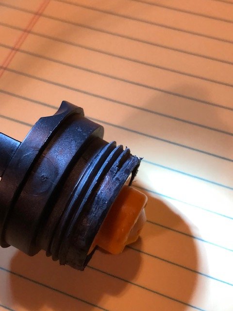

It is extremely easy to cross thread the gas cap on my 2019 Beta during installation.  A friend said the same is true with his 2018.  I have read that older Betas had aluminum caps rather than plastic like the 2018-2019 Betas.
Any cross threading situation can be cured by changing one or both threads to blunt start threads.  The attached picture shows the modified gas cap.  Modifying the female thread in the gas tank would require careful flushing of the gas tank afterwards so I opted to only modify the gas cap male.
I used an exact knife to remove about two full threads from the gas cap which creates a male pilot to properly align the gas cap.  I then used a Dremel tool with a small end mill like cutter to clean up the removed threaded area to a diameter smaller than the female thread minor diameter.
The O-ring was removed before modifying the threads.
A picture is worth a thousand words:

I've read that the cap swells with time.  But a bike that is less than a few days old, that has the cross threading problem, before any fuel is put in the bike, tells me that it is definitely a thread geometry problem.
Changing the cap to a blunt start thread fixes the cross threading problem immediately.  A blunt start thread is a common solution to a thread geometry problem.  It is very common in the nuclear and aerospace industries.
I don't expect it to fix the swelling problem, as that is a material problem.  My Sherco had the swelling problem, but it had rounded threads.  So five minutes with a 1/16" diameter drill and some 220 grit sand paper was an easy fix.

My Beta dealer called today and said that due to the cross threading and swelling problems, Beta is replacing plastic gas caps with aluminum gas caps under warranty.  I do not know if this applies to 2018 Betas also.  I have read that prior to 2018, Betas had aluminum gas caps.
If you have a 2018 or 2019 you might want to call your dealer to check if you are eligible for a aluminum gas cap.
