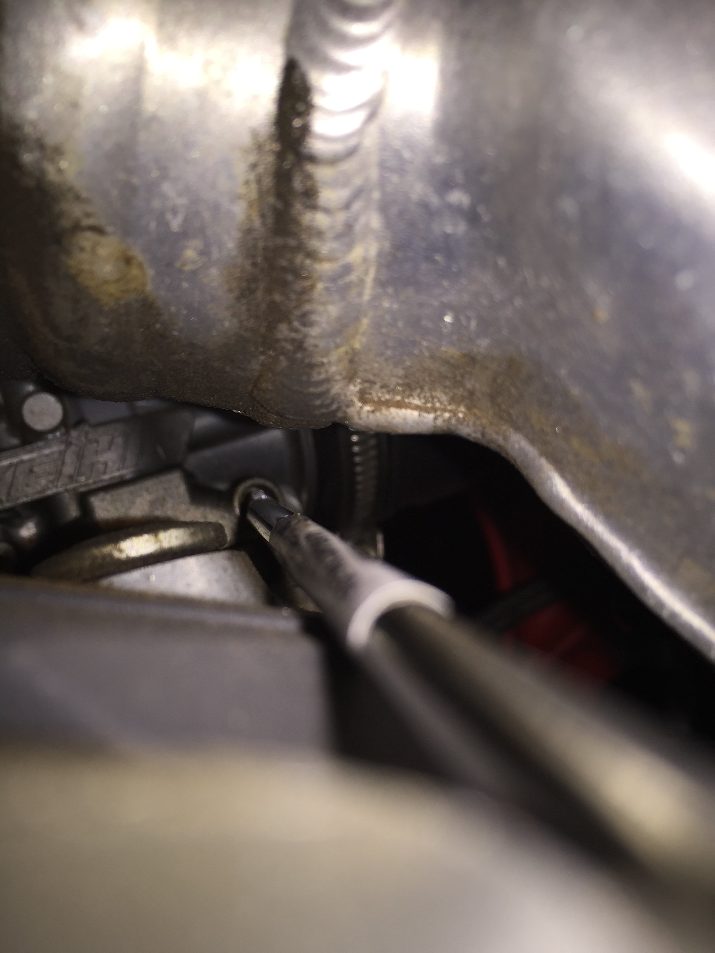

I think the mixture screw can only be accessed from the left hand side. Adjustments should only be made with the bike fully up to temperature.
Take the fuel line off, then operate the tap so you can check if the tap is working, it takes longer than 30 secs for the engine to use the fuel in the float chamber at idle.
The air mixture screw is at back of the carb, if you look through where your exhaust is you will see it it’s a brass coloured one, you can get a adaptor for this from beta it replaces the screw and has a big head on it to adjust it when riding, if not long screwdriver will do it, as said I would take fuel pipe off and see if fuel tap is working ok the photo you put on with the purple highlight is when the mixture adapter is fitted these are hot standard

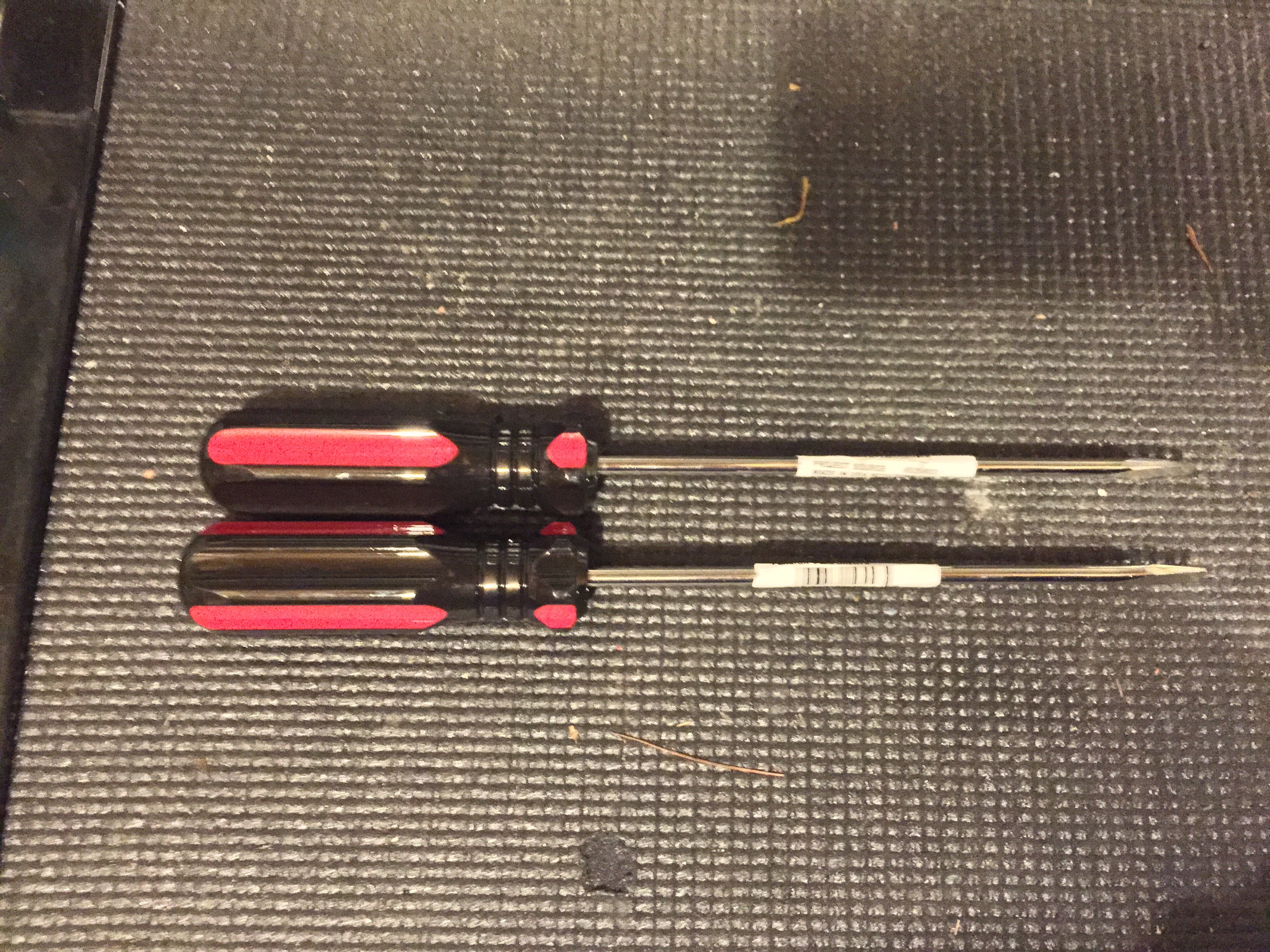

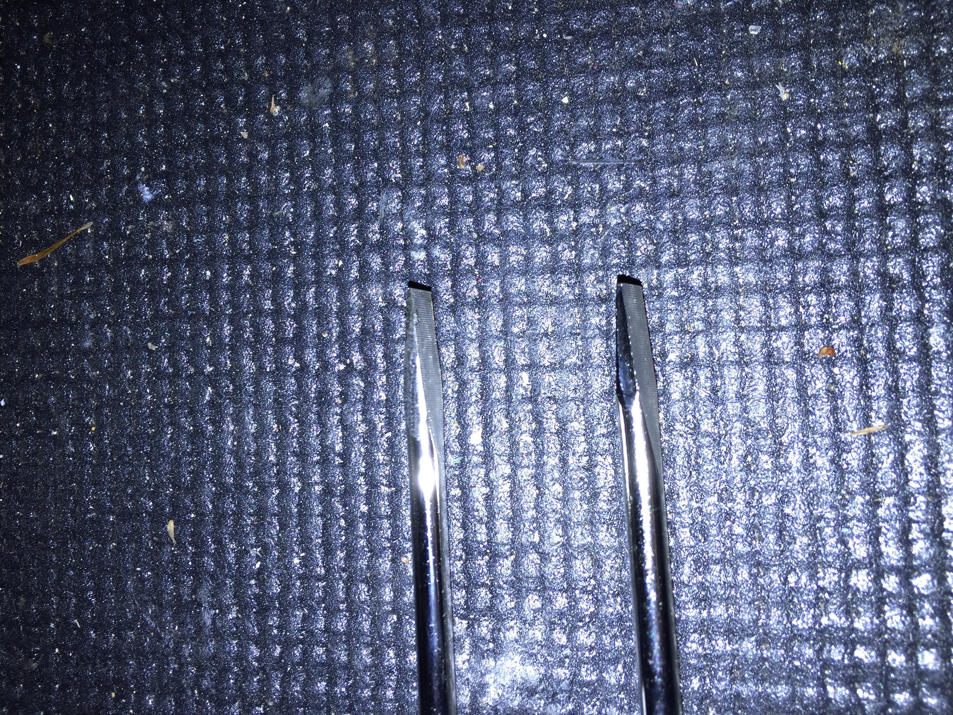

Get a long thin flat blade screwdriver. Actually buy a couple because you’ll lose them. Grind the end round. Voila! Beta mixture adjusting tool.
