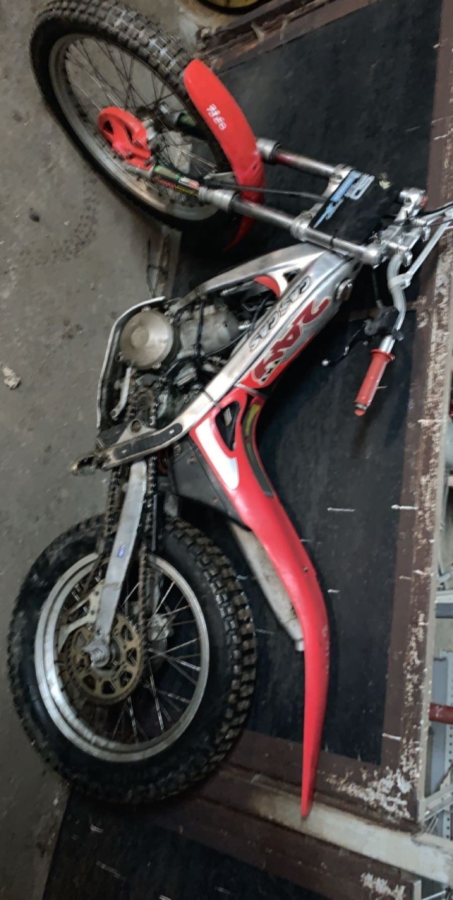

Got this TXT 249 on Saturday, not sure of year... I am new to trials bikes... bought it blind at an online auction as a learner bike and a bit of a project... not had a proper look into the issue yet but was just wondering if anyone had any suggestions or pointers as to what it could be... any help/advice would be appreciated.

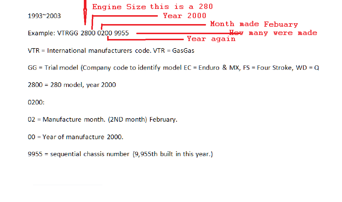

Looks like a 99 model. I'd drain the fuel and put fresh (2 stroke) in and also strip the carb as mentioned and clean air filter and spark plug. Those bikes were bulletproof
Looks like 98/99 model .But as said earlier probably pilot jet, Carb strip down needed.
