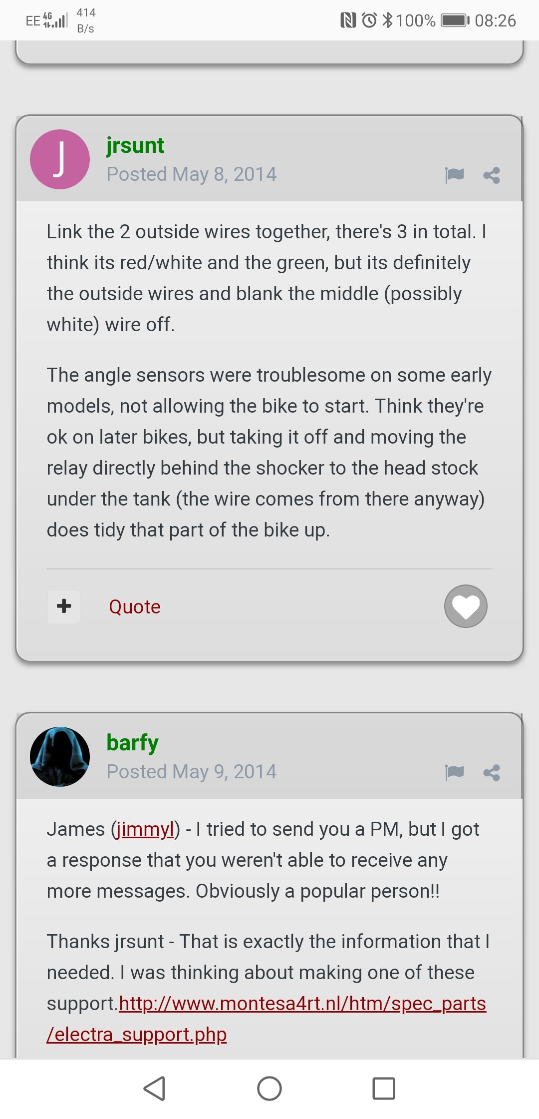

Can anyone point me at an "how to" for getting rid of the Bank Angle Sensor please
