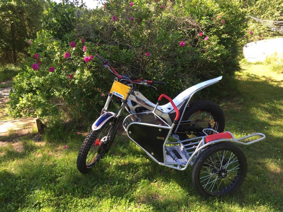

Hi Stu,

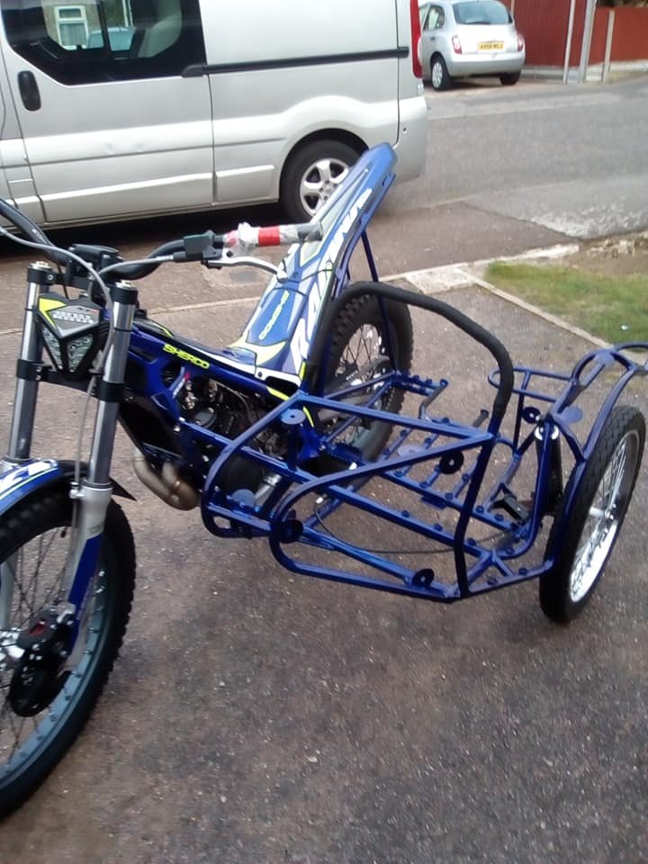

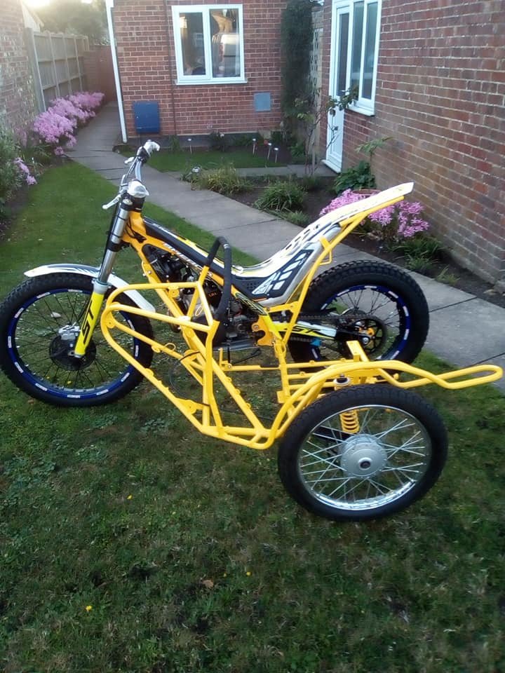

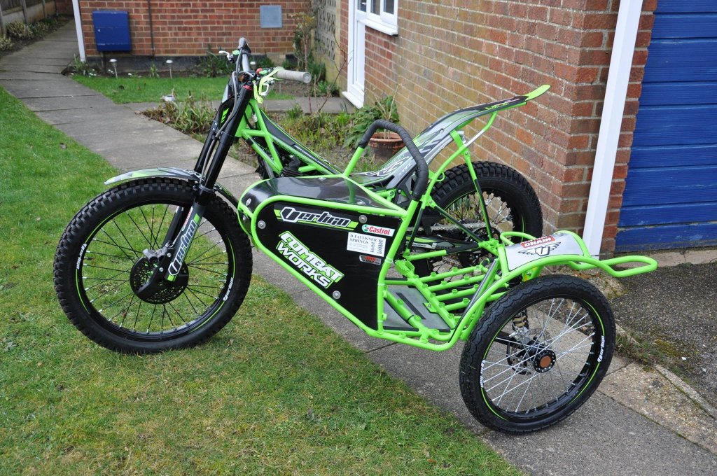

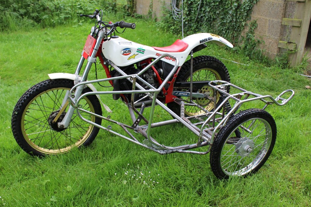

  If you get the geometry correct you shouldn't need adjustable mounts. But do make the sidecar detachable. The most important dimensions are, Track of 34.5",Wheel lead (sidecar wheel spindle 9.5" > 10" ahead of rear wheel spindle) and a toe in of 1.5" over the wheel base of the bike.   I set mine in a jig that I built. The bikes suspension is unloaded and fitted with the heavy duty rear spring. For a modern mono bike your looking at around a 900 lbs per inch spring (so you may find that your air shock will struggle). The tires are at working pressure and the bike set vertical in the jig. Most of the sidecars used have the sidecar wheel vertical or cambered in a little and the vast majority have a suspension geometry that increases the camber in as the sidecar suspension is compressed.  These are just a few I have done in the last  few years.

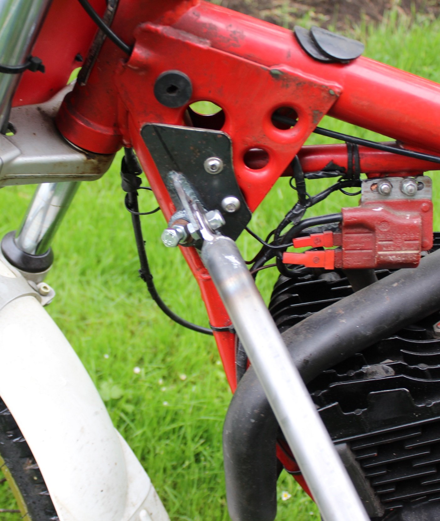

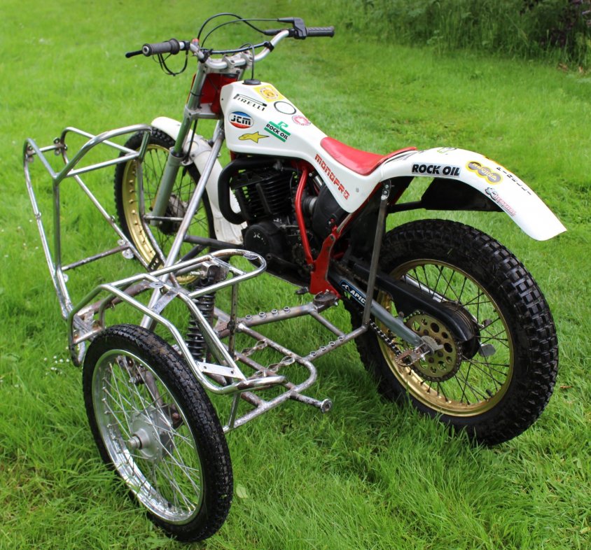

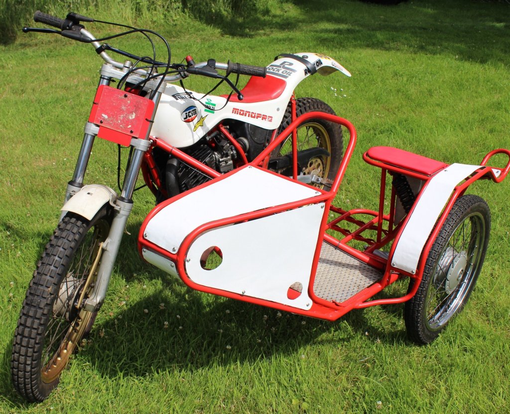

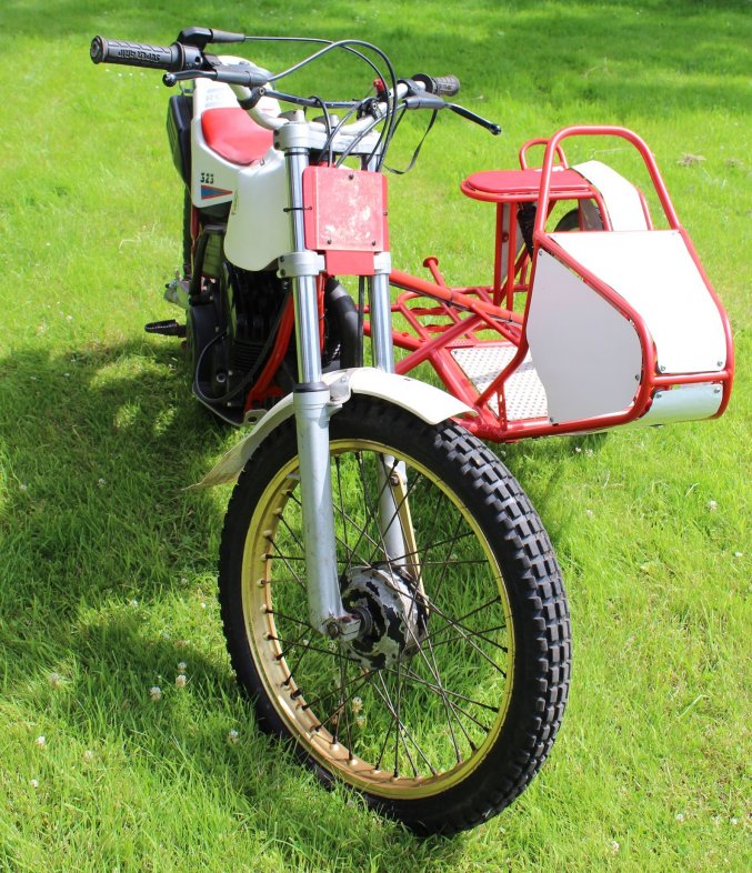

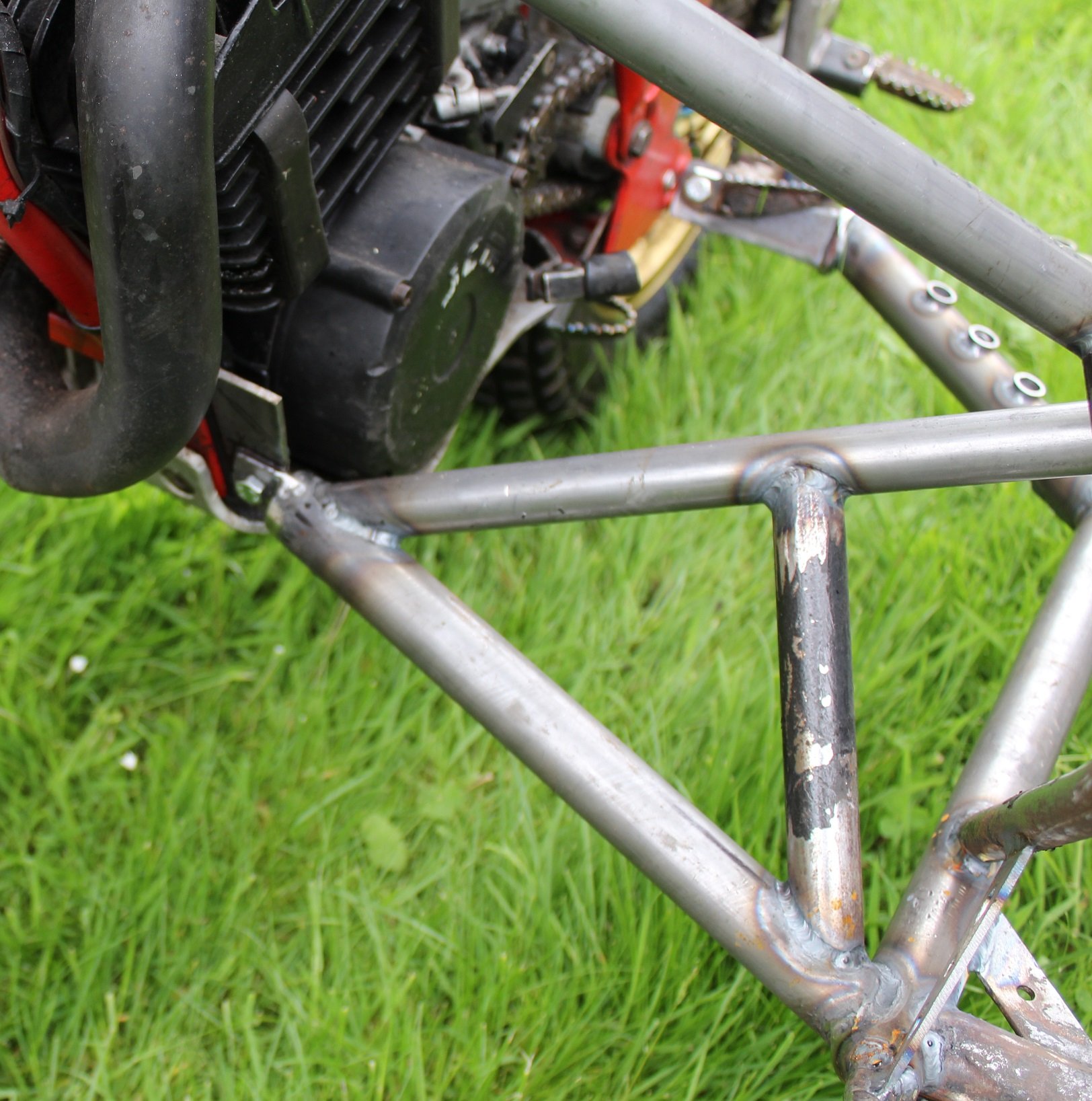

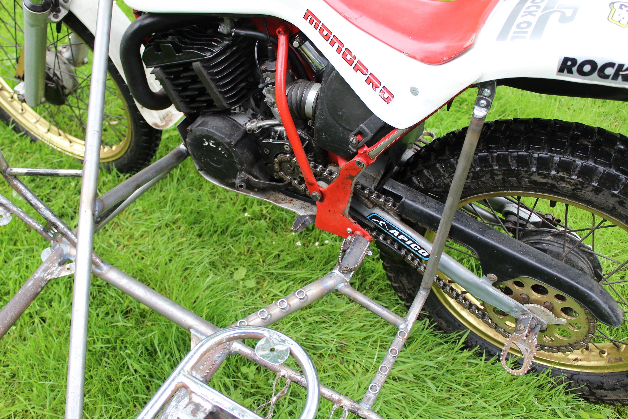

After much cutting, grinding and welding I have finally managed to get the chair attached to the bike.  Am quite pleased with the result.
Fabricated a jig to hold it together whilst I worked on it, and set it up as per the measurements from p@ul250.
The headstock mount was a little tricky.  I had to utilise the bolt that acts as a steering stop as one of the mounting bolts.

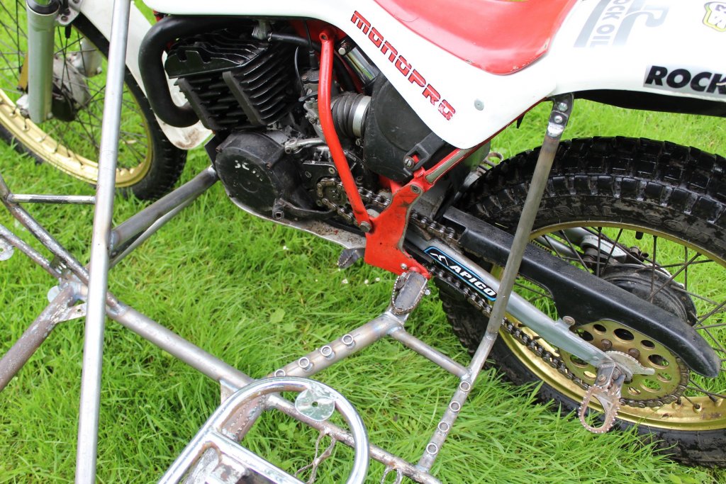

The lower front mount is a modified engine mounting plate.  The rear is attached to the original footrest mount.
Had to replace the side bar on the chair as it was cracked and the fourth mount up to the rear subframe is to try and prevent this happening again.
Have fabricated a footrest attached to the rear wheel axle, and a chair brake pedal, which I have squeezed in under the bike swinging arm.

Have given it a quick ride around the garden with a bag of sheep feed as the passenger. It seemed to handle well and was huge fun.
Need to sort out the chair brake, for which I will use an alternative wheel with  a drum brake, (in keeping with the bike), give it all a coat of paint, and attach the floor and side panels.
Then I just need to find a passenger!

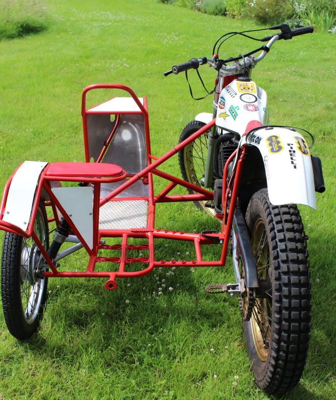

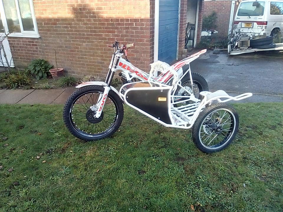

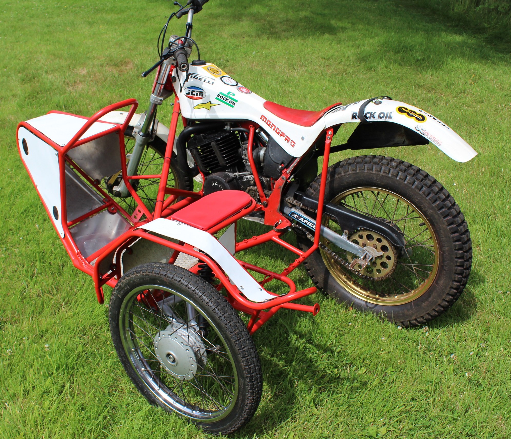

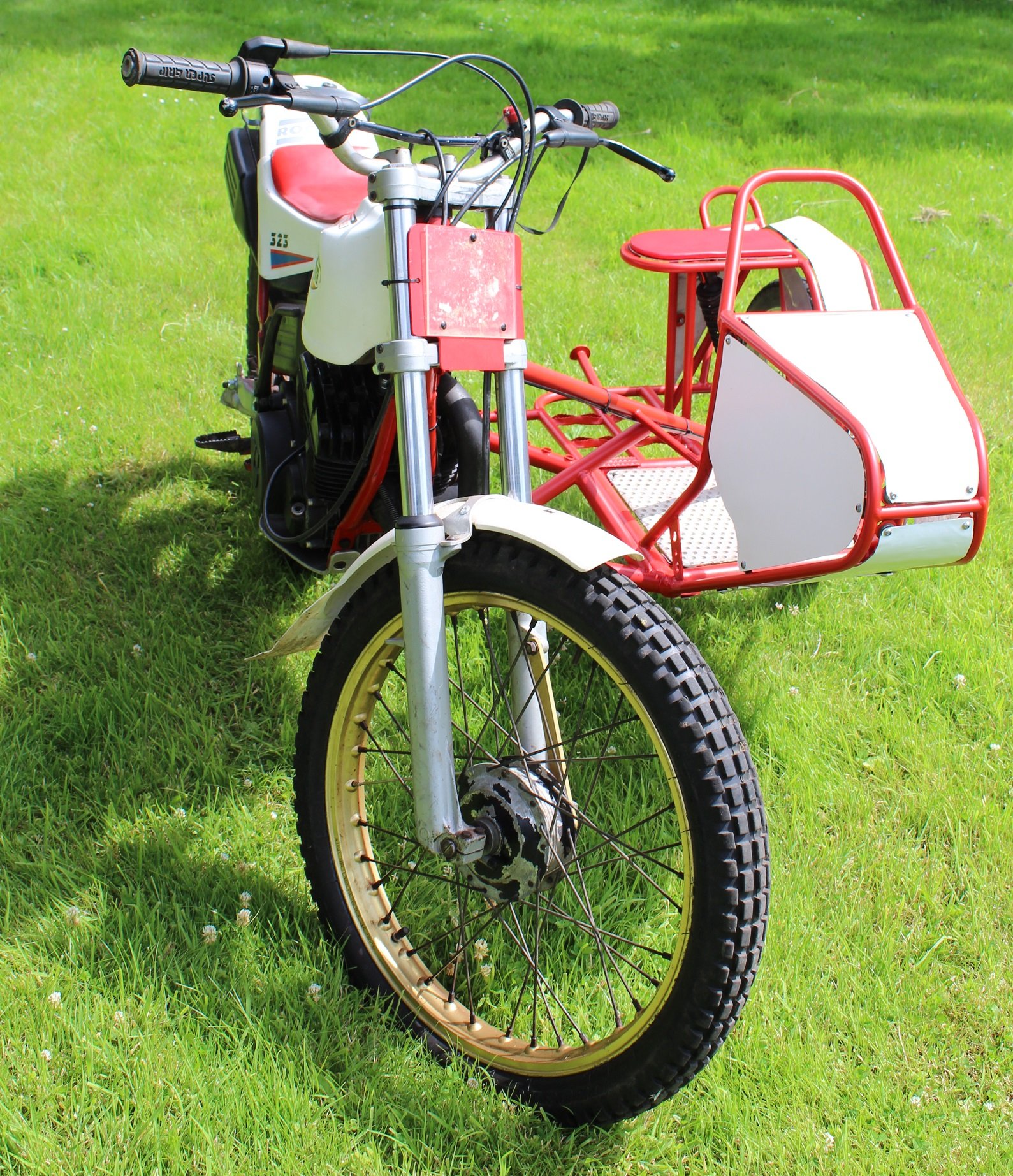

Finally finished!
Fitted the wheel with a drum brake.  Had to change the bearings and drill out the brake plate to take a 15mm axle.  Soldered a new brake cable which routed neatly under the tank and down to my new brake peddle.
Painted the chair frame and brackets.  Wrapped the ally panels with vinyl wrap to get a white finish to match the bike.
All in all very happy with the final result.  Could this be the only JCM outfit?
Have had a quick ride with my daughter as passenger and the rear shock seems hard enough.
Will try and convince some of my local clubs to include sidecar sections, so I can give it a proper test.
If you are looking to have your own outfit I would strongly suggest you start with one someone else has already done, would be a whole pile less work!

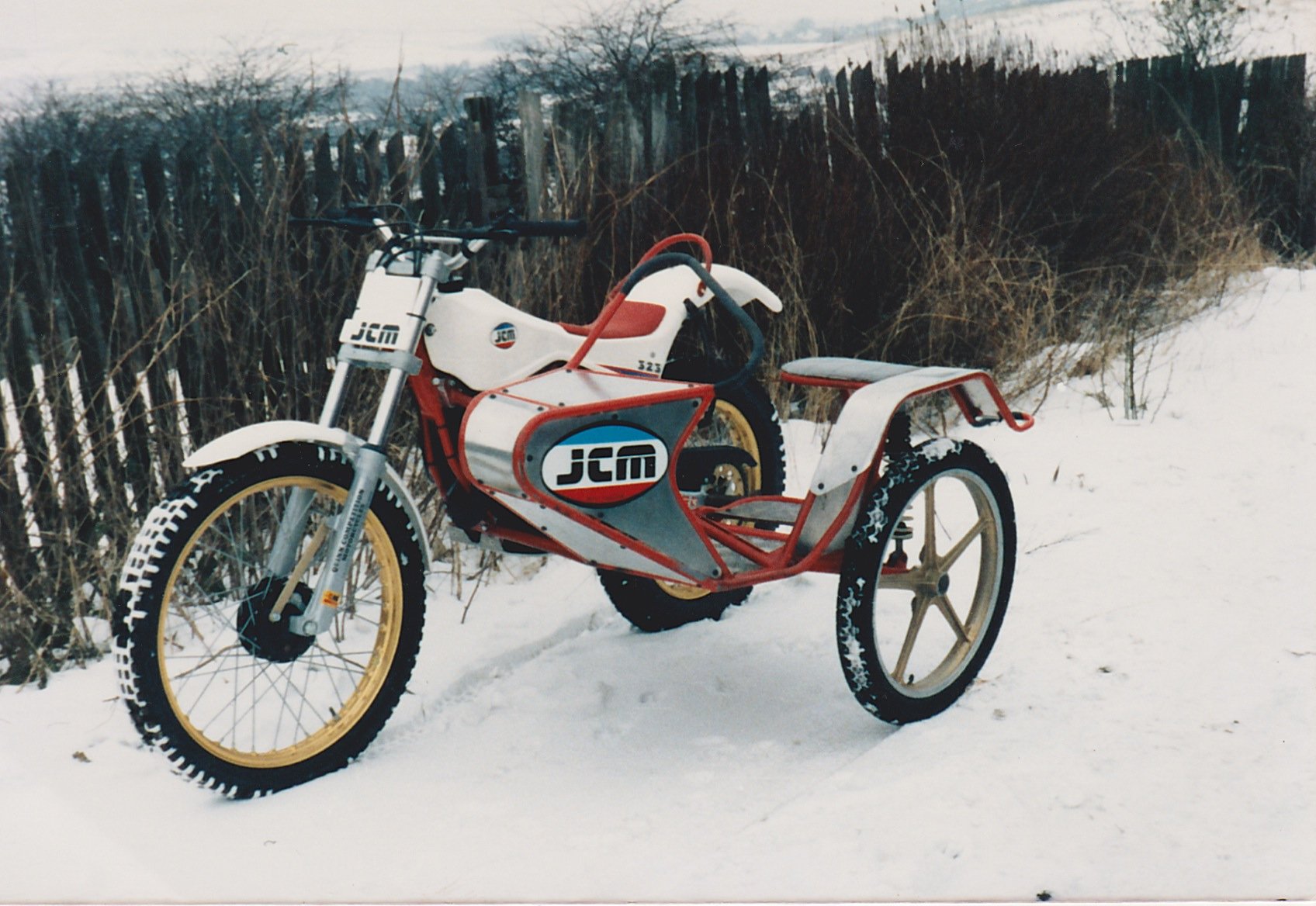

Have discovered mine is not the only JCM outfit.  There is one in Joel Corroy's JCM museum.  Won the 1985 French championship apparently.
Gives me much reassurance that the bike generally, and the air shock in particular, will be up to the job.
  • 1 year later...
Hi, just came across this post, I competed on a JCM 323 trials outfit in 1986 finishing 2nd in the British Championship to Robin Luscombe, it was fitted with an Otter sidecar.
