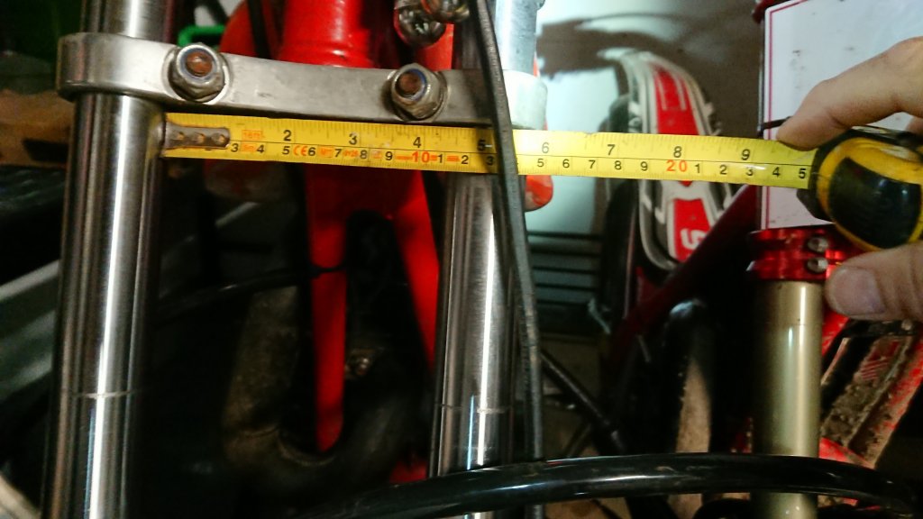

It looks like I have 110mm between forks and approx 145, centre of fork slide to centre, is this standard for a MH349?
You have the WRONG triple clamps/yokes for a MH 349. As previously stated, 170mm centre to centre or if you like 135mm inside to inside.
thanks, i just wanted to be sure and add in a picture with dimensions.  thansk, now i just need to find a set of clamps that are the correct ones. keep your feet up!!
Attached is a couple of pics of my Cota 349/4 yokes which are the same as MH 349, please note that my bottom yoke is not original and doesn't use a nut and bolt as per original, it uses a bolt into thread. I had this made for me years ago due to original being cracked. Can you post some pictures of your front wheel and hub setup please, very curious to see what some monkey has done to you, those binding marks in your stanchions indicate something is wrong.
