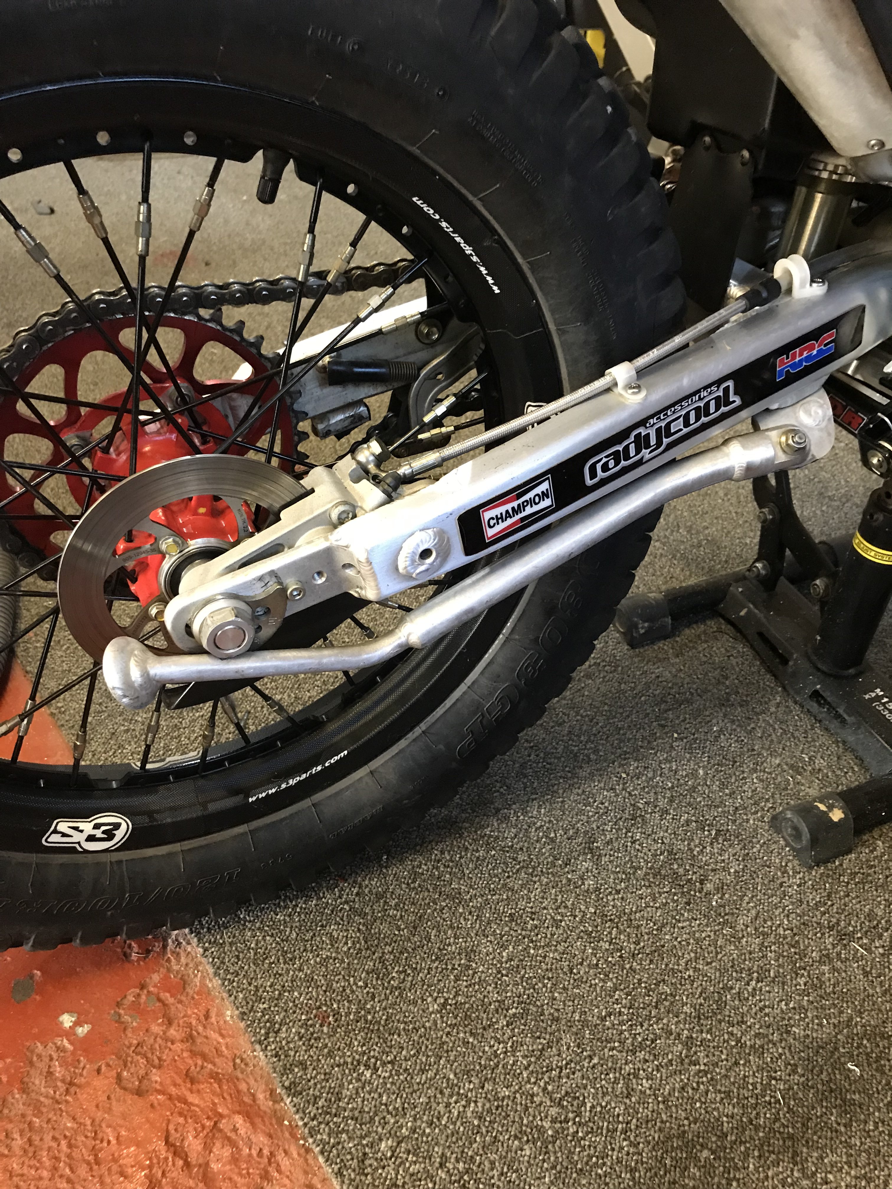

Maybe someone can help with this then, just picked up our kids 260 and it’s got this stand on it, anyone any idea what/where from?

That's a Mitani kickstand.  I have one on my 07 4RT and love it.
That one doesn't look adjusted correctly as the foot should come up over the swing arm to prevent it from hanging down where it could get hit.
Thanks for that a great help, i see what you mean it looks as if it needs to swing out more to miss the axle nut.

Another suggestion from the image above. You're at the end of snail cam adjustment, and from looking at the tensioner, you may need another notch (but can't tell for sure).
No need to remove a link. There's another set of threaded snail cam stop screw holes aft of the current stop. It's under the cam now, but if you loosen things up and rotate the cam you'll see it. Move the stop screws, and you'll get back to the low end of the cam.
That's a real bonus getting the Mitani sidestand. Much better than stock.
Thanks great advice, will the slightly longer wheelbase have any tangible effect?

Better grip.

I find longer wheel base will provide better grip in slick conditions and on rough ground.  It dose change rear wheel hop timing a touch but I don't think most people would notice that much, and technically would make a bike turn a bit slower however again not sure how many people would really notice that.
My 2 cents/experience.  Hope it helps.

I always thought shorter wheel base gave better grip as moved weight to the back - longer wheel base gave stability and kept front end down and hence the 52" or so compromise on the majority of trials bikes over the years.

Moving the wheel back, without doing anything else, will make the suspension slightly softer. In my experience, longer wheelbase improves grip. (Look at hill climb bikes)
