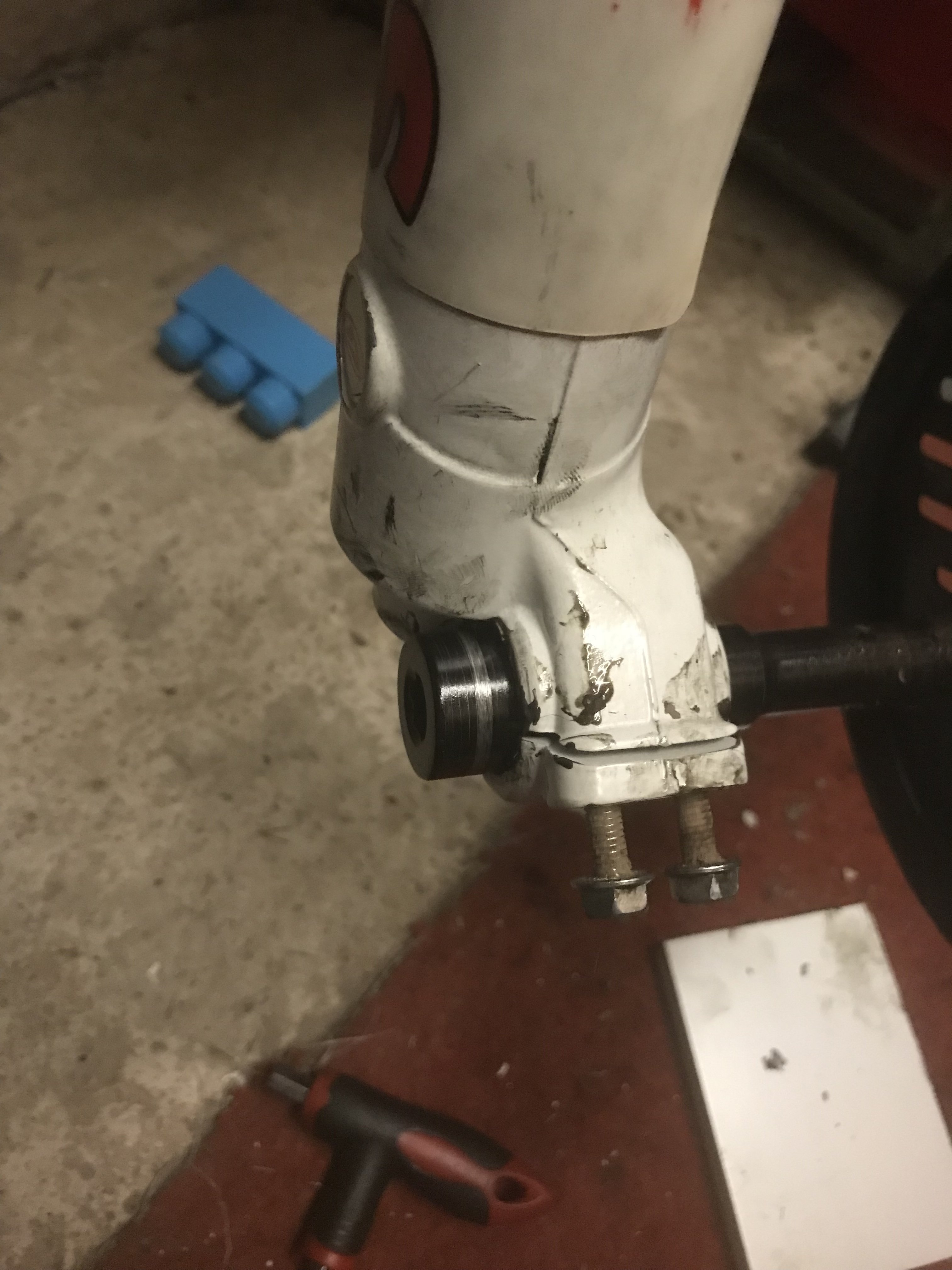

This is as far as I can get it in before it goes tight , any ideas anyone?
I’m guessing it all came apart ok? Are the threads clean, spindle and fork lower? None damaged? All in line? Try cleaning out with a toothbrush and brake cleaner. Inspect closely. Then try again. If that works great. If not check exactly what you are doing. Smear grease on threads and any clamping surface when doing final install.
It was tight coming out when it unthreaded instead of just winding all the way it it tried to push the forks apart (the mudguard and brace where taken off)but I noticed fairly quickly and just tapped it through , the spindle threads into the fork leg from the other way fine so I know the threads ok as I was worried it had cross threaded
Try putting the spindle through without the wheel to make sure the legs all line up correctly.
Also you say the spindle threaded in from the "other way".  Try putting it into the brake side fork leg and screwing it in there as it could have a damaged thread on that side where the spindle first contacts.
Hi yes thats what I meant by the other side I’ve tried it without the wheel and in from the disc side and it was still tight at the end of the thread , I’m beginning to think it needs re tapping I just can’t see any other reason why it’s so hard to screw in
You haven’t dropped the spindle on it’s end and collapsed the first bit of thread have you?
Have you tried the screwing the spindle in to just the threaded fork leg on its own? Sounds to me like the threads are damaged or as pindie suggests deformed due to being knocked. If this is the case then it will need tapping out using a tap and die set or in the past I've used a high tensile bolt with the same pitch thread that I've ground a taper on the end (start of the thread) and slowly persuaded it through with plenty of oil!
Thanks for your help everyone problem now solved , the thread was damaged right at the start of the thread that’s why it wouldn’t go in ,re tapped it and went straight back in , its an18mm tap with a 1.5mm pitch if anyone needs the info ?
