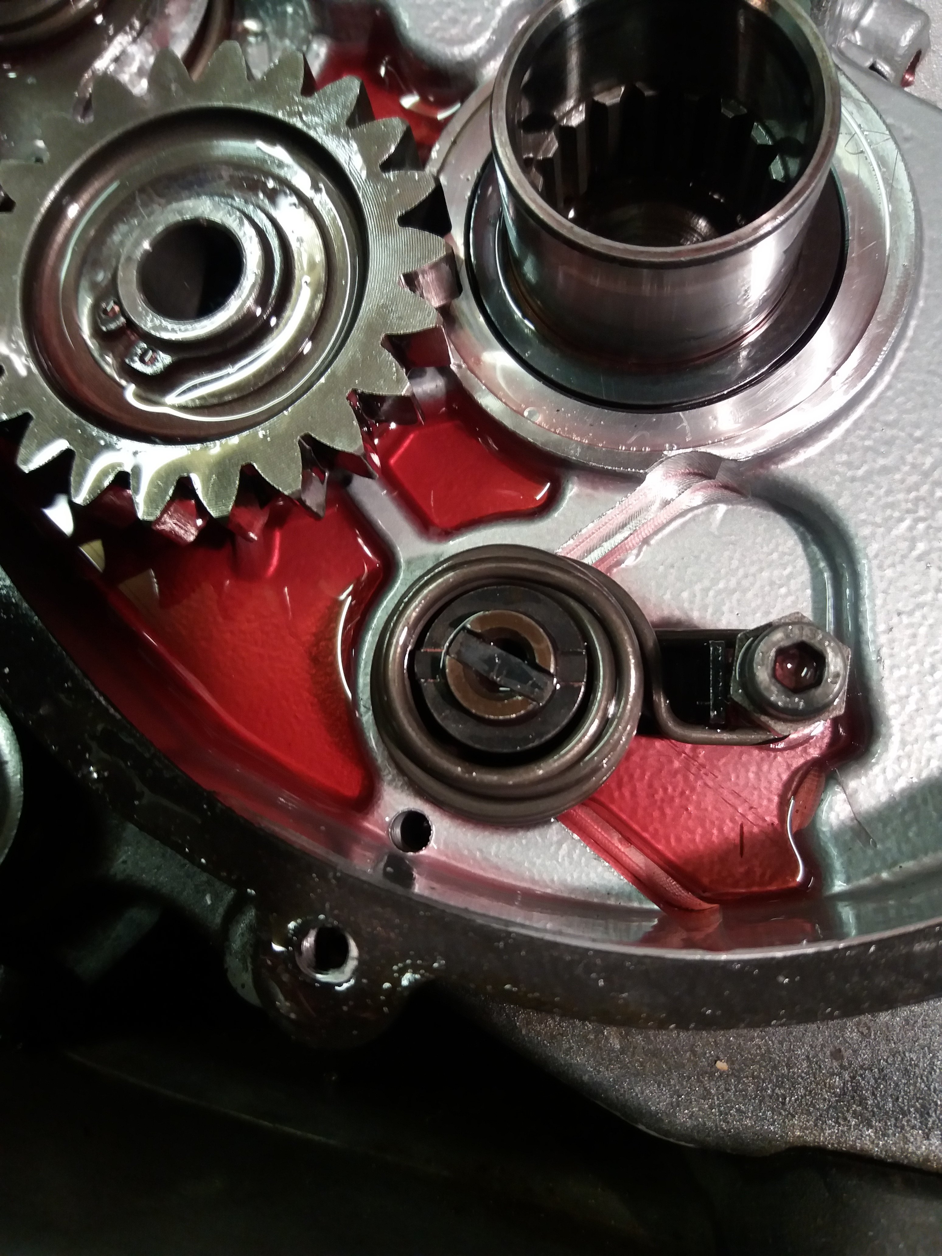

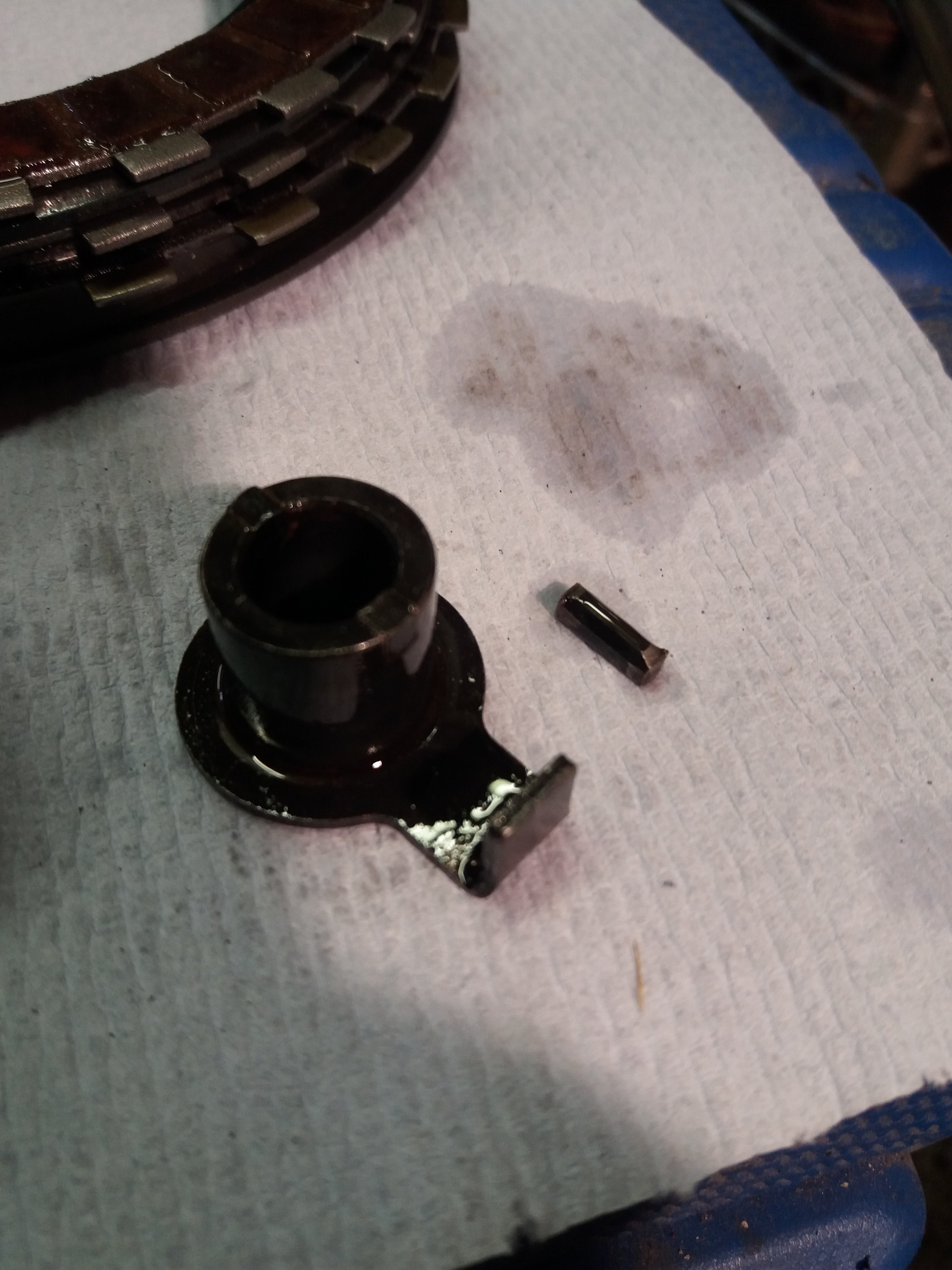

April 21, 20197 yr Author SORTED THANKS FOR THE HELP. Stripped the clutch out to get to the top hat. I had to drill the head off the M5 retaining screw which holds the basket on as this had been butchered and rounded off. I suspect someone had tried to remove the basket before, possibly on a mission to check the top hat because the previous owner told me he had difficulty getting neutral. When the top hat was revealed I could see that the little square section pin in the top had had sheared just as others had suggested it might. What a relief. It is after all a shear pin so it had done the job it was designed for. Edited April 26, 20197 yr by yellabell

April 21, 20197 yr Author Yes - ordered the top hat and spring as a unit, a new m5 hollow screw and 2x clutch basket needle roller bearings. Don't know if they needed doing but might as well for the few quid they cost. Happy days!
April 26, 20197 yr Author Here's a little clip of what the sheared square section pin looks like when trying to find a gear
