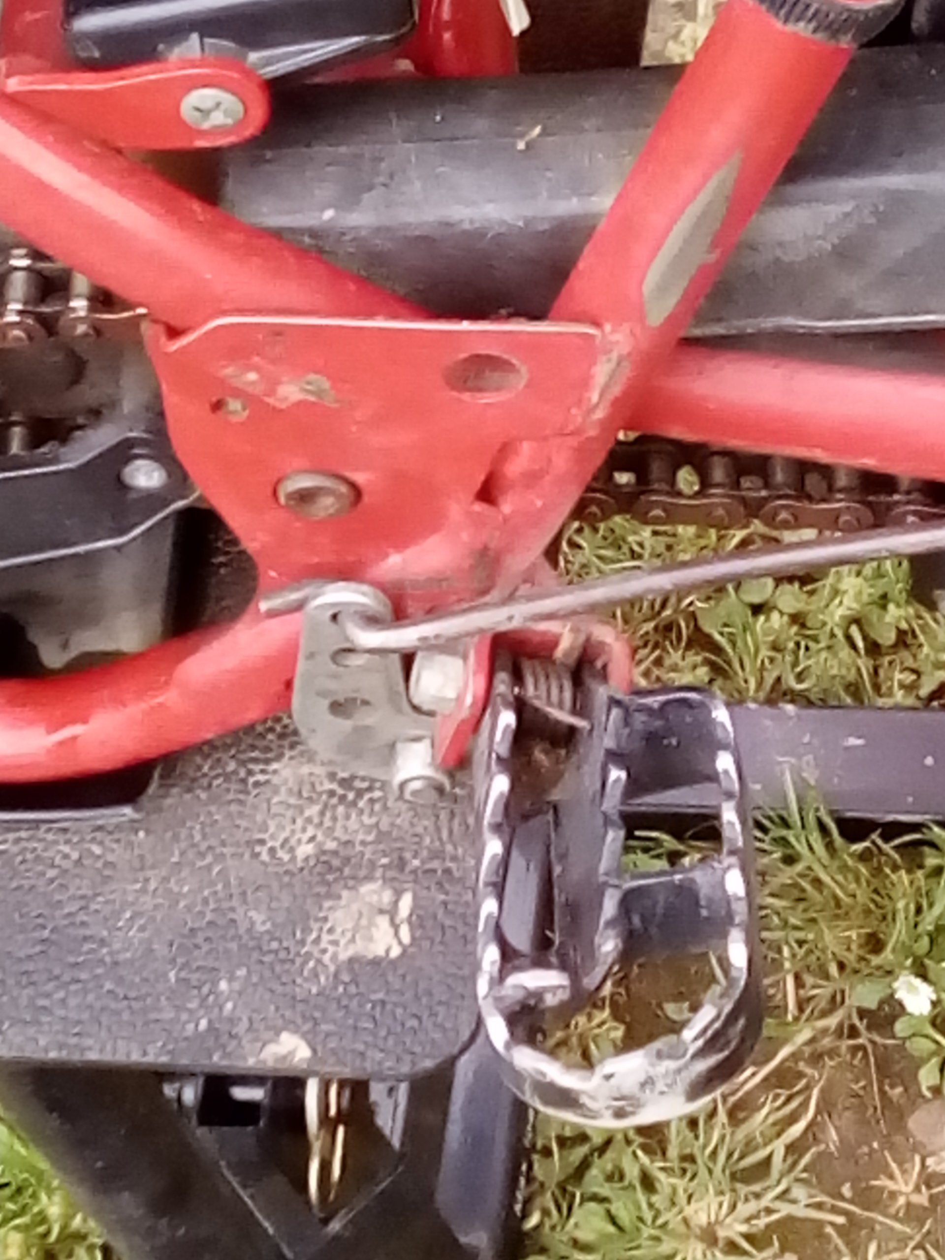

I just widened mine backwards. I didn't lower them, it was easier and doesn't catch the rocks so easily.?
They don't cut holes in your boots, and are so much more comfortable.?

That's a neat job owlit. Time hasn't been kind at the moment but when I do get a minute I may just shamefully copy yours!
Feel free? Grind off the tooth at the end of the original peg so it is the same height as the rest. I'm so glad I did mine???

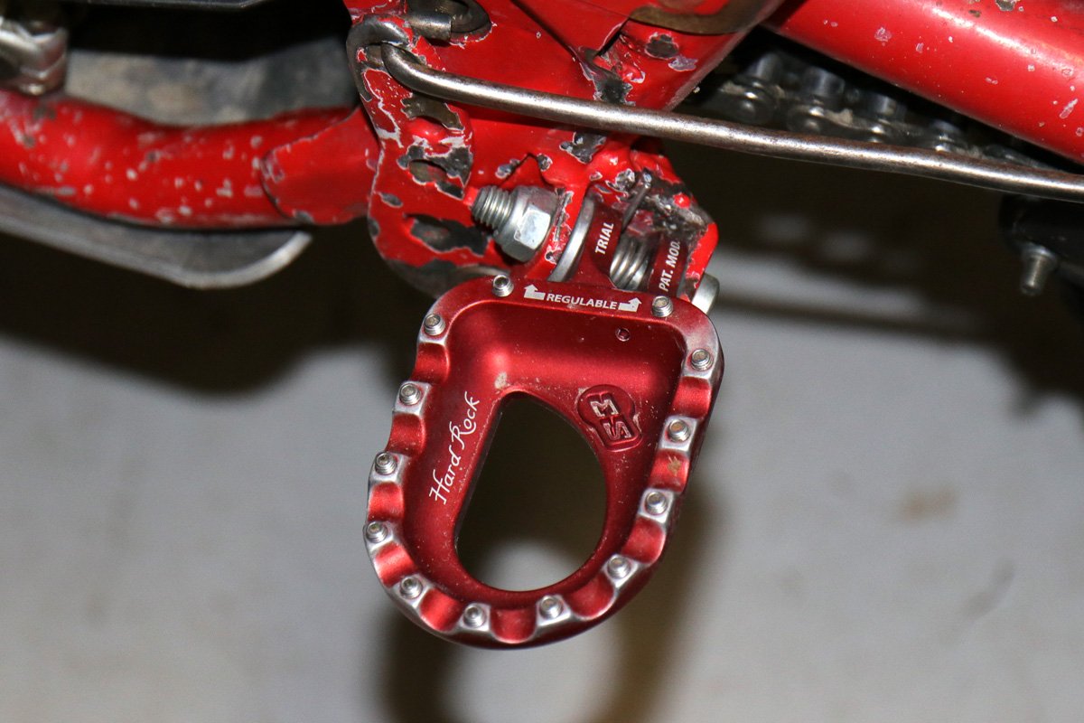

Andy,
Just seen your post and, as others have said, the standard modern foot peg does not fit in the original hanger.
The solution is the S3 hardrock pegs as these come with 2 aluminium washers which you use to move the pegs forward or back.
Use them on the original Fantic hangers but with only one of the washers. See the first photo.
Please note the Fantic hanger depth is also shorter than current modern pegs so you also have to cut (hacksaw) a bit off the inside of the peg.

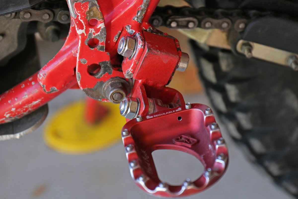

I had mine like that for a number of years, but have now made a bolt on bracket to drop the pegs, so currently using both washers. See the second photo.
