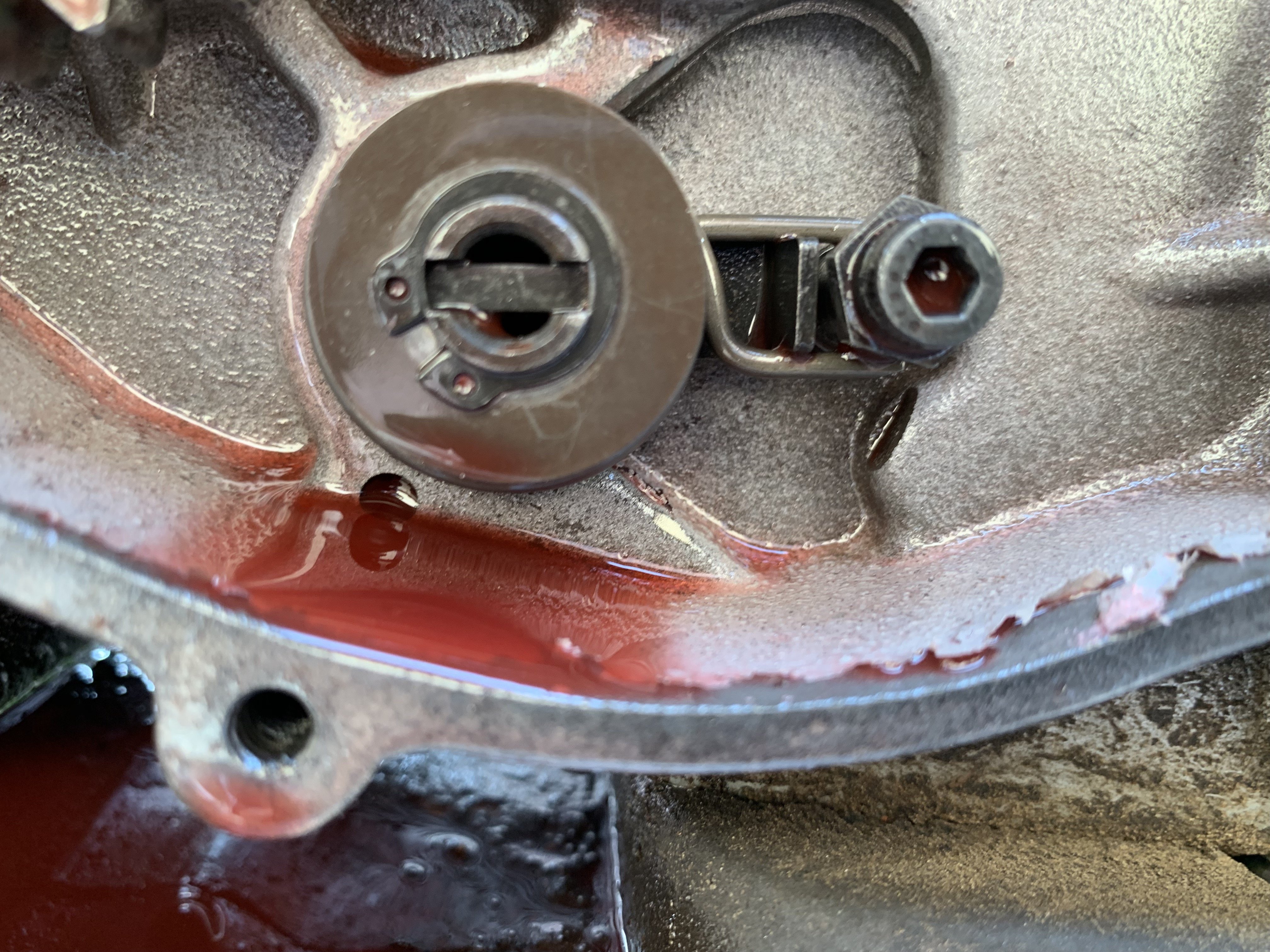

Thanks for the responses. I haven't had time to open the clutch and take a look yet. I was however today able to rock the bike back and forth and cycle through all 6 gears no problem, so I tried to go for a roop in 5th, it fell into neutral, and wouldn't shift into any gear either up or down. Had a nice run home :) I will have a look at that sacrificial cross bar tomorrow, if it's intact I'll try to set the eccentric in a better position and see if that helps.
Okay so I pulled the clutch and found that the cross bar was intact. The eccentric cam adjustment is changing the shifting capabilities, but there is no position that allows for shifting between all gears, and when I find a position that shifts between *some* gears, and it only works for a couple shifts. When I follow Jim's directions there is never a point at which I can turn the eccentric cam to produce the click. I am thinking about trying to Dremel out the casing for more range of motion as he shows in another video, but I don't really know if 'm on the right track here. It seems like the cam is not performing its function properly. I've resorted to trying random positions and hoping.
I was able to find a position where shifting was working, then I VERY carefully tightened the locking bolt into that position and shifting did not work at all. Maybe the cam is worn and not adjusting the tension properly? I do notice the springs move up and down as I turn it, not up in one direction and down in the other.

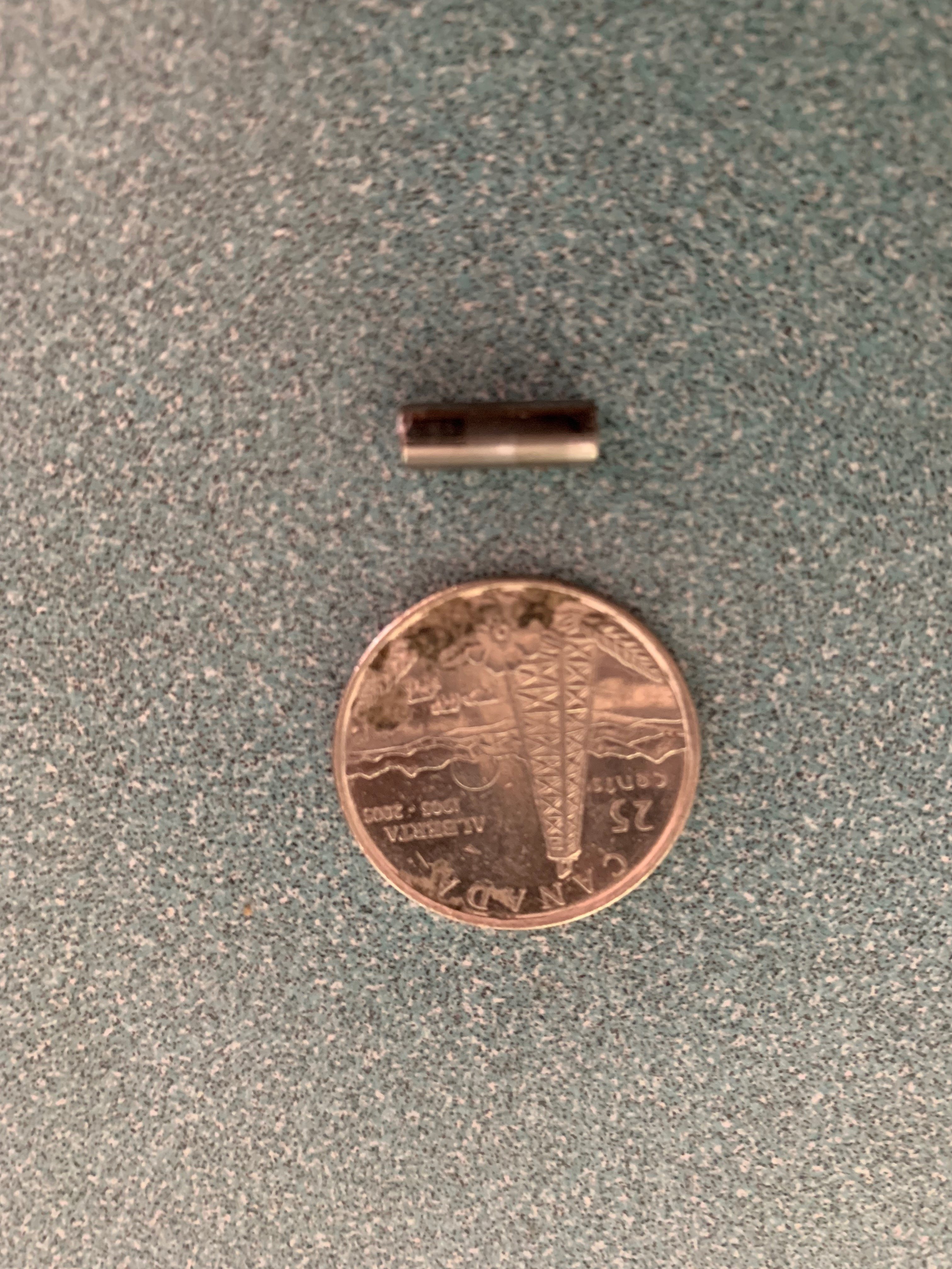

And here's something you don't want to find, it was attached to my drain plug magnet. I noticed I had to hold one of these in the hole for the water impeller when I reassembled the bike, but it was longer. I have no idea where this came from, but I sure am glad the magnet caught it!
Hmm, having a hard time uploading the image, it is a pin about 3mm diameter and 1cm long, not sheared, looks like a complete part.

Here is a pic of the crossbar (which I think looks normal?), and a pic of the pin found attached to drain plug.

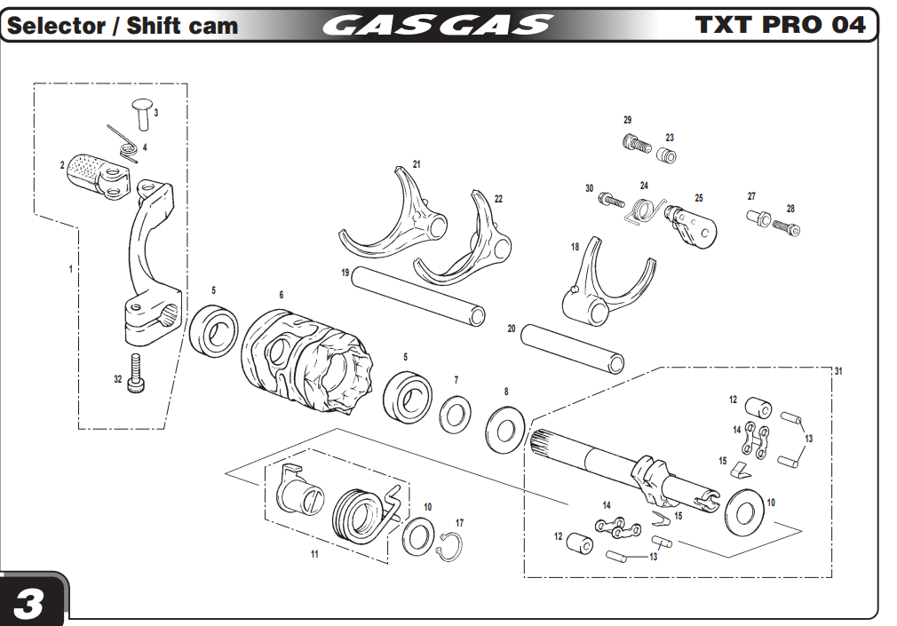

 Do not ride this any more. You will just cause more damage. Zippy is correct. You will need a new shift shaft assembly and I would replace the top hat, just because it makes assembly easier and at the worst gives you a spare.
I feel really confident you guys have nailed it here, and I'm sure that it is part #13 stuck to my drain plug.  Guess I start looking around for a GG tech, splitting the cases is where I draw the line.

Yup that's the bit on the shift shaft that breaks off that I mentioned in my post. Usually happens when the shift lever gets a good wack from a rock or something in a fall. Proper pain in the a*** job. Glad you found the problem.
