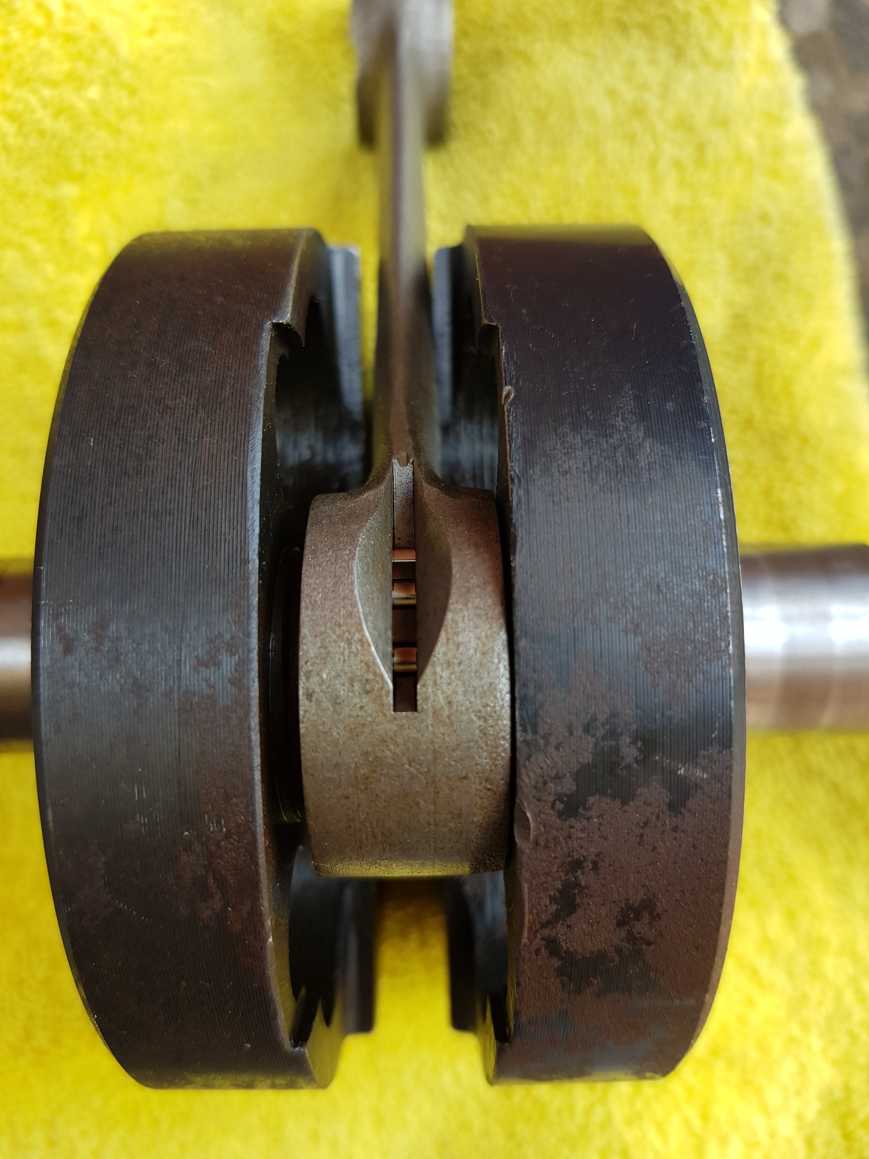

My conrod had sideways movement of over 3mm, is this normal. Clymer manual says .4 to .5 of a mm but the book does stop at 75 and i have  76 mrr. Is it spaced into position by little end ?  I did run/ride it a short distance before dismantle and it ran smooth and quiet so unsure whether it need replacing or not. Just seems very odd to have such movement but nothing seems amiss apart from this 3mm sideways movement. Has anyone any ideas at to whats amiss. Engine didnt seem to have recently if ever been apart, bore+piston in excellent condition just wear on one gear, barrel nuts were very difficult to remove giving me the impression it had not been apart. Hope someone has an answer for me. Cheers Mark
Thats normal the conrod thrust is taken up on the small end

I’d be a little concerned about the a) rust evident on the crankshaft wheels, there might be rusting on the big end crank pin b) the obvious welts on the right hand side wheel, what caused those? On the other hand if you hadn’t taken the engine apart it would probably gone on for years without any trouble what so ever....but now you know??

The rust was a little worrying but its light and there was quite a coating of oil with it, there was water in the gearbox and clutch so yes i have quite a rebuild on my hands (first montesa too) the marks on the crank make me think it has been apart but many many years ago as it truly was difficult to dismantle (the barrel studs were quite a quest - and the base gasket was an original) but theres virtually no bore wear and the piston is like new(std too) So possibly it was either rebuilt years ago or its never been apart and the marks are a mystery. Searching for fork yokes too as one is very badly corroded which takes me back to the water issue, but wheel rims/frame etc have no corrosion. Cheers Mark

It has been apart as those braying marks on the flywheel are not factory.
I would say the crank has been apart in a previous life and a copper or dead blow was not the hammer of choice.
