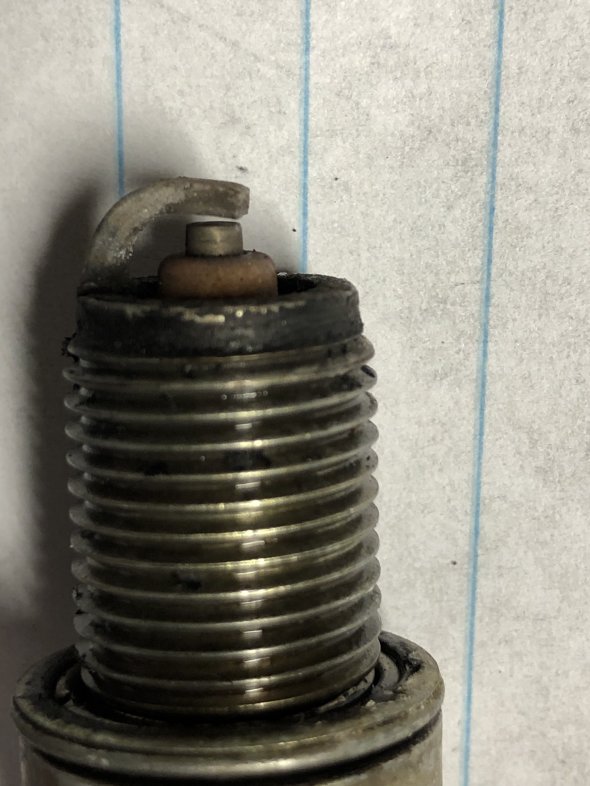

Not the best photos. The first two are of a plug with ~2 hours on it. The second two are of a plug that has been in the engine for roughy three years. Both plugs are NGK BP5ES. The bike started mis-firing when riding WFO. It would still idle, but would mis-fire under load (mainly my fat a***). Carbs are clean on all three bikes.
Are those recommended plug gaps, hard to tell but last photo "looks" way to close.
my thoughts exactly, 22 to 25 thou works well on a bultaco.
It was bouncing around in my tool pack with the spark plug socket and wrench. I set the gap to 0.020”.
The dots on the nose do look odd.
I'm not certain but those dots might be what I was talking about earlier when a change in fuel type can loosen existing carbon deposits. Also you flogging the Alpina hard may also have loosened existing carbon deposits.
Best check carb jet sizes again, those pictures look as though the plug has been extremely hot, hotter than the grade of plug used. The gap will have an influence on spark power. If you carry a plug put it in a container that will protect it from the other stuff you carry. Your petro-chemistry is questionable in that the additives might not be suitable mixed together. If that fuel worked in your M/X bike ok then it might be the fuel has gone stale past or it could be the amount of oil you are adding is lowering the octane rating too much.
