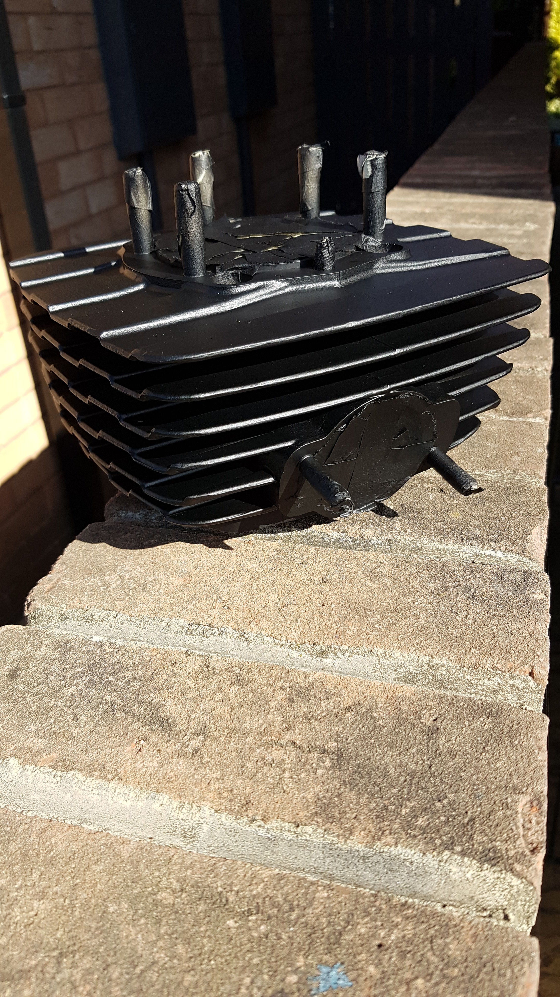

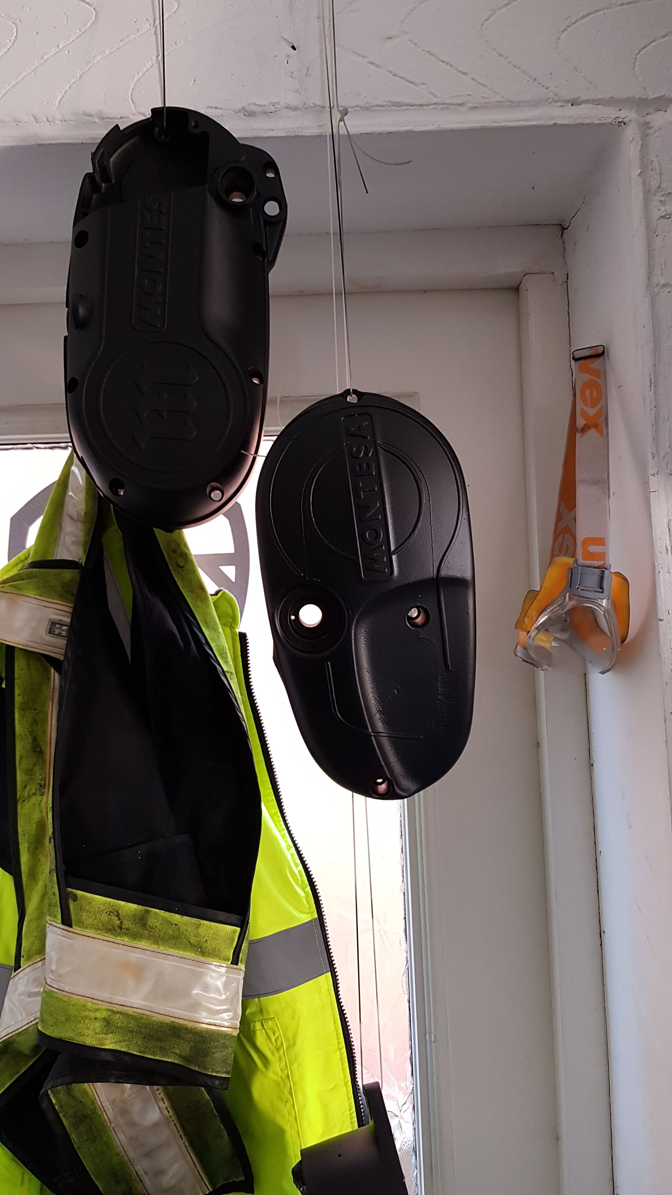

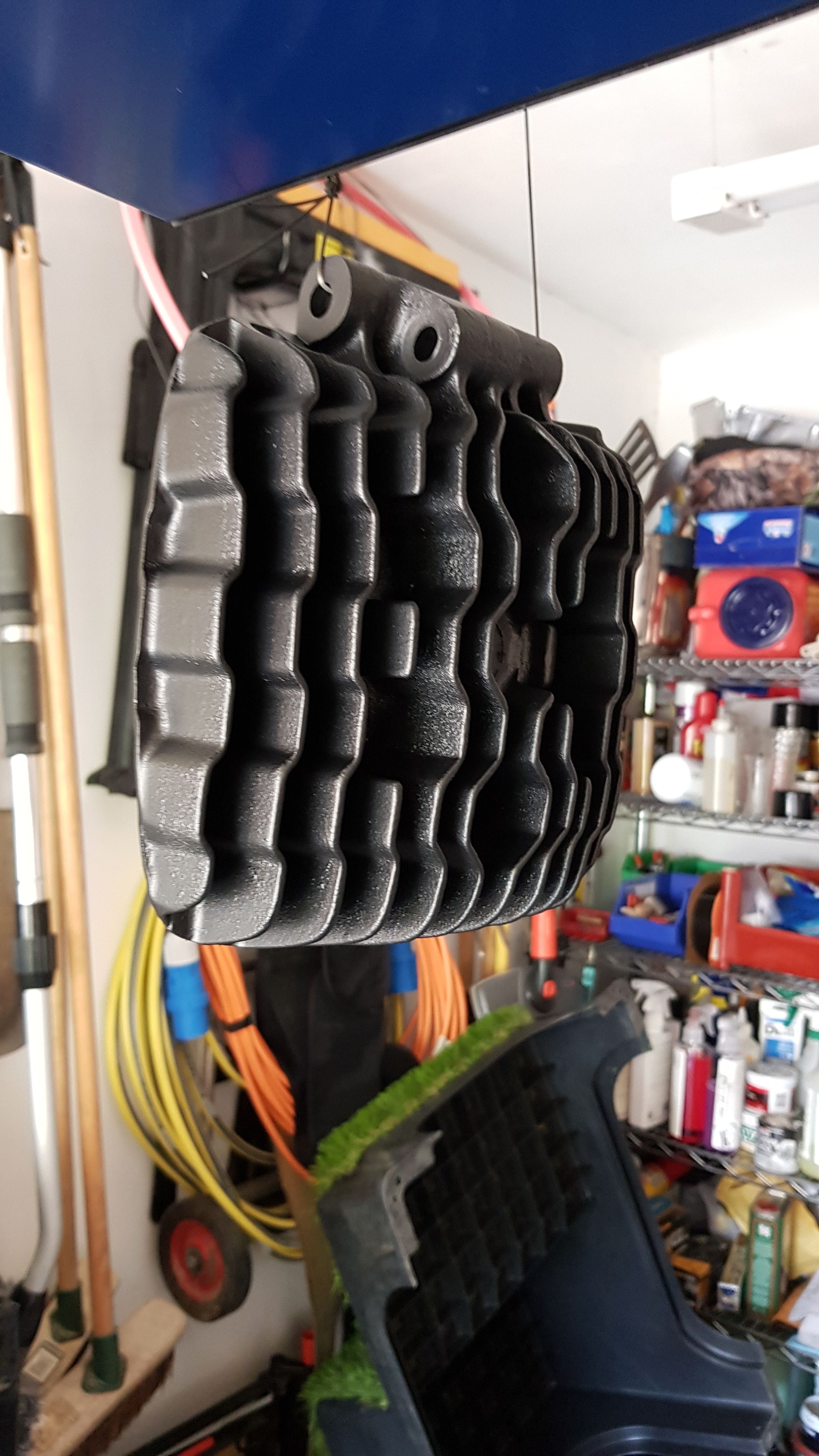

Parts back from aquablaster and now high temp painted, things are coming along
