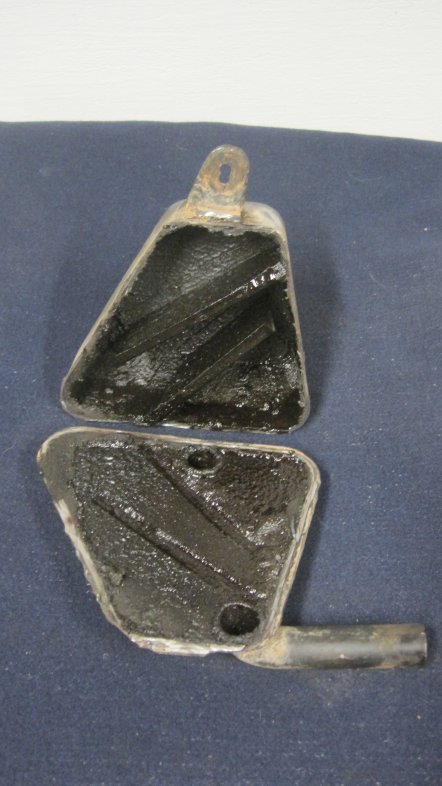

I'm presently in the midst of an early M80 Sherpa T rebuild and am striving for original appearance yet with increased performance in the effort.  I had one of these years ago and, like many, replaced the triangular muffler with an "S" pipe to a modern aftermarket spark arrestor which did perform better than stock but, to my eye, didn't look nearly as good - certainly not period correct, anyway. I eventually sold her to a friend to entice him into riding vintage trials with me and have missed the bike ever since.  Such a beautiful tank design - truly a classic.

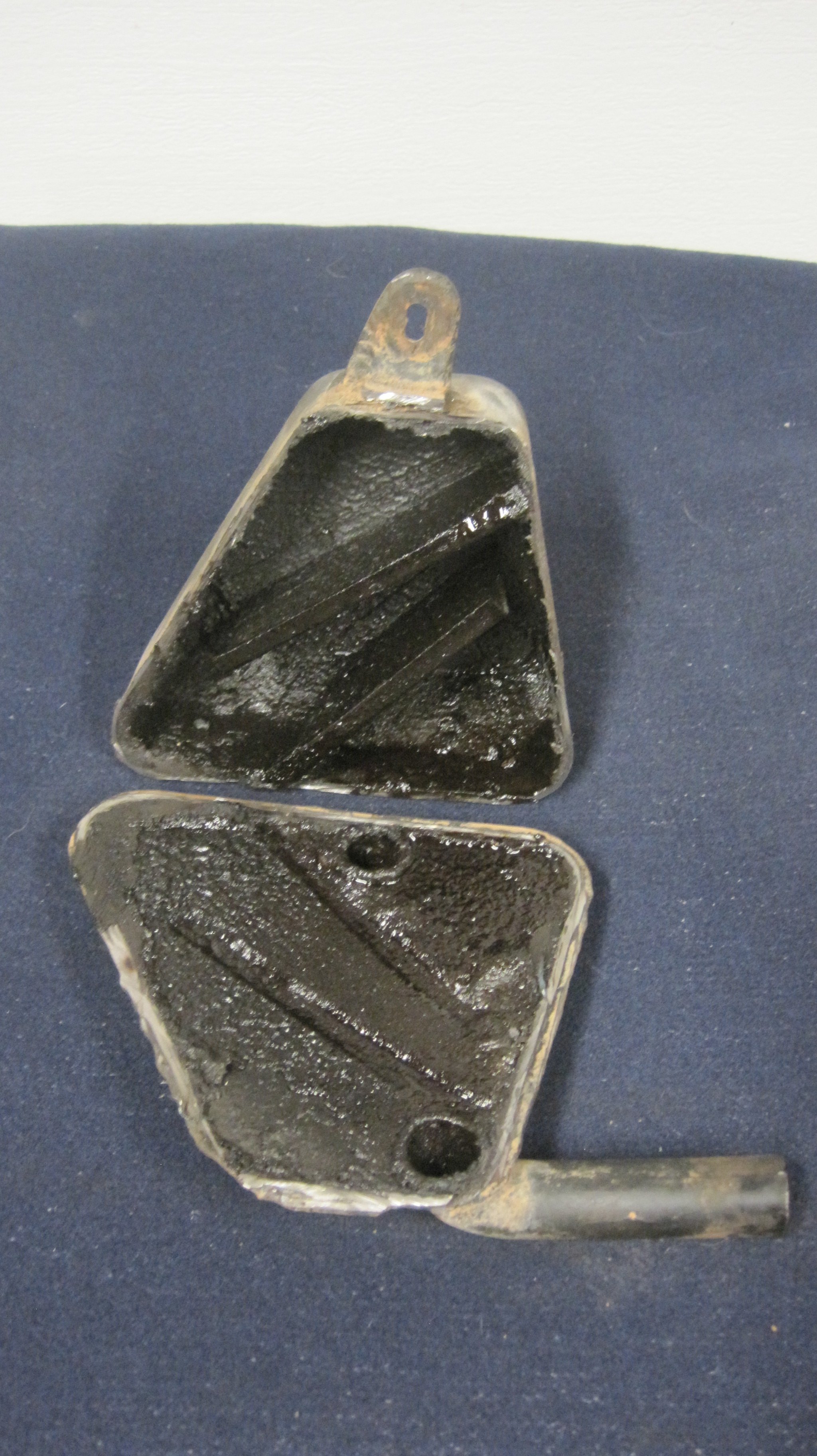

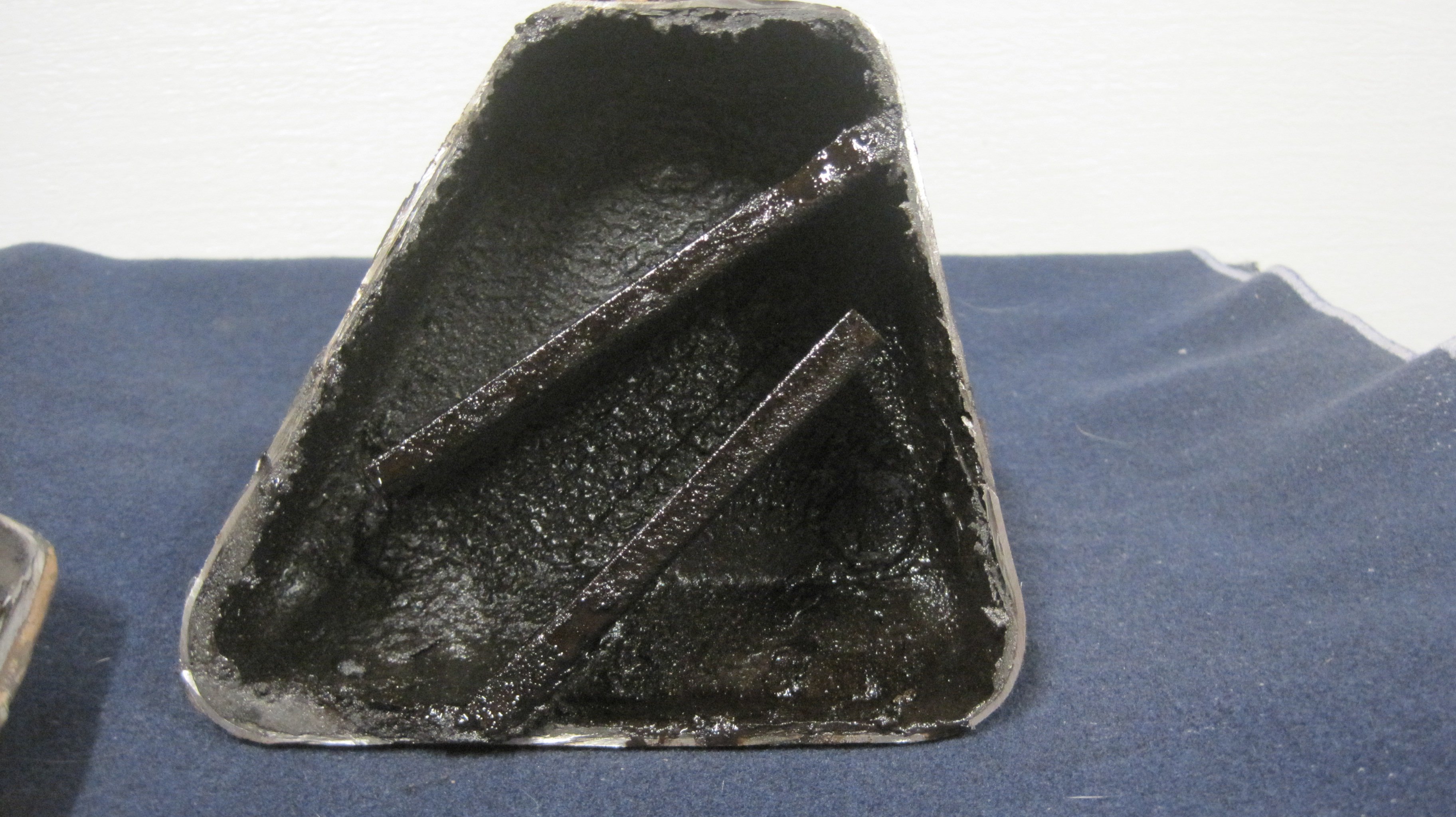

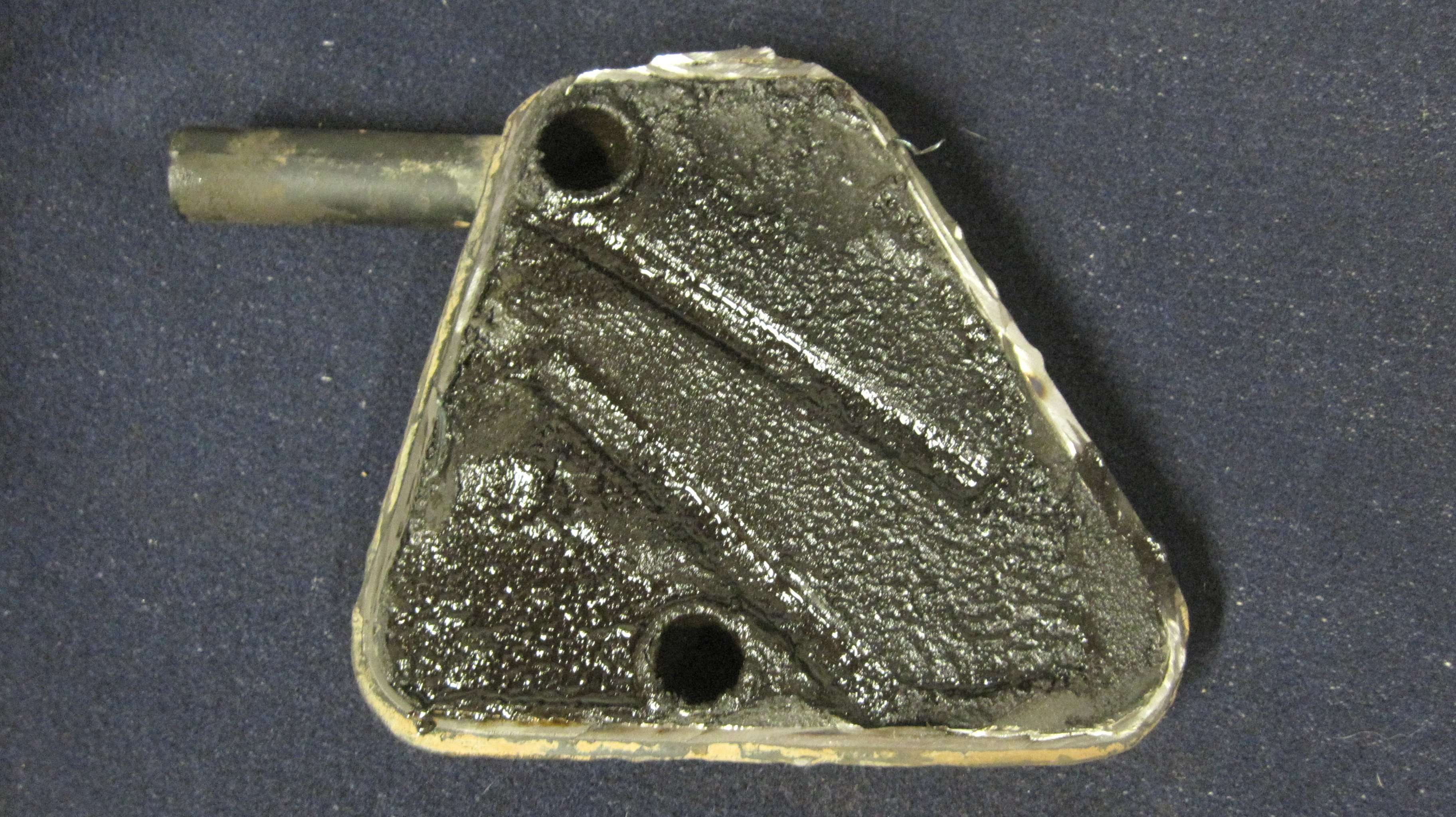

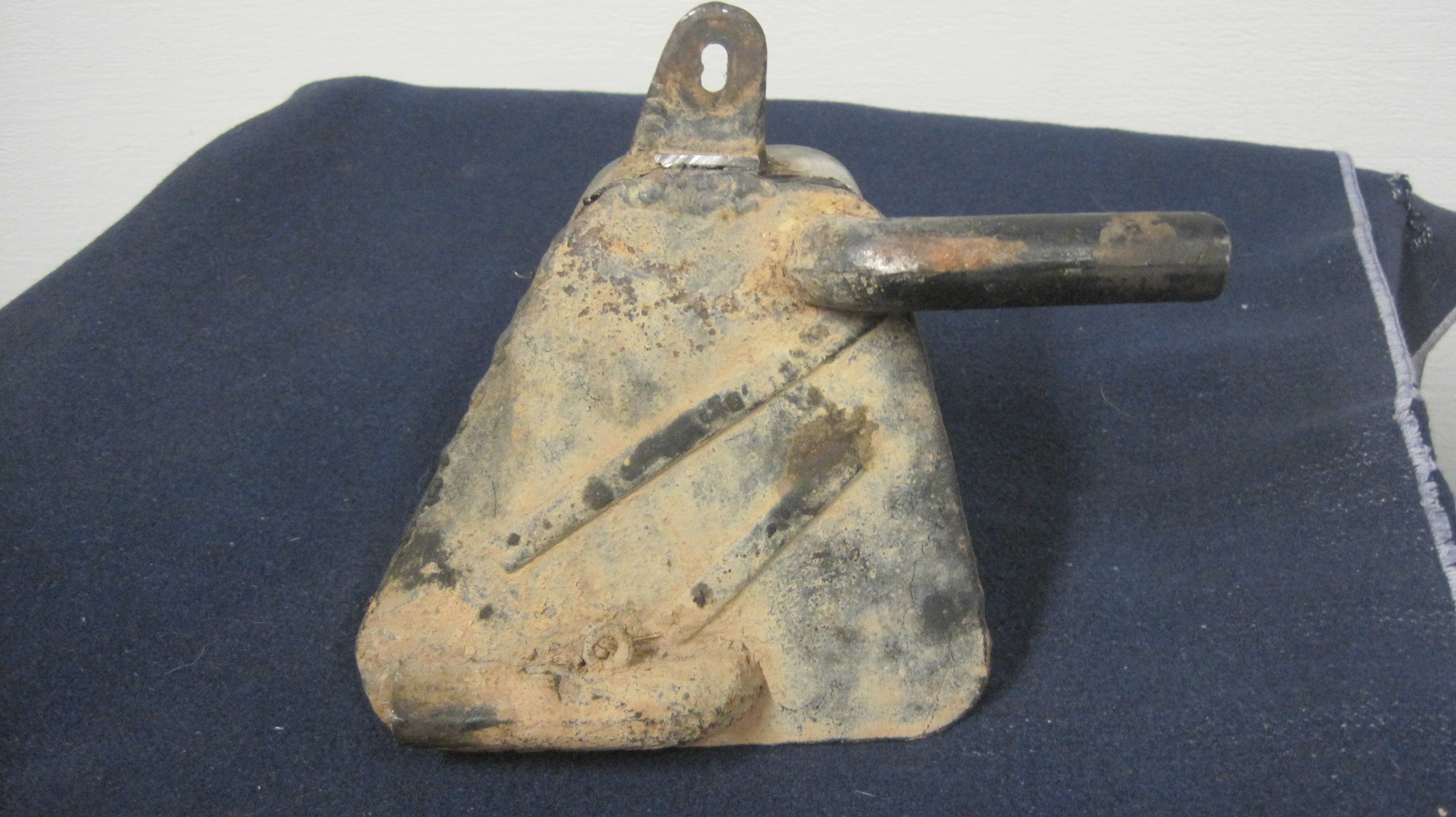

Anyway, I found another m80 - mostly in parts - but thankfully came with some extras including two triangle mufflers.  So... desiring a quieter, less restrictive muffler, I decided to open one of them up to have a look inside and modify.  Which brings me to my question...
Now knowing for sure the internal layout of this box, how would you suggest I proceed?
Remove the internal baffles and connect the inlet/outlet with a perforated tube and surround with heavy packing? What do you think of replacing the existing outlet tube with one of a larger diameter for even less restriction?  Or instead maybe adding a second outlet tube of the same diameter below the first, similarly connected?  A twin exhaust might be kind of fun.
Additionally, I may slim the unit down somewhat while I have it apart. With the internal baffles removed, there's really no need for the housing to be quite as deep.  Nothing too drastic... just enough to tuck it in a bit further.  I've already repacked the mid-box so I hope, once done, she'll flow more freely and run more quietly than the day she rolled out of the factory.
I would enhance diameter of the tube to around 25 - 30mm, then a holetube connection between them, then I would fill up with void with insulation for two stroke exhaust.
Close the box again but as such that it is easy to take apart for cleaning and replace the insulation.
Then you should have a bit better performance without more noise, much more effect would have a bigger exhaust volume in general..

PSchauber and Sherpa325 - yes, I think enlarging the inlet/outlets as well as the exit tube of the midbox itself should do the trick.  I've entirely removed the baffles (THAT was fun) and am now looking for a sensible method of connecting the two with some perforated tubing.  And yes - I LOVE the idea of making it repackable.  That would be fantastic!  I'll let you know what happens and will definitely post pictures of the finished work once it's complete. Fingers crossed it should work out quite well once done.

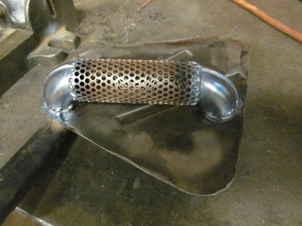

Hey all -
Just a quick update on the silencer mod.
After a thorough cleaning and the removal of all baffles, I trimmed approximately 10mm in depth from the box to slightly reduce heel or tire contact contact (depending on how it's mounted at the tab) and took it to a good friend who tied the inlet/outlets together with some perf tubing.  The challenge, he told me, was in making the very short 90 degree tubes you see connecting the perforated section.  He made a die to stamp some sheet metal (as one might when building an exhaust pipe) into 90 degree halves, then welded them together to create the new pieces. The box has since been tightly packed and welded back together.  I'll attach further photos of the completed mod soon.
Regards -
Christian

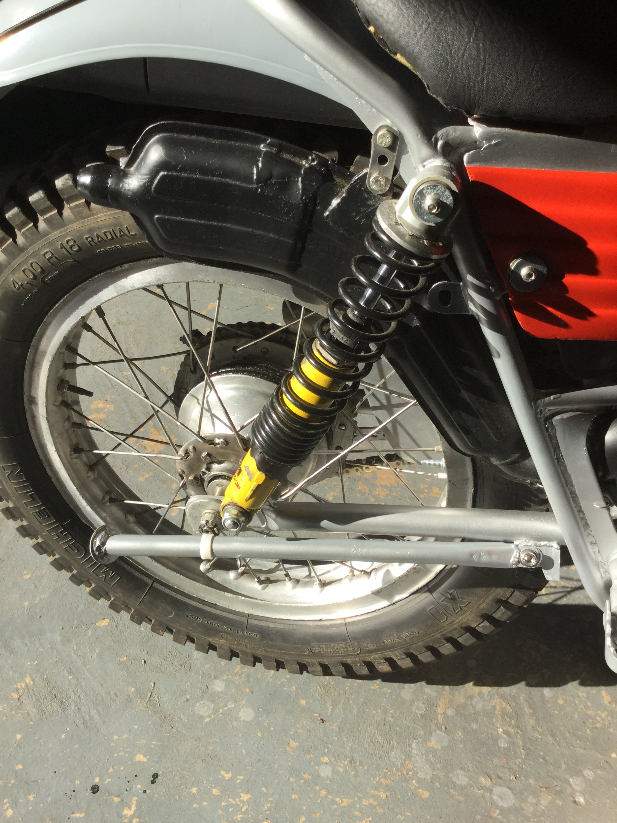

On 11/2/2019 at 3:43 PM, vintagenut said:
Hi Section -
That does look nice -  thank you for the photo!
I see you drilled the frame loop gusset as an attachment point, added an extension and moved the muffler tab to fall in line with the frame mount.  Very clean approach and easy to revert back to stock if desired.  Question... did you need to adapt at the muffler inlet (shorten or shim) to accommodate the tiny mid-box outlet?  Overall the minimal effort it would take to make it fit would be worth it if it quiets the bike without compromising performance.
Thanks again for the suggestion. If my little experiment doesn't work as hoped, I'll definitely try your approach next!
Cheers -
Christian

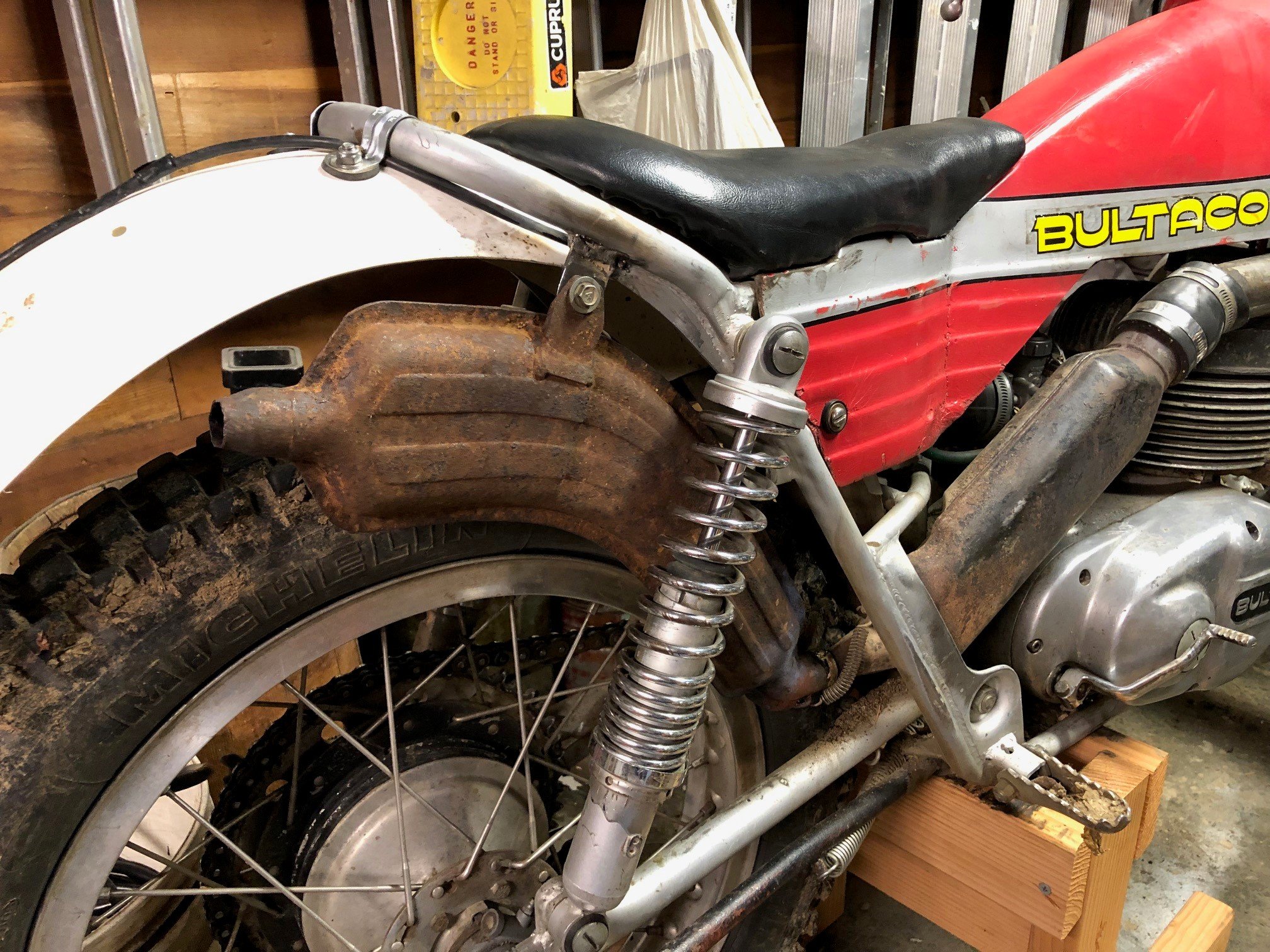

Sorry for the late response. No mods to clearance, although the suspension is close it does have clearance...about 1/8th of an inch. The drop bracket is a piece from a Scotoiler Kit?. The connection from mid to tailbox is unmodified save for a new rubber O ring seal.?

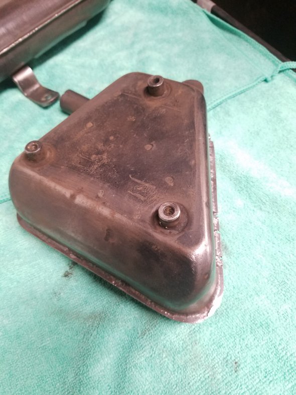

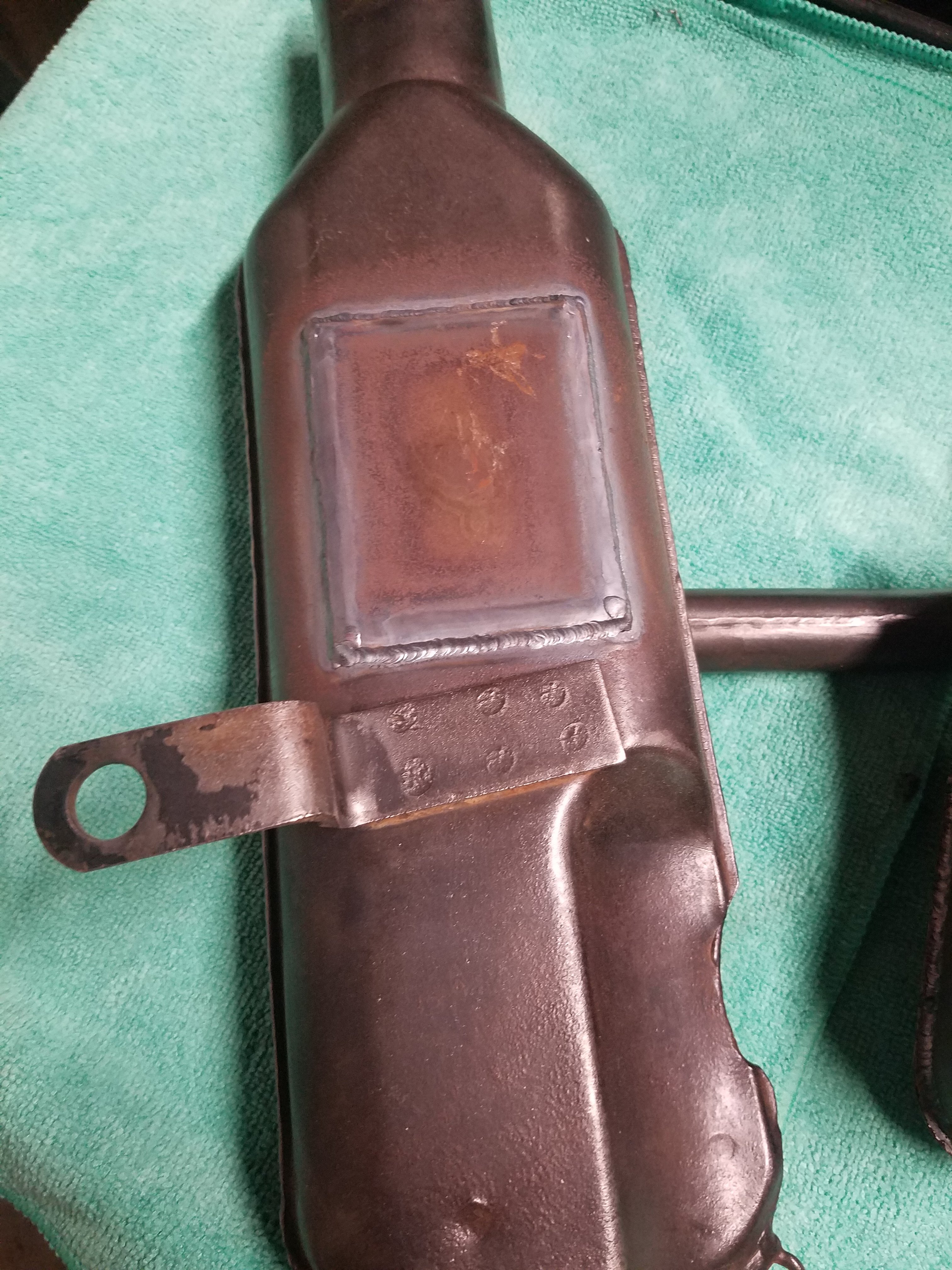

I'm attaching a couple of photos of the finished triangle muffler (minus paint and chrome shield for the moment) along with a couple pics of other efforts on this project.  She's a little skinnier in depth than before (by 10mm) but otherwise nicely packed and ready for finishing.
The shot of the muffler is a re-pack approach my friend suggested we try just for simplicity. As this will be as much a rider as a "restoration", I agreed. So he cut a port to stuff the packing through (and he packed a lot!) rather than a complete separation of the two halves.  I'm still some ways away from testing this but will let you know how well (or poorly) this attempt works when I do.  BTW... clean those exhaust parts really well before welding. It'll make all the difference when you try putting everything back together.  We tried some welding on an a damabed m49 mid box that was destined for landfill and burned a couple of holes right into it when we attempted repair.  Lesson learned...

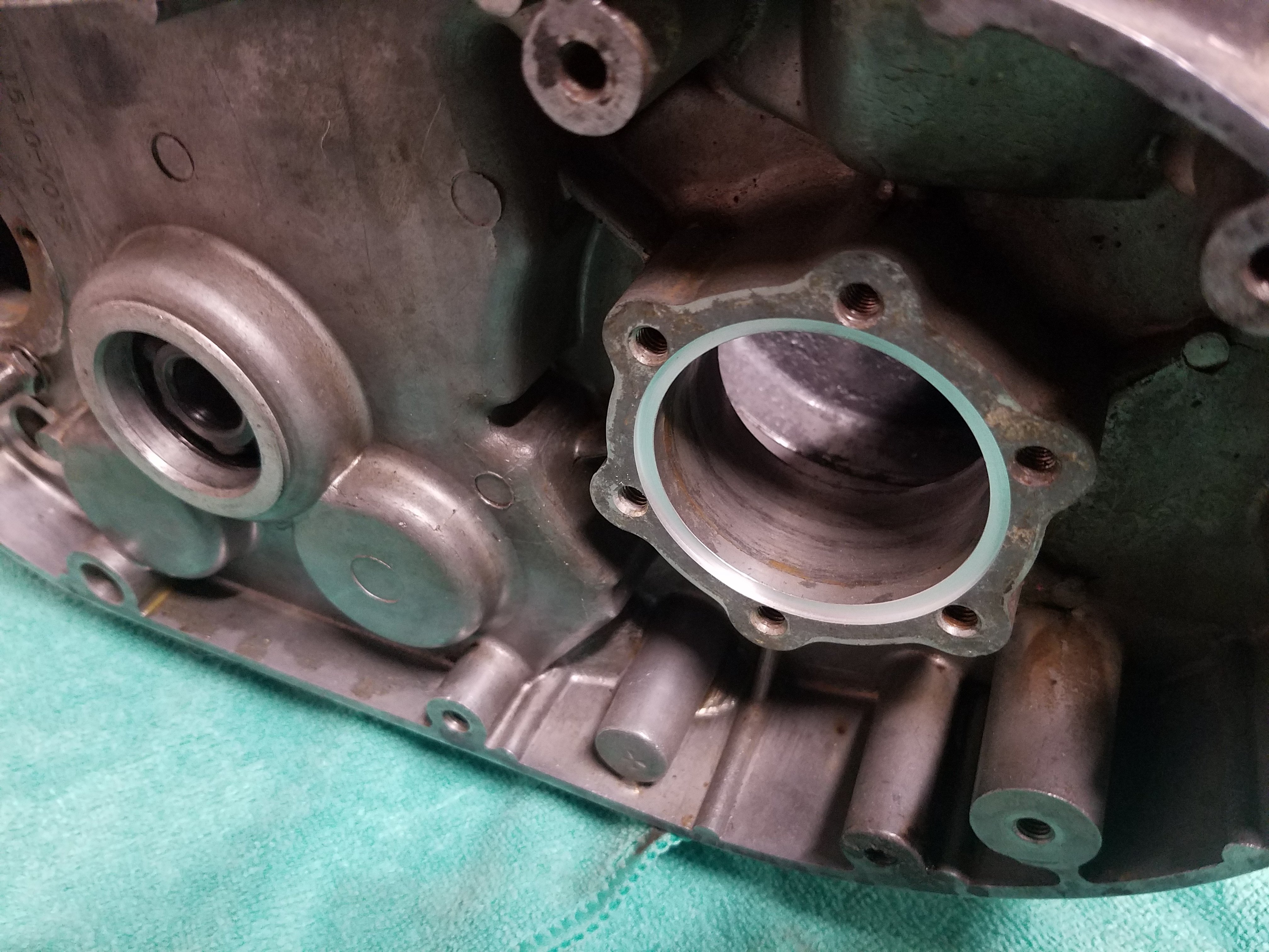

As to the pics of my cases... as my m80 is an earlier model and uses the single seal main seal holders, I thought I'd try an upgrade to the later, deeper holders that accommodate a pair of seals per side... and had my friend add some o-ring grooves for added sealing.  Overkill, I know... but I thought I might as well try while it still in a million pieces than regret not doing so once assembled.  Hindsight kinda sucks that way...
