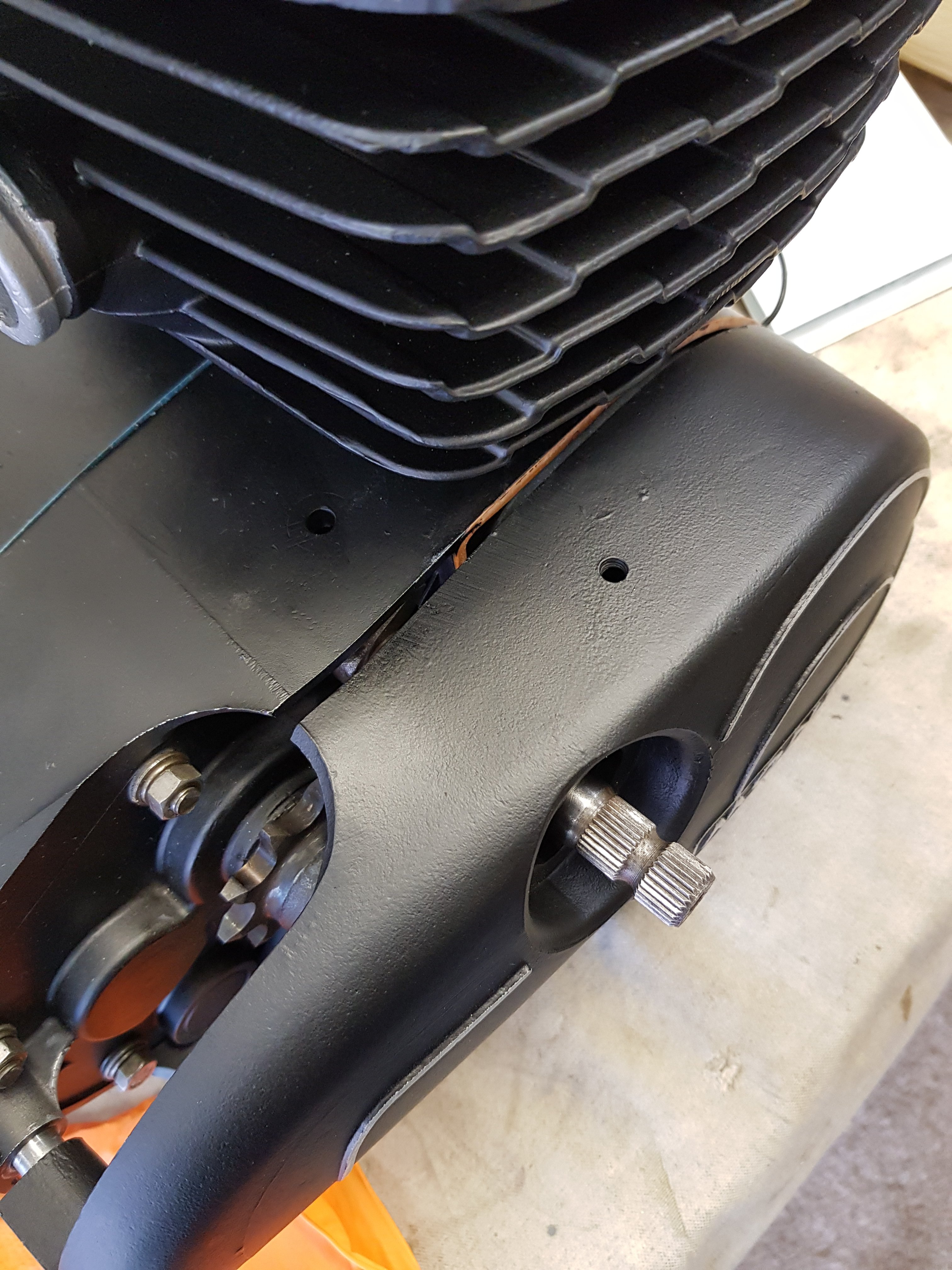

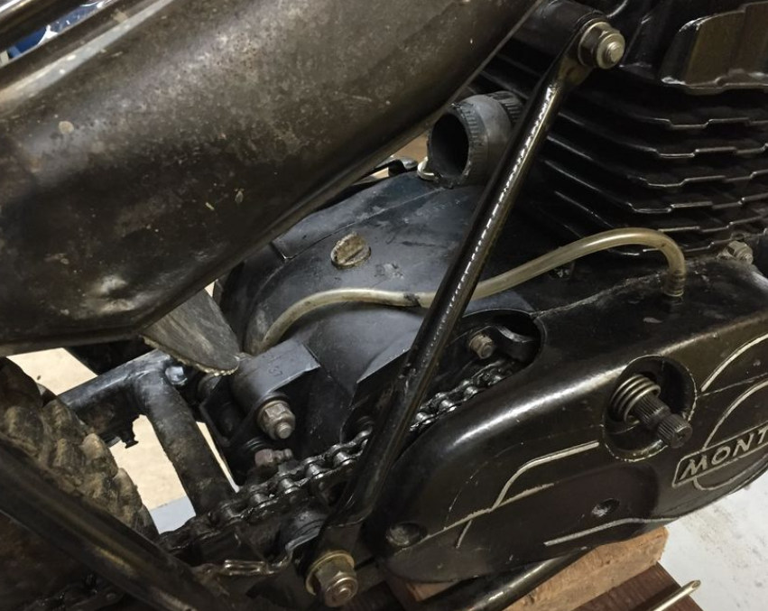

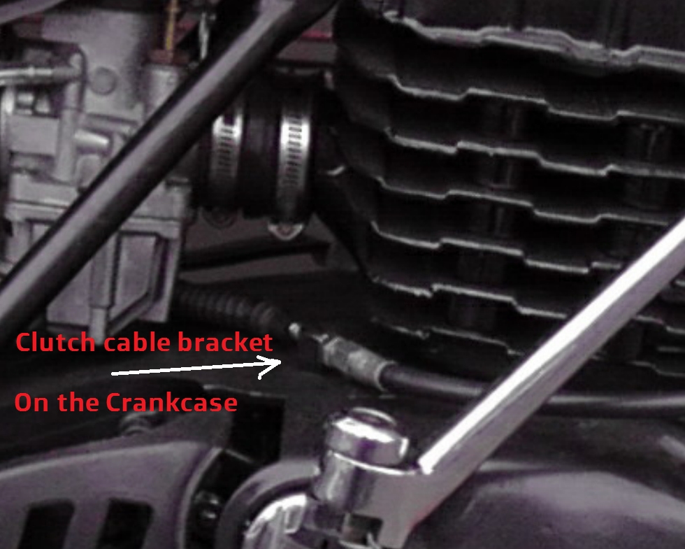

Can anyone tell me which way around the two cluch cable fitting go, i cant find the cable at the minute to check, and before i bolt the case on they need fitting. Cheers Mark
Spoiler
Thankyou ? i forgot about the breather doh!!

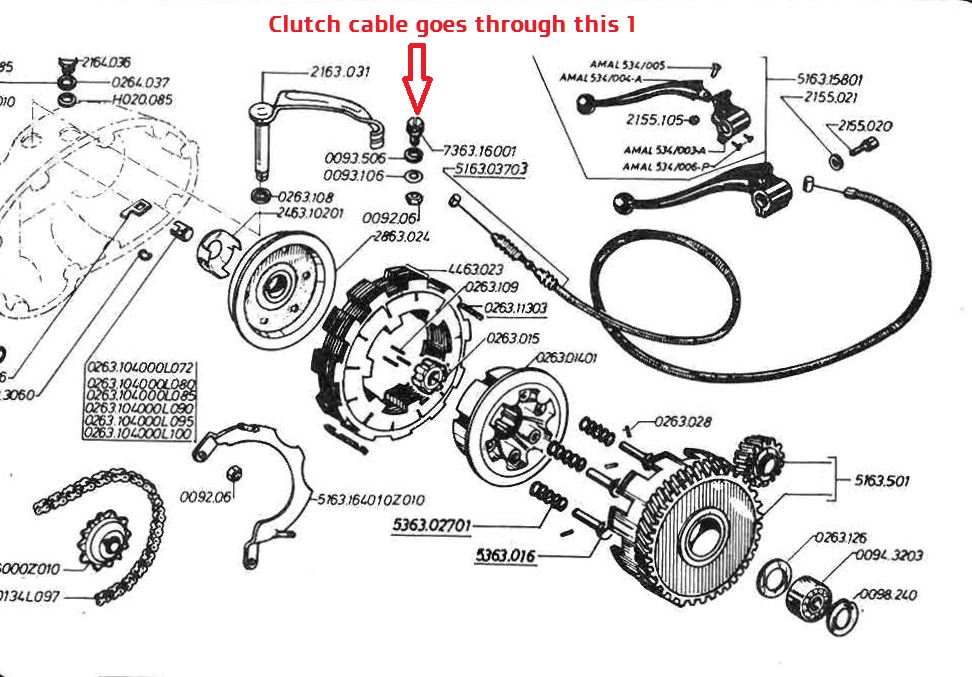

Yes they are made in different lengths
Ive just put a new one in from "in motion" and its longer than the old one ?
If you have a look at the 2nd post by Bilko showing the parts diagram, you can see the six variations offered by Montesa at the time, the last three digits of the part number are the dimensions. IE: 7.2mm through to 10mm.
The InMotion jobs are 10mm.
