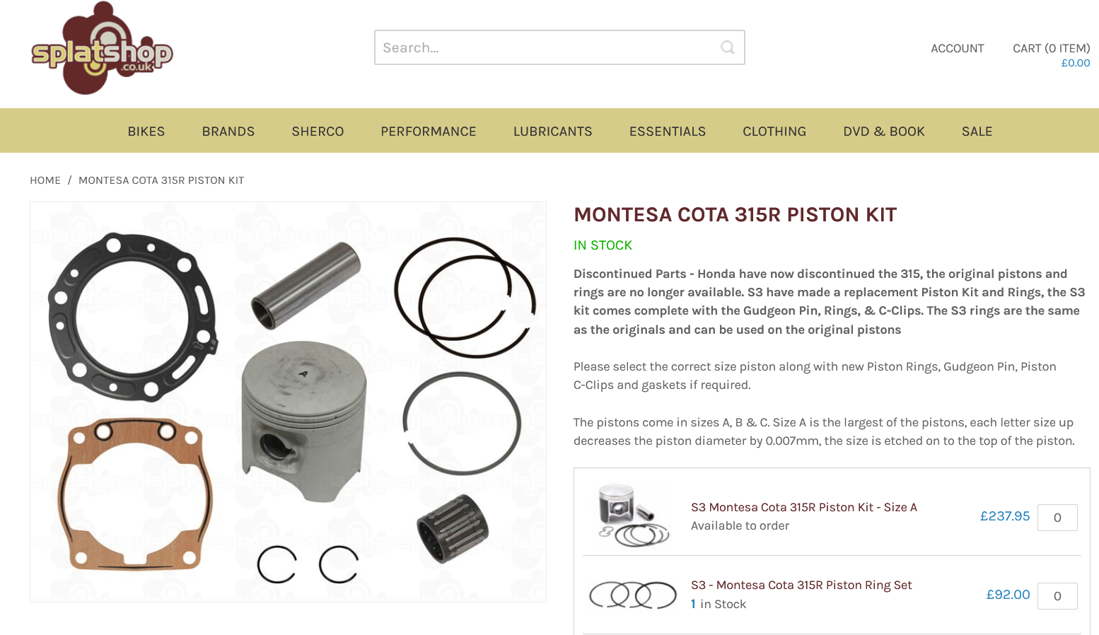

Just a bit of Piston slap,nothing to worry about. Enjoy it.But if you do go down route of replacement..
Edited by Bilko
hey , if it is only the piston and not the crankshaft bearings,  I am reassured   me who can’t find the segments in france it's perfect.   Thank you ,  both
