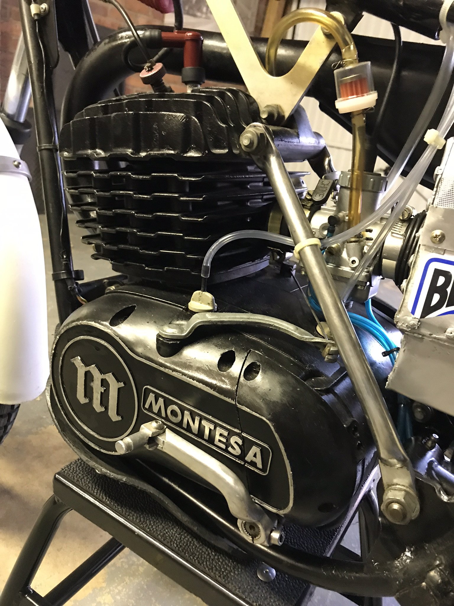

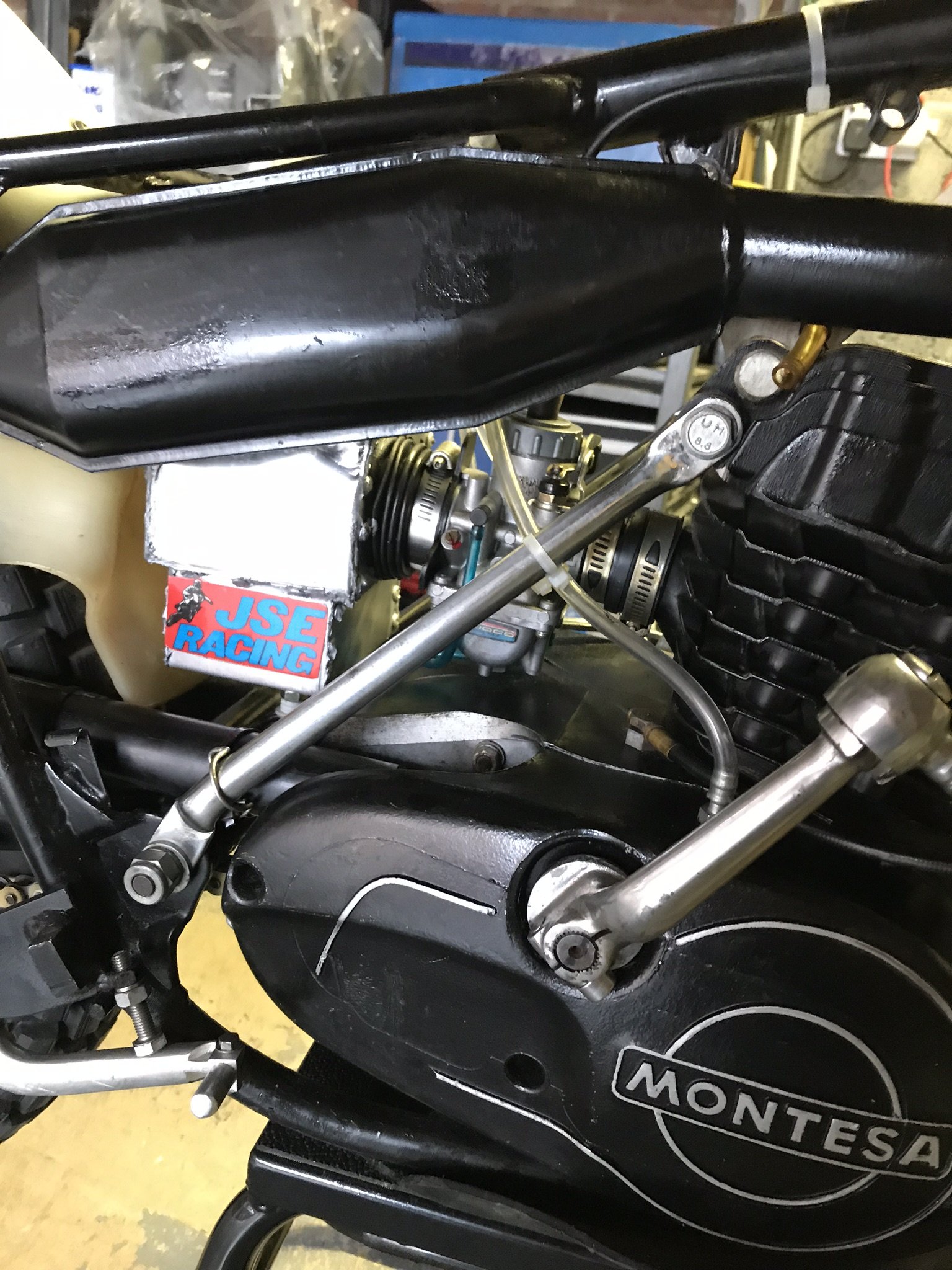

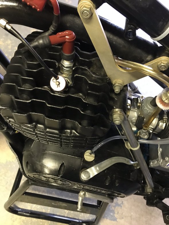

Thanks guys , by turning the filler plugs into breathers do you mean drilling a small hole in them.
Ah right I can see now , on my phone reading the replies, on my tablet now , good idea on the breathers , will do thanks again guys
Yes you can drill a small hole centrally into the filler plug. I then inserted a plastic tube with superglue. Measure the plastic tube for drill size, try for a really snug fit. Then attach a clear plastic tube and run this to where ever you think fit, my breathers are routed up to the top frame tube and are then held inside the open end of the top frame tube with cable ties.
