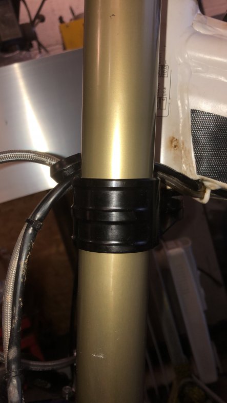

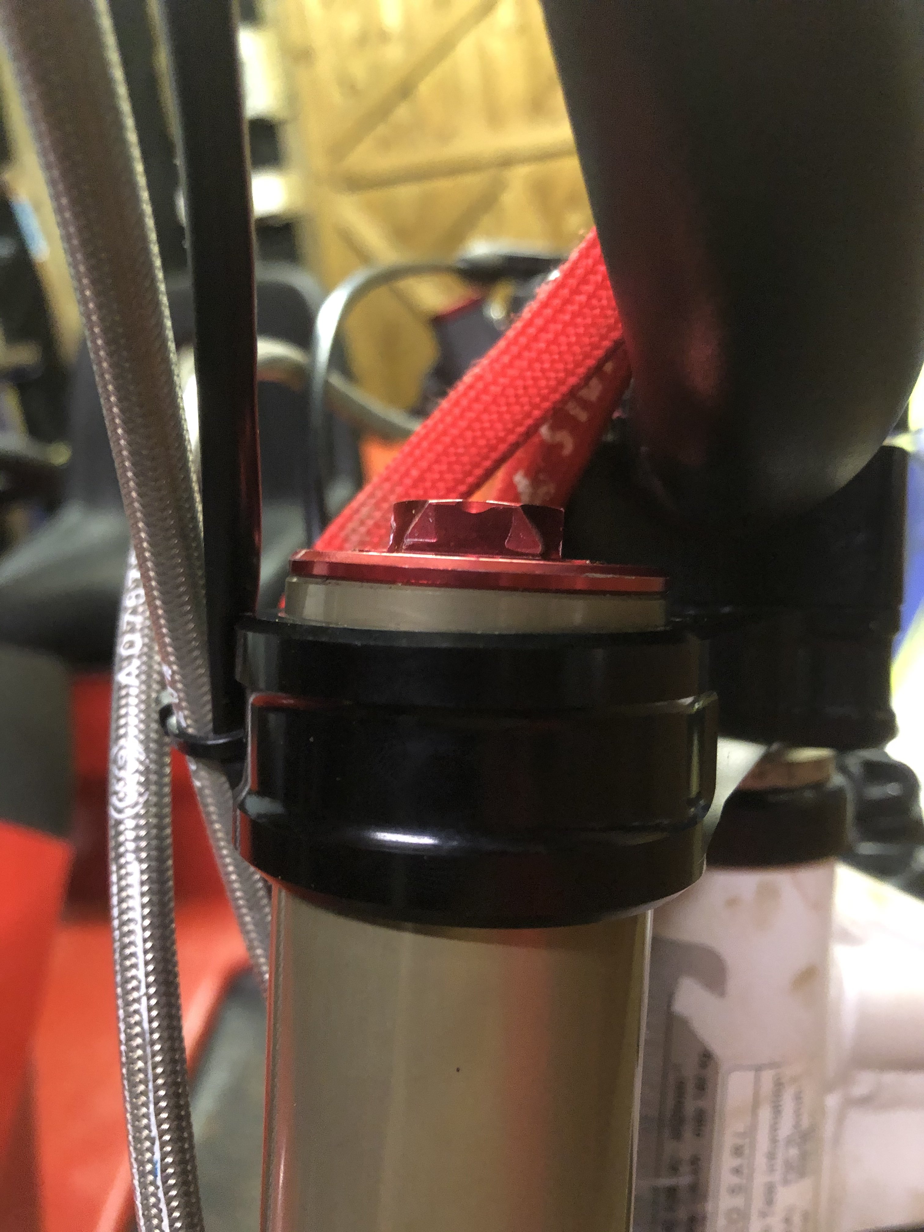

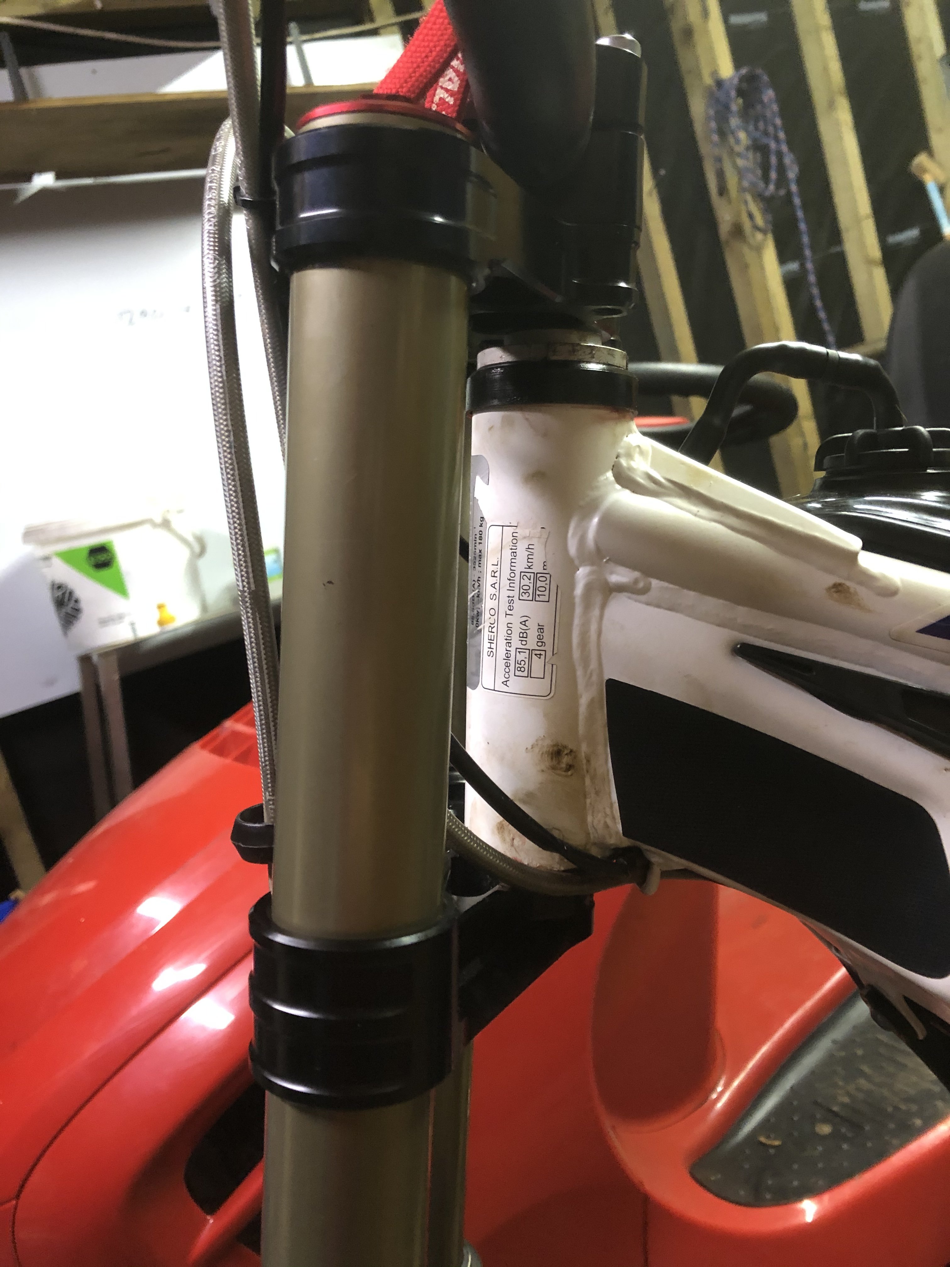

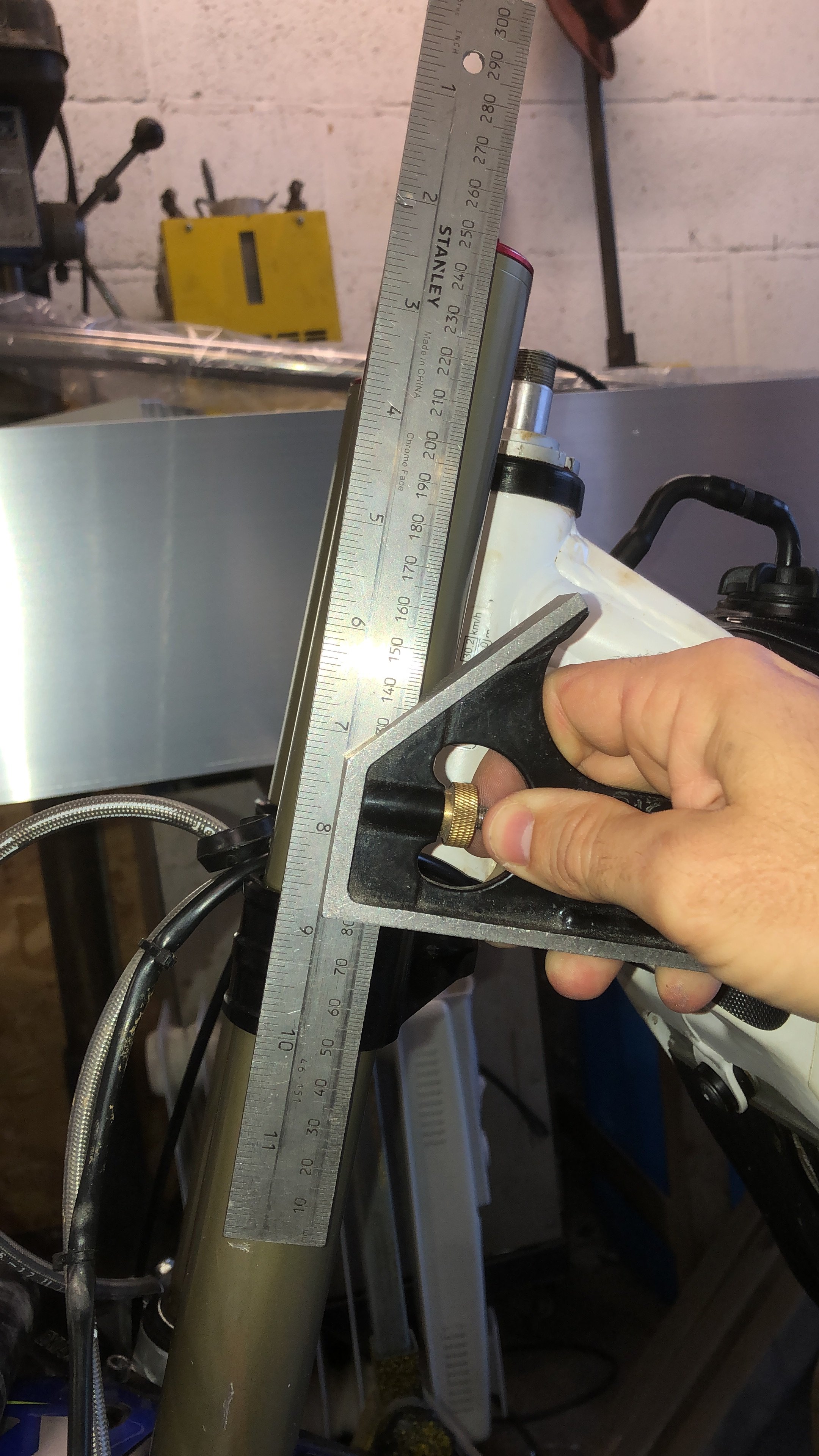

Hello, I’m new this this site so hope this is in the correct topic. I have a 19 factory Sherco st 250. Being a year old I thought I would change the head race bearings. After installation I have a strange issue with the yolks looking on the p***. Also when you eye the Stanton through the head tube it looks to not be parallel. See pics. Cheers

I would suggest that the fork mounting bore on the top and bottom yokes has not been machined square and true to the outside profile?... if the outside profile had been machined square to the bored but not to the centre spindle hole then you wouldn’t have been able to slide the fork stantion through both the bottom and top yoke. It does look a bit strange though ?

You're going to need to find another Sherco to find out if you're at all unsure of your work. I would think that if things were really screwed up though, you'd have never gotten the forks back into the triple clamp. If there was anything other than normal resistance when you put them back in, I'd be worried.
Did you actually replace the races and the lower press fit bearing?

I’m assuming you didn’t need to prise open the stantion clamps on the yokes to slide the forks through both top and bottom yokes?... if you did then the head bearings aren’t set fully in the head stock

It might be that sherco have machined the fork mounting bores mot parallel to the steering spindle to open up the steering angle a bit?
I did think this as the stantions slide up with ease.
