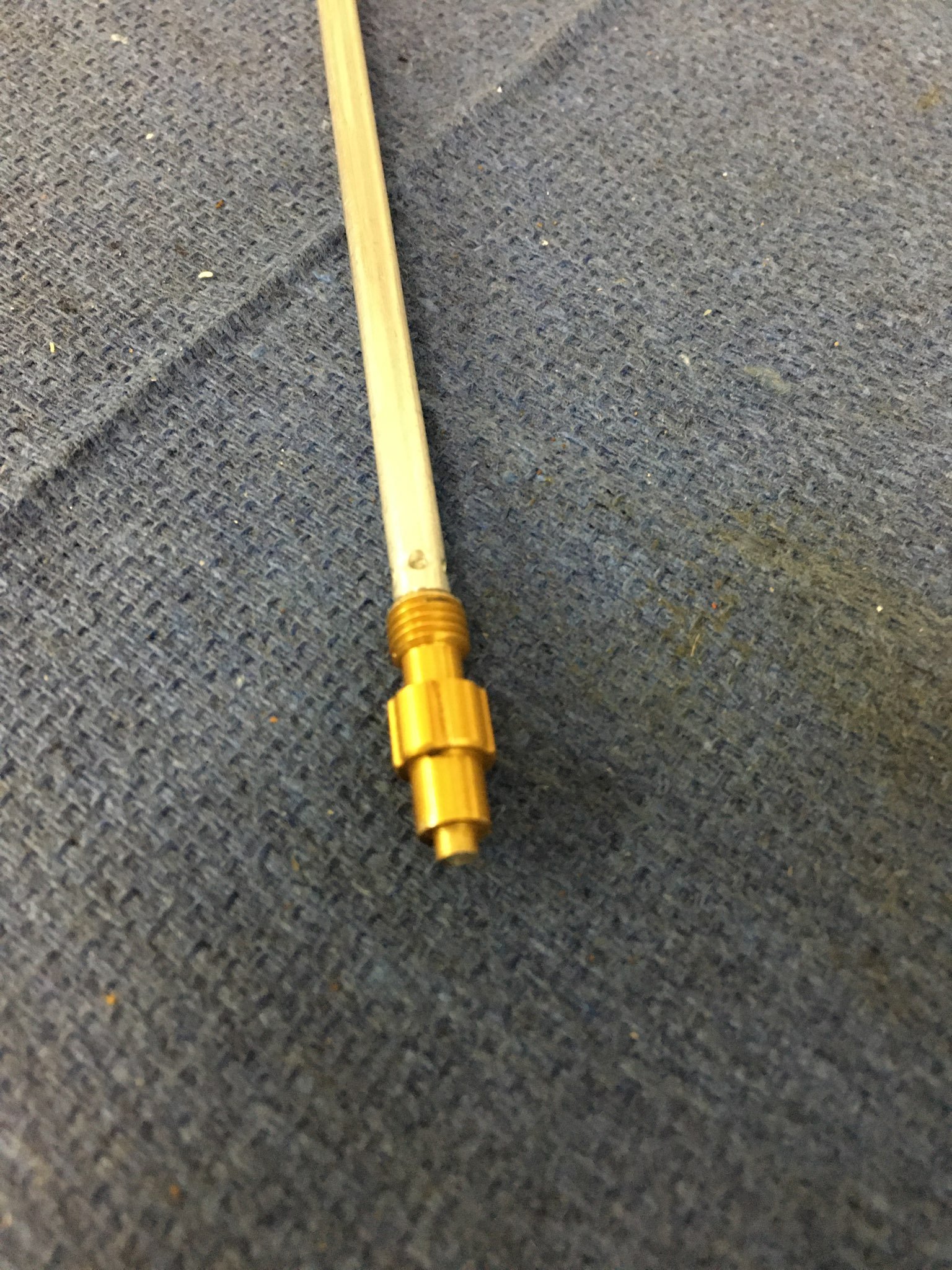

Compression damping rod 2012 GG
I've got a friend who does suspensions here in the states and took on the rebuild of a set of 40mm Marzocci's off a 2012 txt pro.  Somehow he managed to snap off the flat blade screwdriver end of the aluminum insert at the end of the compression damping rod.   He was unable to find a replacement here in the States and asked me about it as I ride trials.  Last time I called Marzocci USA about parts for my 2014 GG enduro they were of no help and soon to discontinue supplying forks and parts for dirtbikes.  Anyone out there have a good source for replacing that damping rod?
Thanks in advance.

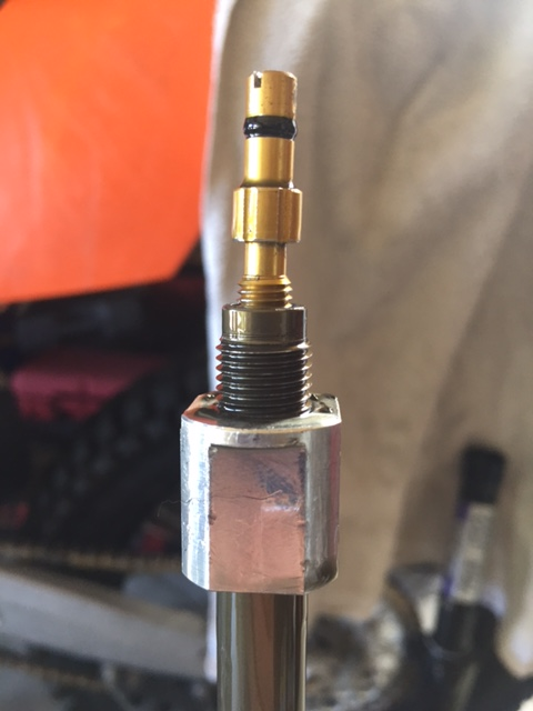

Would hacksawing a screwdriver slot in what's left work?
There's an oring and orifice in the 1/4" long section that is missing in the pic, I don't think you can just re-slot that end.

One other idea, try calling Jim Snell. He had a spare dampening rod he sold me for cheap after I stupidly leaned the fork on it's side (doing an fork oil change) and the brass piece was resting against a box. It was a little bent so I decided to replace it.
Good suggestion, Mark.  Do you still have the brass piece as that is what he needs, may be able straighten it.  Did and interweb search and found this pic...from you from ADVrider when you did your 2010 a couple of year ago.  Small damn world aint it?

Looking at what it should look like,my idea wouldn't work,you need the o ring.Shame,it would have been an easy fix
That was my first thought too, Huski.  The guy is reaching out to Jim I think, if anyone is in the know about this it would be him.
Let me check around my garage and see. Might still have it somewhere.....
