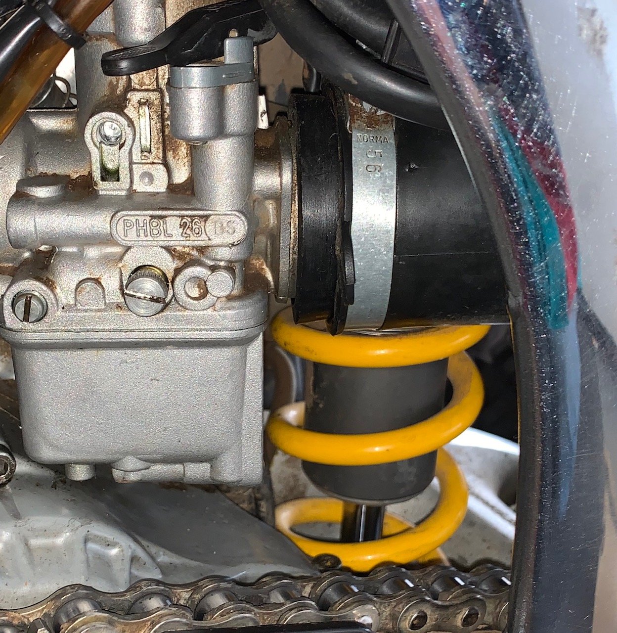

I do have another question.  Putting the airbox back on I can't seem to slide it all the way on the carb, and I can't recall what it looked like prior to removing it.  does this look right? it's like it's not long enough to slide all the way on.  Any tips?

As for the shortened air box boot; yes, it can be an issue, but the solution is relatively simple to realize.
Loosen all the band clamps and position the carburetor out of the way. Then use a heat source (like a heat gun or a hair drier) to heat the air box boot until it becomes  soft and pliable. Heat evenly. Then push the carb fully into the boot and secure with the clamp. Then push the carb into the reed cage and secure with a clamp; the boot will stretch. Finally let the assembly cool and your boot should now retain its elongated state.
You definitely want to maximize the reed/carb/boot engagement to minimize the chance of dirt getting in via those connections.
Edited by d2w
Hi ron, looking at your photo.. shouldn't your band clamp be on the rubber flange closer to the carb?... on left side of the pull tab.

Yep, a horn. The bike came with a bunch of OEM street legal stuff in a box and just for ****s and giggles, I'm putting it on. Ordered a plate for it too.  Not sure I'll actually get it though.  I've got a little condo in the Mountains with a 2 mile street ride to the trails and I'm more lazy than smart............
Hey, thanks.  Your suggestion worked like a charm!
