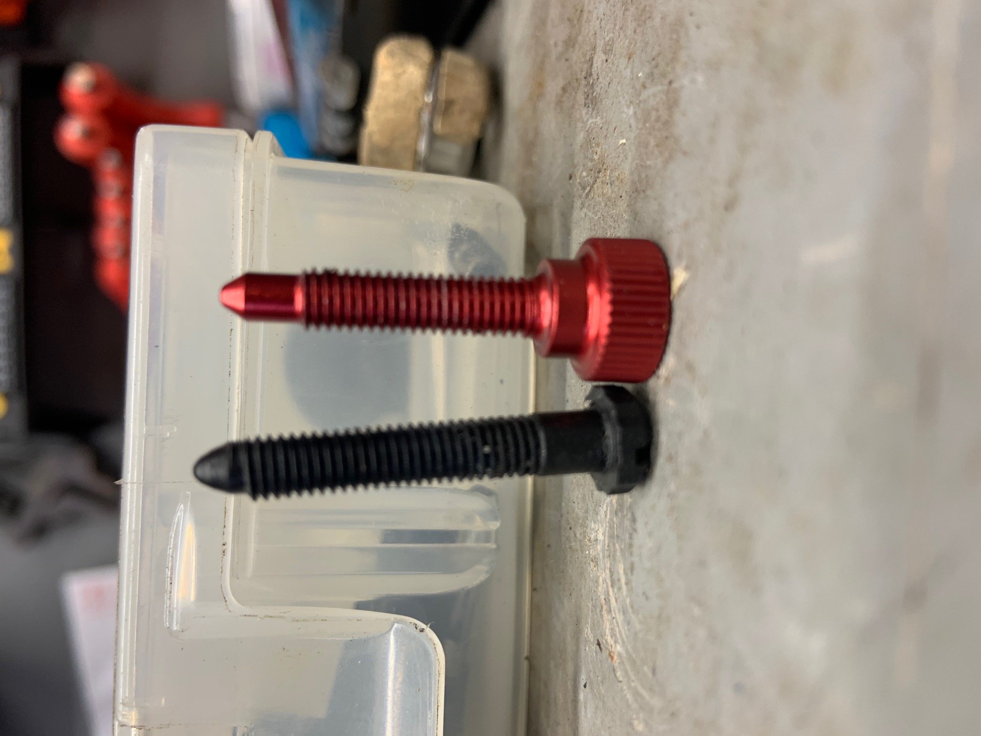

just replaced the plastic idle carb screw with a DAB aftermarket one and i cant get the bike to idle. Ive had it screwed all the way in but makes no difference anyone had the same problem and have a solution?? not tried messing with the air screw yet as its a bugger to get to
Does the replacement have sufficient thread length? The oem blue thread compound often gums up the internal threads in the carb body, might want to chase hole with the correct tap...carefully to not allow debris into carb/engine.
1942132176_IdleScrew.thumb.jpg.417ae36440ebb2783bbe87f9c1e8a6eb.jpgJust compared the idle screws and and they have different thread lengths the aftermarket DAB on being shorter therefore with the spring on it wont screw far enough in to the carb so the option is to shorten the spring or go back to the original screw

Just checked my order on Ebay  I BOUGHT THE WRONG IDLE SCREW ? returned today
yeh fussy ? mistake need to be more careful with the online shopping at 2am ??
