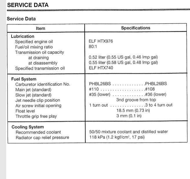

hello what it is the original setting of your 315r?phbl
-because mine was with 13 turns for the  air screw
-for the needle its the 2st step from the bottom
I changed the settings
-air-screw :3
-needle:3 step from the bottom
but she still does things strange to me:
-if I put the starter,she go really high in the rpm(I almost thought the cable was blocked ,so much  hight rpm)
-It doesn’t all go down right away when I drop the throttle
 -she Knocking crankshaft its ok , but maybe the 3  ring its bad  , not sure
while riding, it runs just fine.
but i think the   idle speed its not pretty to listen but she holds the idle speed
no air intake has the pipe, valve box its ok  , crankshaft I don’t know
she run  gasoline 98 (i'm french),spark plug br7es , spark plug brown
any idea suggestion , I would be happy , thank you have a good evening

Hello , thank you
"you need to use high octane fuel"
already used its sp98 ,I think is enough? as I say i think  it’s the piston or ring
"air leaks between carb and cylinder"
already checked,nothing at all
"the spring in the top of the carb maybe needs replaced"
I didn't know it could do ,when the spring is worn , I'm going to buy another one, but looks good to me she go makes this  just   when she is cold
thank you
