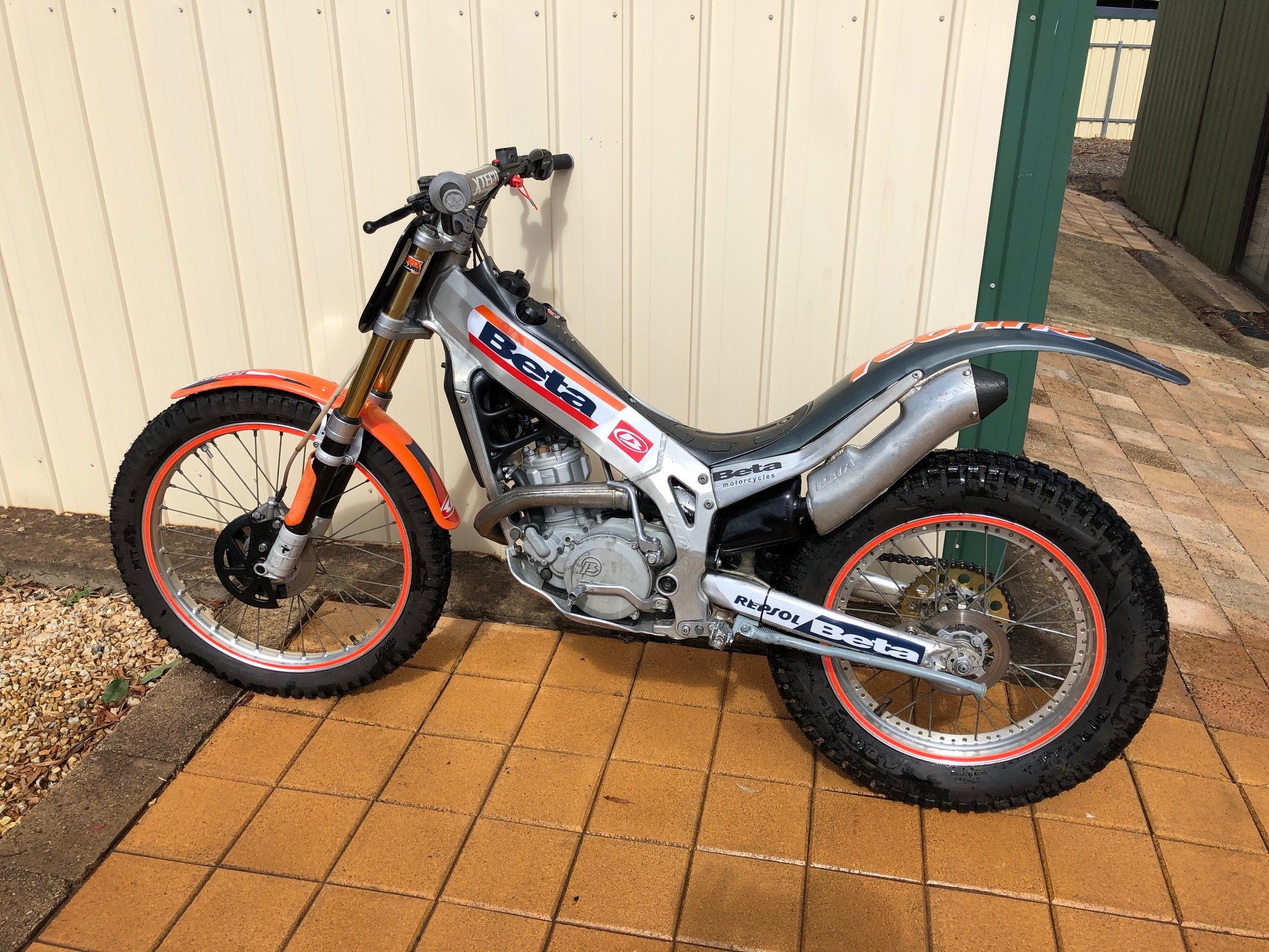

I have attached a Pic of my Beta - not an oil painting and later decals are fitted but it mechanically its just about there now.
Lovely looking techno, Walker.
