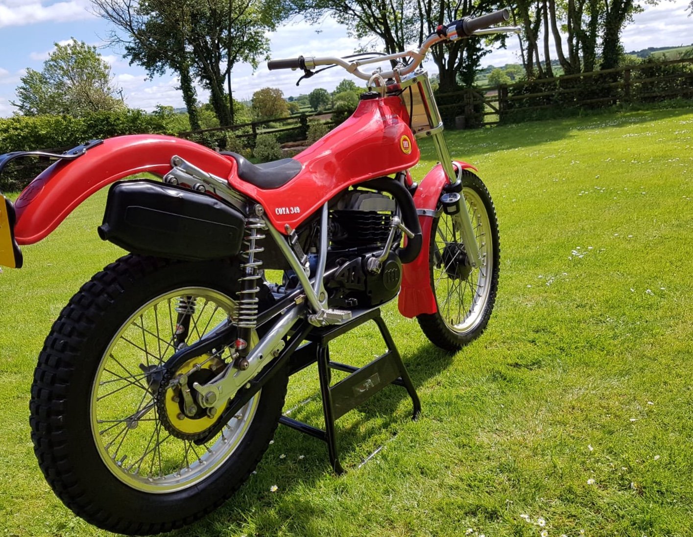

I have just bought a 1980 Montesa Cota 349 which as you can see from the photo is in lovely condition. BUT I can only select 1st, 2nd and neutral gears..The clutch cable had been adjusted to maximum so thought maybe replacing this might help matters bearing in mind I couldn’t select neutral when the engine was running. The new clutch cable was fitted and neutral could now be selected with engine running and also 3rd gear was available if you lifted the lever hard enough ( not ideal ) 4th and 5th are nowhere to be found...Can anyone please help and maybe shed some light on what is going on and if they could give me contacts of anybody familiar with classic Montesa’s in Wiltshire who might be able to fix it.

The symptoms you describe are what occurs on earlier Montesas when the carrier which holds the selector pawls is fitted upside down. The slot is not quite central, though at first glance it appears to be, which makes this an easy mistake to make, I've done it myself in the past. Easy to remove the pawls and carrier (don't let the pawls and springs fly off and get lost when you do it), move through 180 degrees and refit.
Many thanks for that information and advice. Will give it a go and hopefully get it sorted. Much appreciated.

Well thanks for that comment THAI-TY. BUT...Today before any dismantling took place I thought I would check the obvious...GEARBOX OIL...Barely a couple of spoonfuls came out which was sludgy...Topped up with the recommended amount and road it down the lane and guess what..BOOM..Gears all working...SO not only do I have a PRETTY Machine but it’s fully functional as well..Thanks Thai-ty for being honest about your past, I’m sure there are still those out there who like to rip people off but the this machine did come from a reputable source...Lesson for me..ALWAYS CHECK THE OBVIOUS...Thanks all for your comments.?
