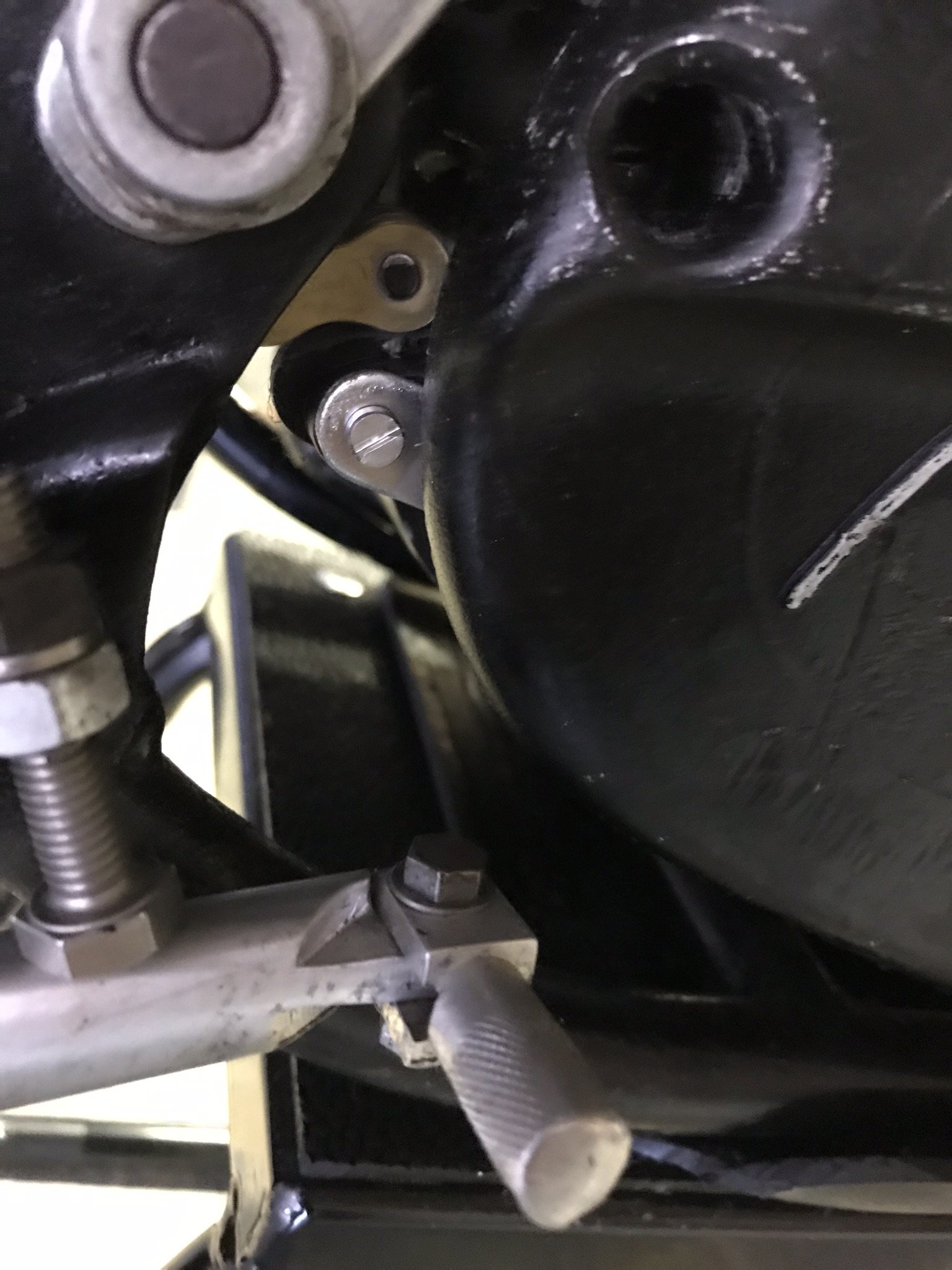

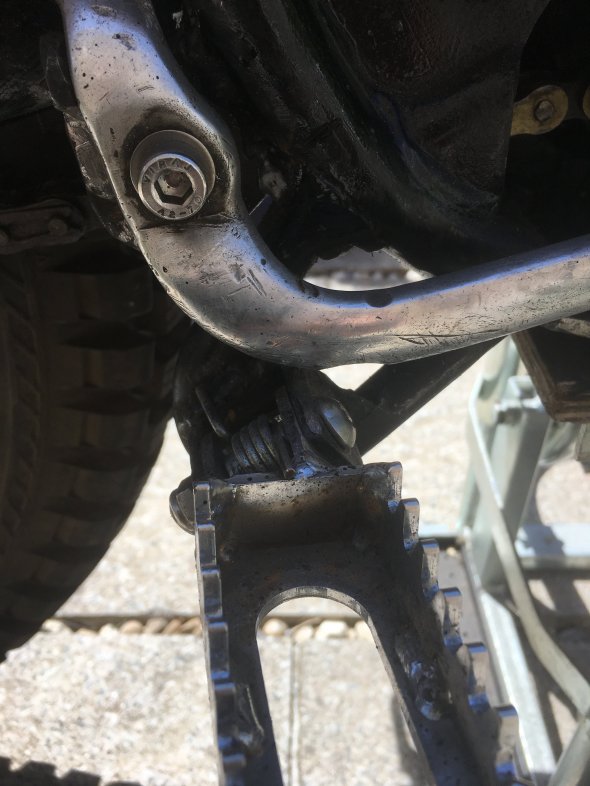

Update on rear brake shoes , scuffed the drum and the shoes , leading edge done ,brake still not great before I contact villers, the brake pedal is hitting the foot peg , pegs are lowered , have a look at the photo see what you think

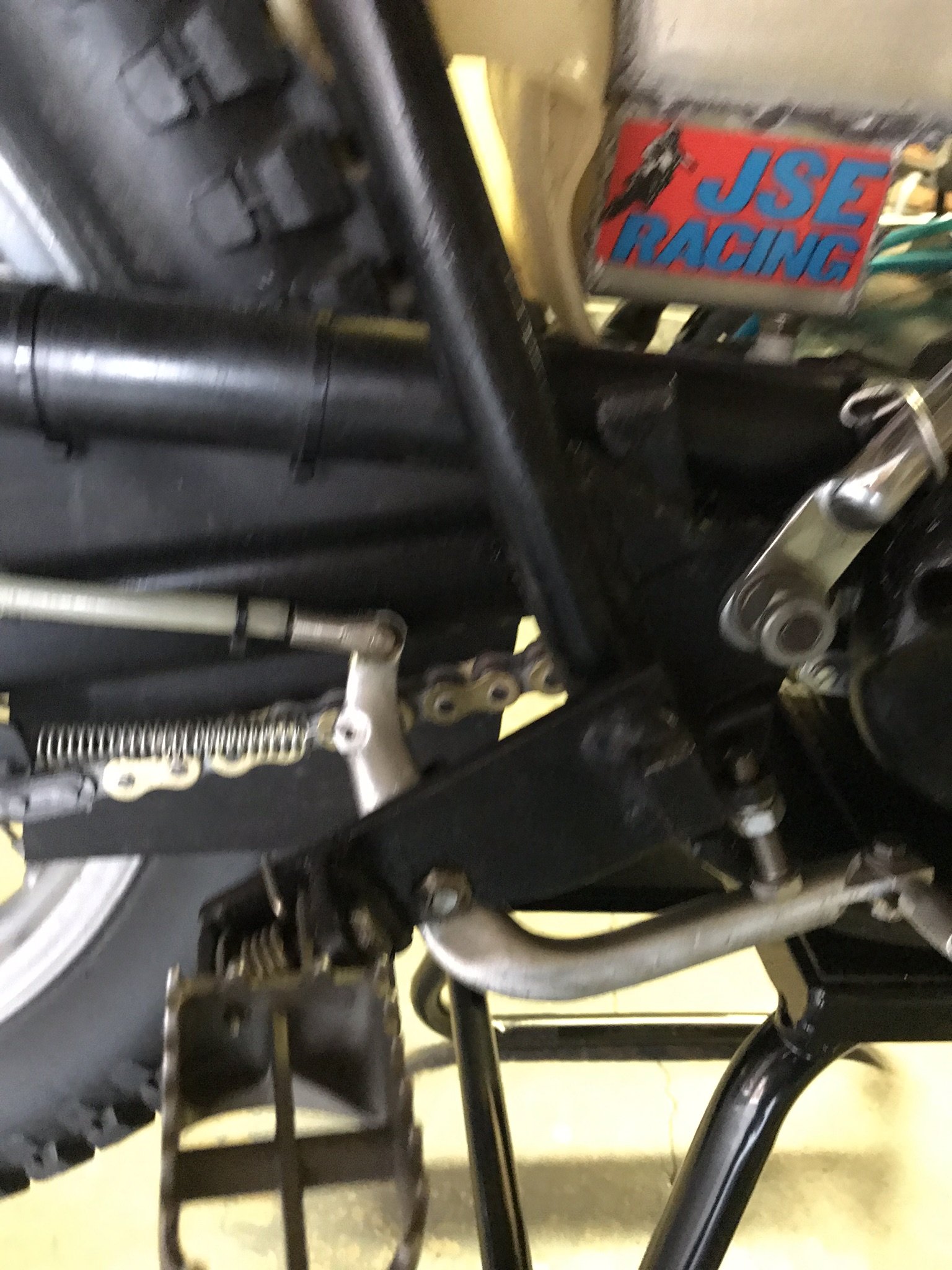

That brake pedal pivot needs looking at as the washers not central. If you grind away at the lever it will be weakened, if you grind the footrest mount it will be weakened. Heres my 348 rear brake
