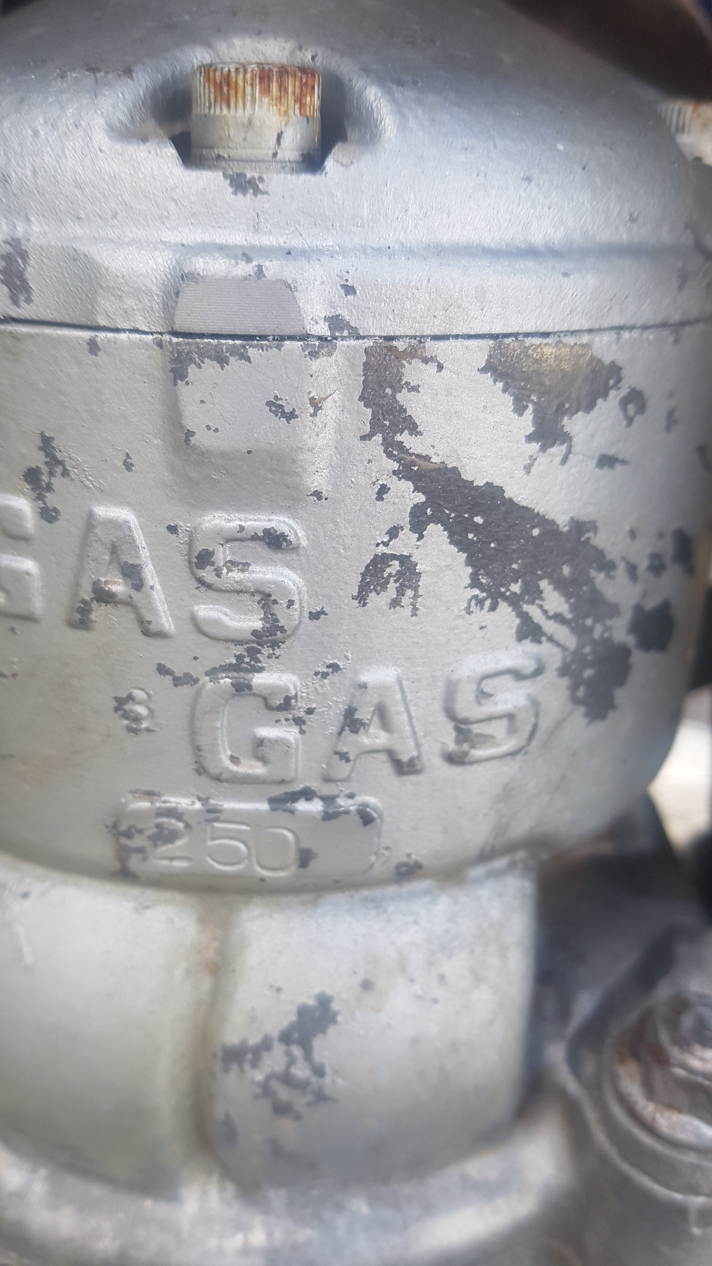

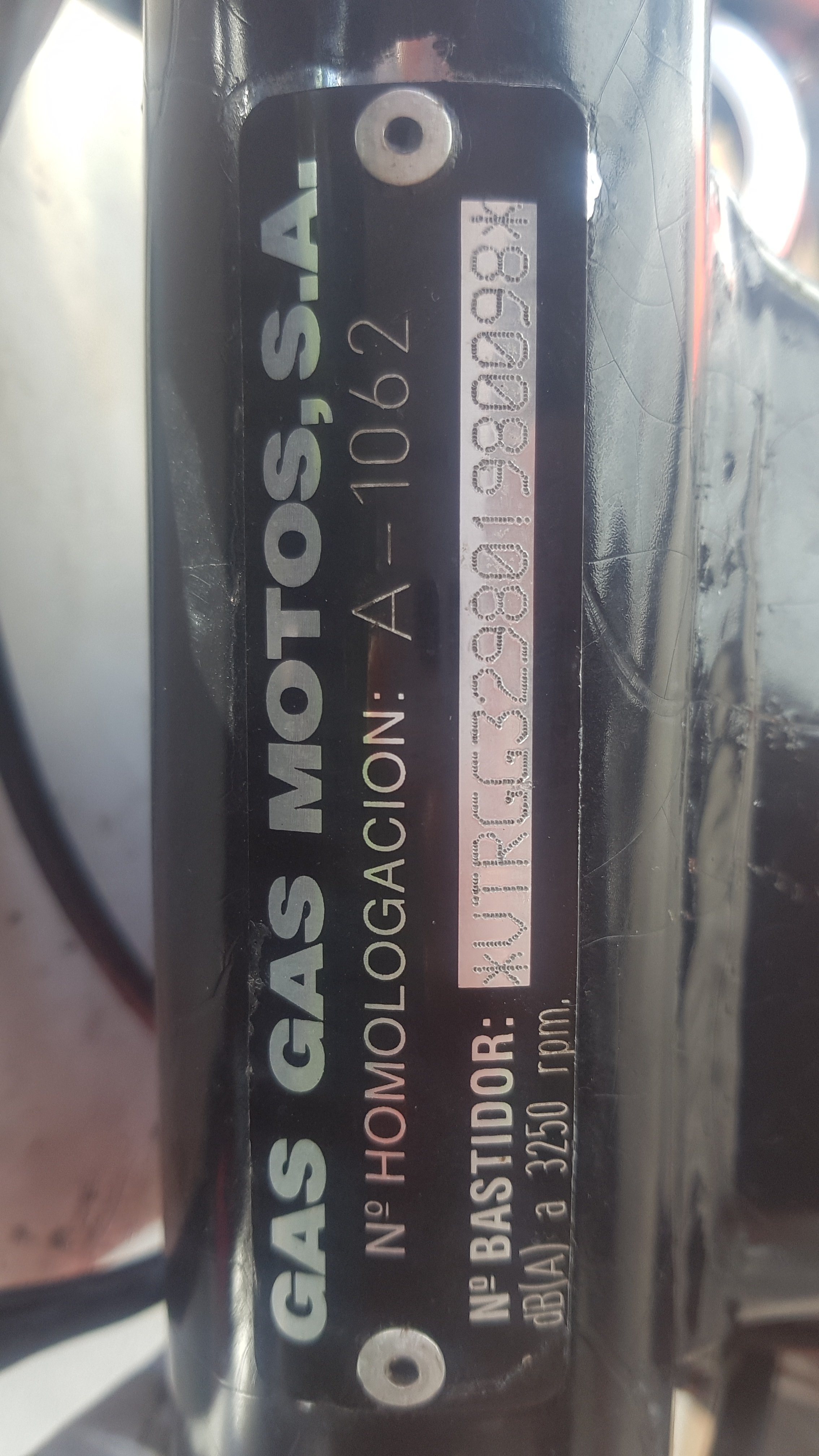

It’s 1998 tx320 according to that. Looks like someones put a 250 barrel on it at some point.

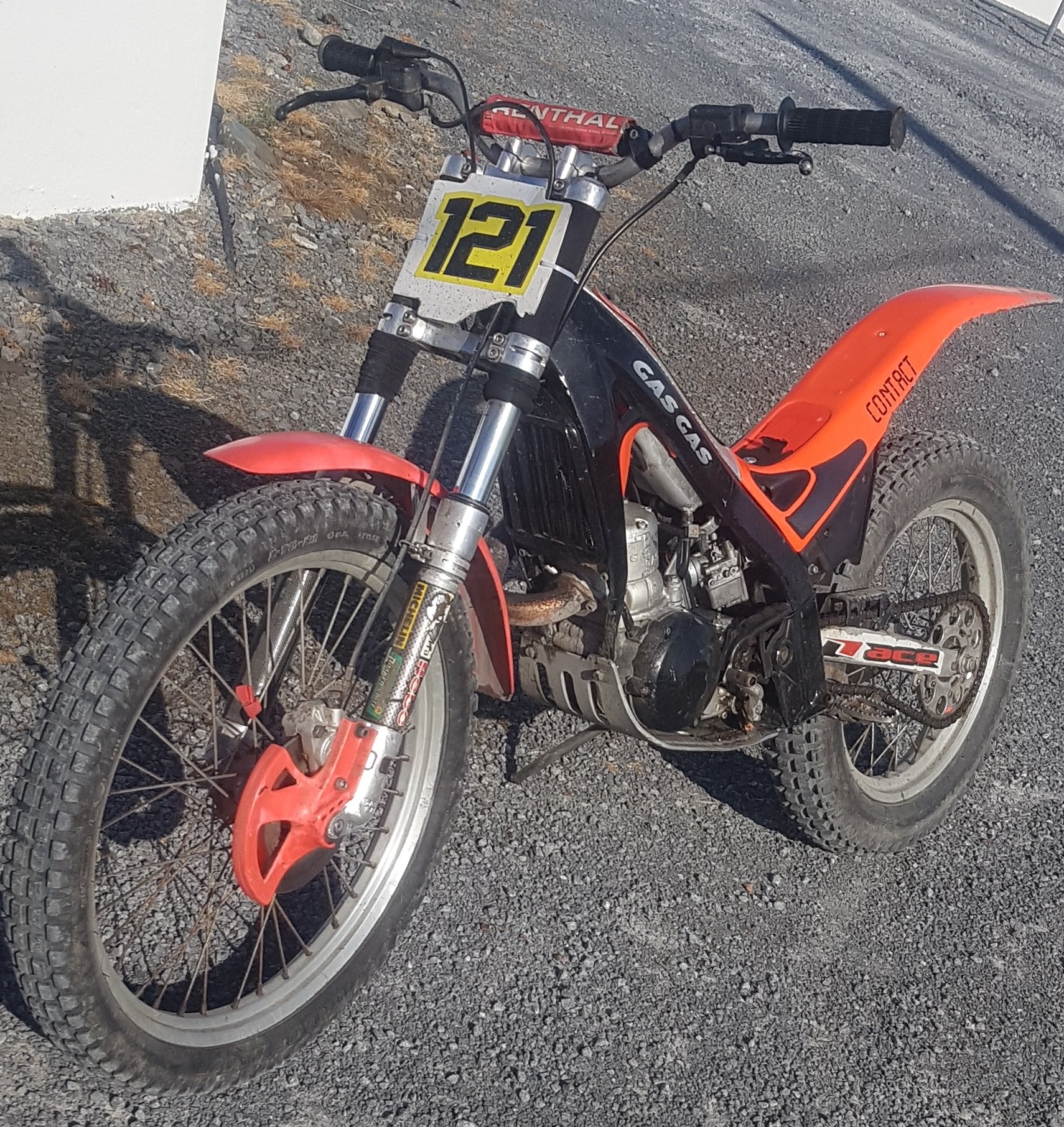

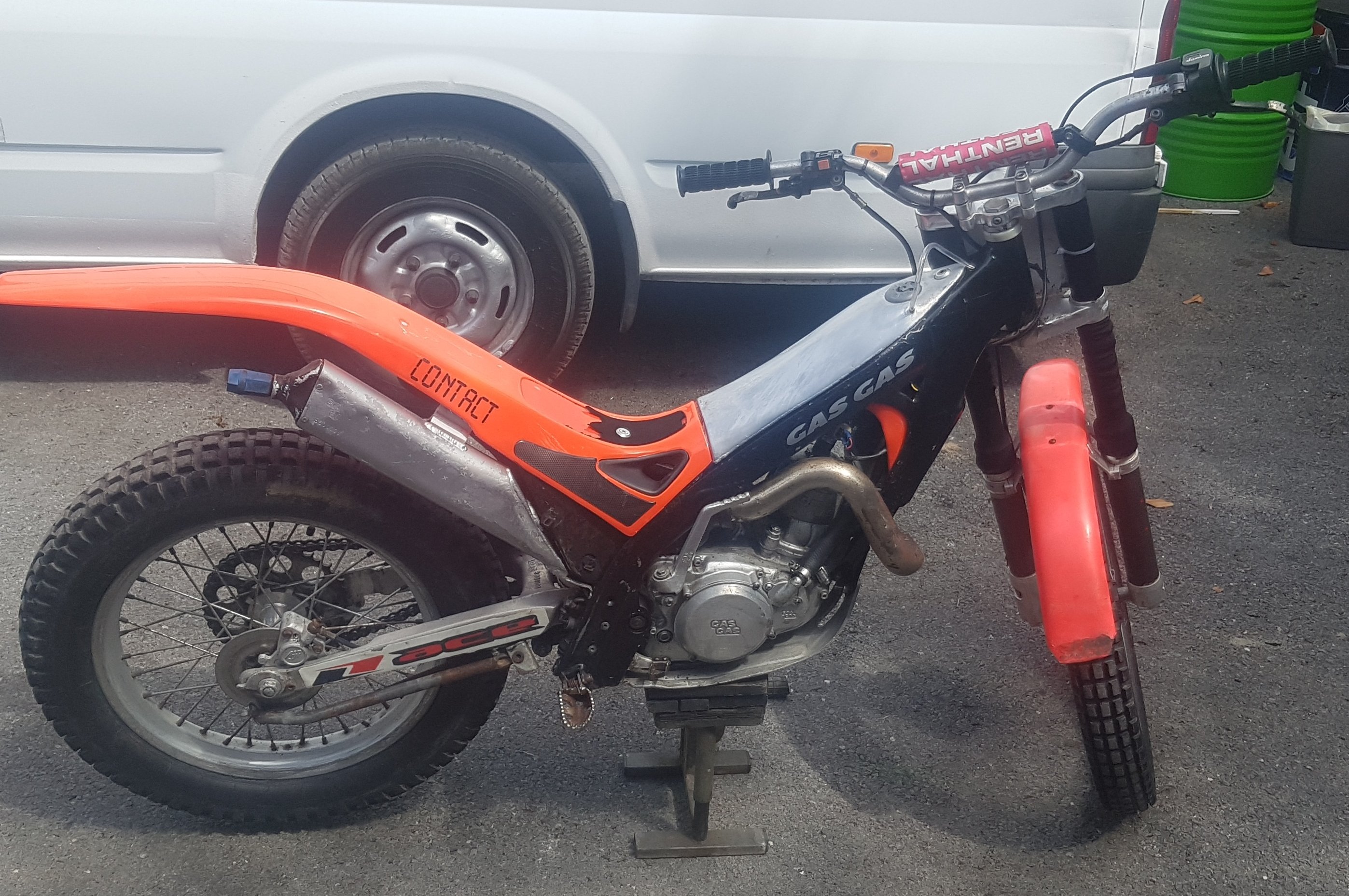

It’s got an older rear mudguard from a 97 jtx & someone’s also painted the frame black. Should be chrome.
