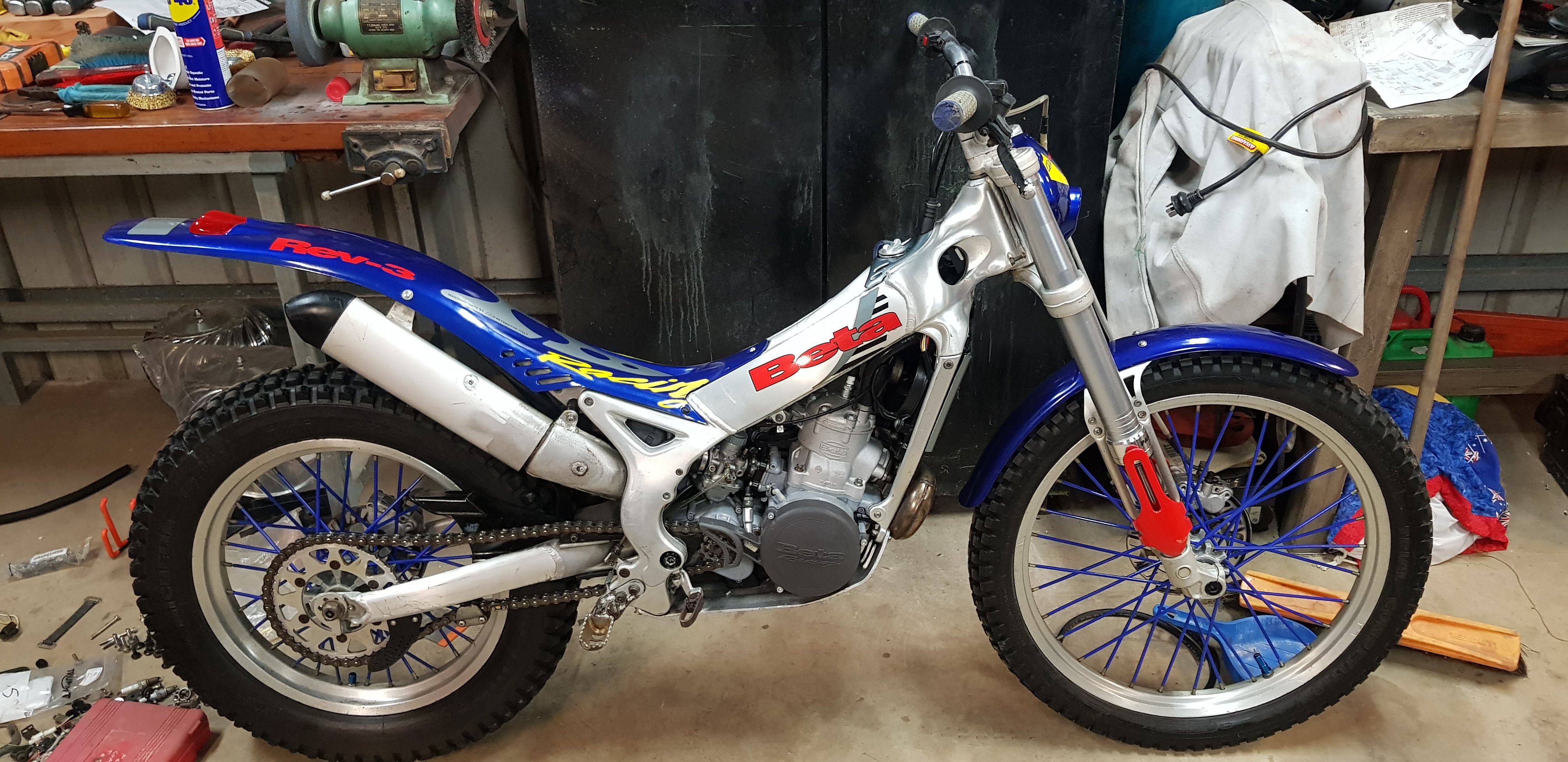

With a little bit of luck some may be able to point me in the correct direction.
I have a 2000 rev 3 with the USD front forks. Being the only year Beta did the USD forks in the Rev 3 there is no information out there on them or parts. Although mine are working ok however they are a bit on the sad side of things and are sagging.
All the replacement springs i have found so far say they fit Techno, Rev 3 and Evo but there is no information as to if it fits USD models.
I know a few of the Technos had USD forks so does anyone know is they where the same as the Rev 3 and the spring's fit and are still available. Or if there is any other springs out there that will work. I believe i am just a little bit to heavy for the stock spring as with my gear on i am 85kg.
With the stock spring i have 135mm of travel  but with the max preload and me on the pegs it is sagging about 50mm with min preload it is sagging 62mm. The bike is sagging 22mm under its own weight.
I have been told you want about 1/6 of your front travel to sag under your weight. So i only want about 22mm of sag with me on it
Thanks for the help.
P.s im located in Brisbane Australia not that it matters to much lol

You are right my bike looking like a 2001 but it is a 2000. Someone has fitted the 2001 fenders on to it. I know that the 2001 had the option to fit the USD forks but from what i have been told non where bought into Australia.
I would like to convert it back to the correct colours being the red and black but you can't find rear fenders at all for the 2000 and 2001 never mind being picking about the colours and i hate to even think about the cost ?

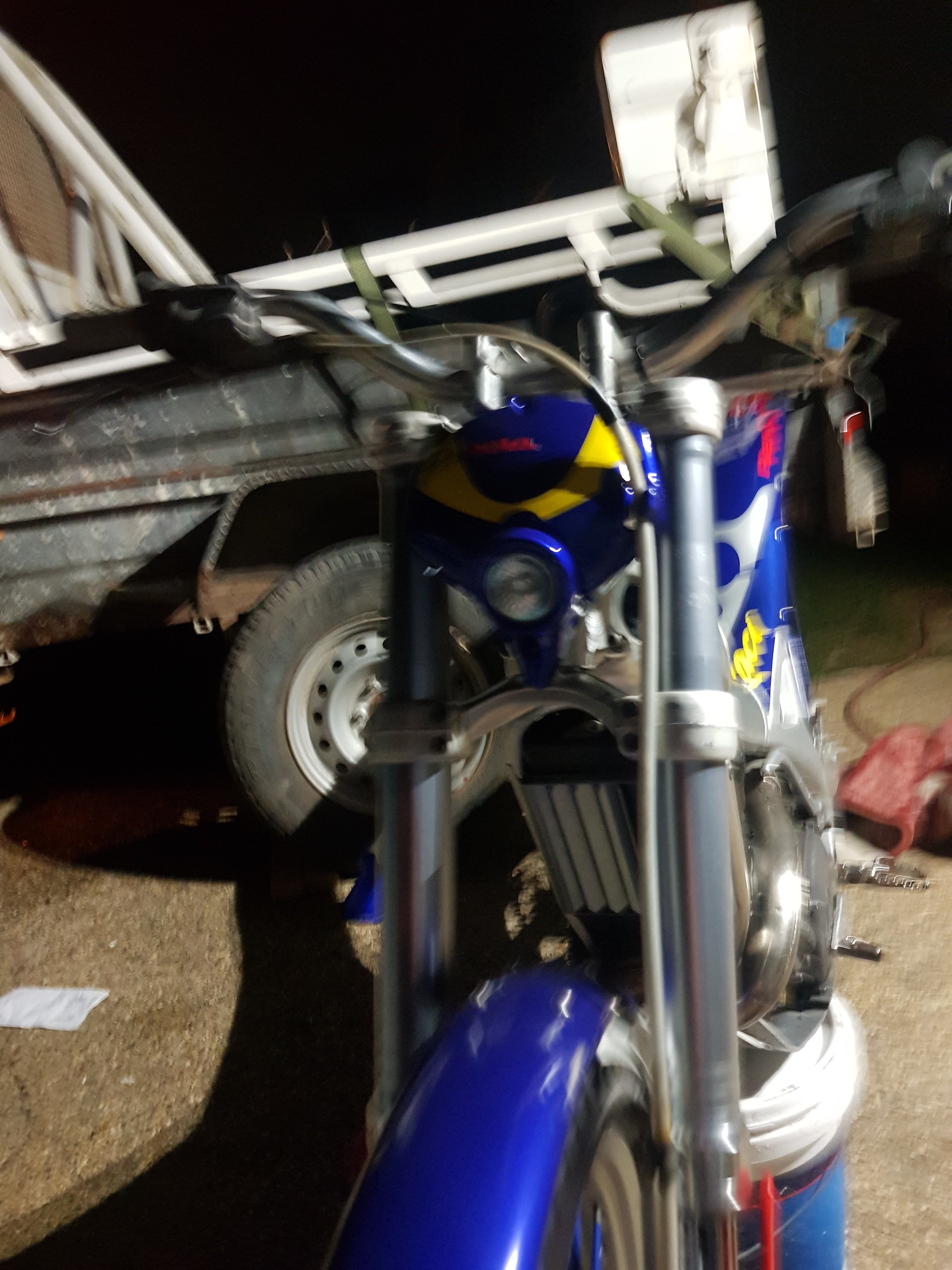

It is interesting that there is 2 bikes that look very similar of that age in QLD. Mine has the headlight but no wiring and the front guard has no decals on it. 20200523_190925.thumb.jpg.43f3a172c3a0613f1ee4c094b43bd6d8.jpg
