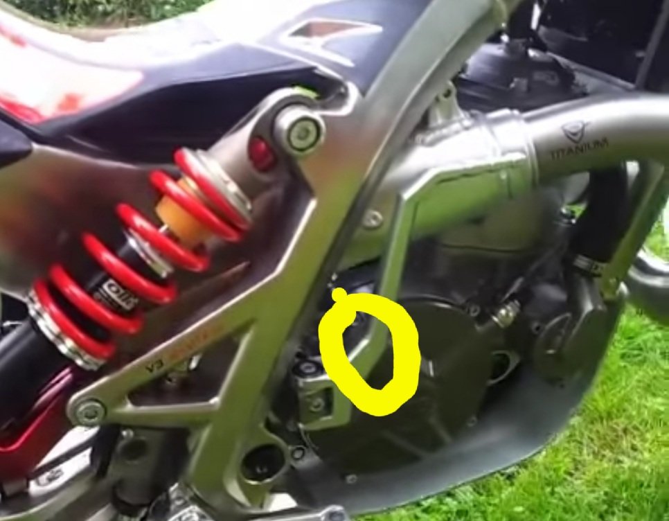

HI there just got my first jotagas jtg 250 trails went out on it for the first time a the kick start lever broke, it broke in below the middle see pic below,  So I just need the kick start lever.
Dose anyone know where I can get one, or dose any other brand off bike fit?

I could be wrong about this, but I think that I have seen a picture of a Jotagas with a GasGas Pro kick start lever. Worth a try.
S
Gas gas pro kickstart fitted to my 2013 250, had to do a bit of grinding but shaft and splines the same
I got in touch with a dealer he said the gas gas will fit but I need to use the jotagas fitting at the bottom.
