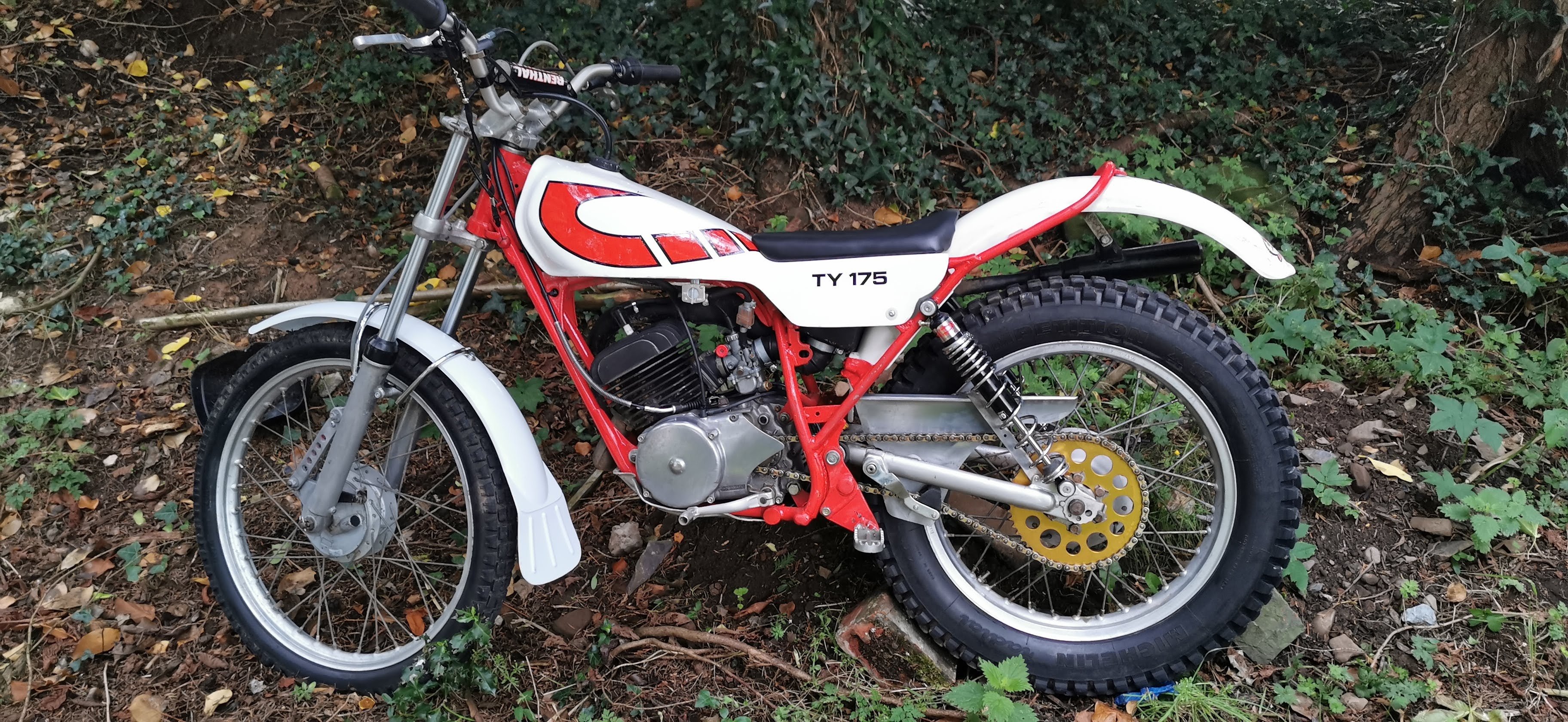

September 19, 20206 yr Hi al Got a TY175 recently and nice looking bike. Starts OK but will only run for a few minutes then bogs down after riding for a few minutes. When you let the clutch out when pulling away, doesn't want to go, bogs down and have to give it a lot of revs, but then eventually it dies and won't start again then. Any ideas? I think carb related as repalced spark plug and air filter is clean. Many thanks!

September 21, 20206 yr Runs for a few minutes? Is it running out of gas in the float bowl? The reason I ask, it looks like a Sammy Miller gas tank-seat. Fiberglass. Fiberglass and some fuels just don't get along. The fiberglass gets soft and mixes in the tank and can clog thinks up. Pull the fuel line off of the carb. It should pour out. if it drips, well you know. Also..if that is a fiberglass tank, it should be coated to prevent it from being ruined by the fuel. BTW good looking bike.
