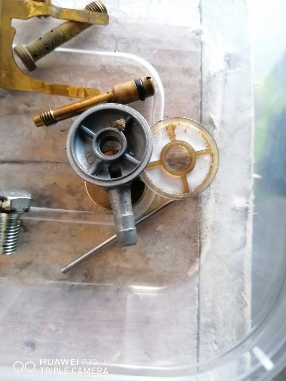

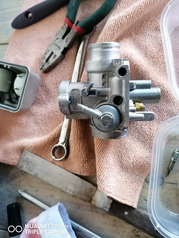

Hello it is all new for me just bought my first bike Sherco 250st 2009 and it struggle to start first time every day after 5 minutes of kicking bike( with choke  with out with throttle open ) it will get running and then it starts every time first kick it is only after a  night  have cleaned the carb but still the same anu ideas
