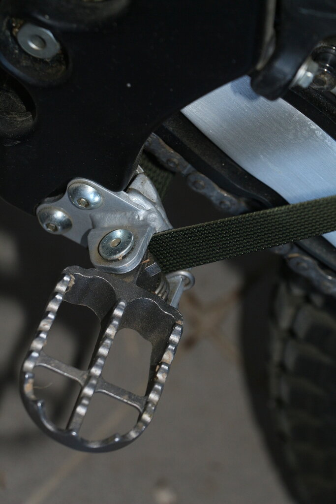

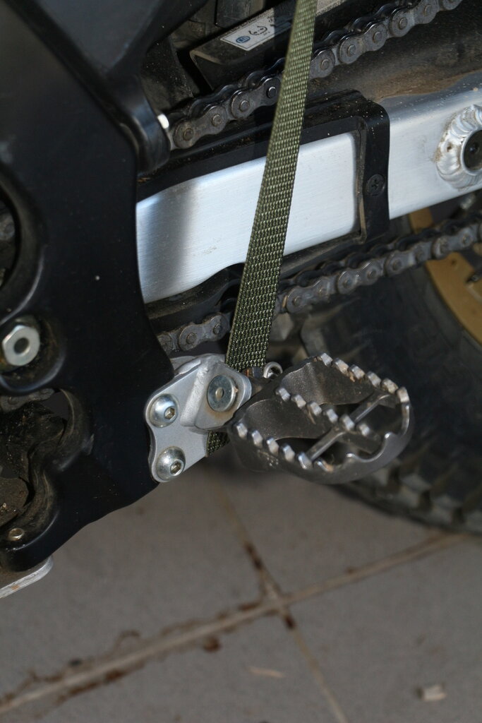

Temporary setup: the straps go through the foot pegs. Ugly but works OK.

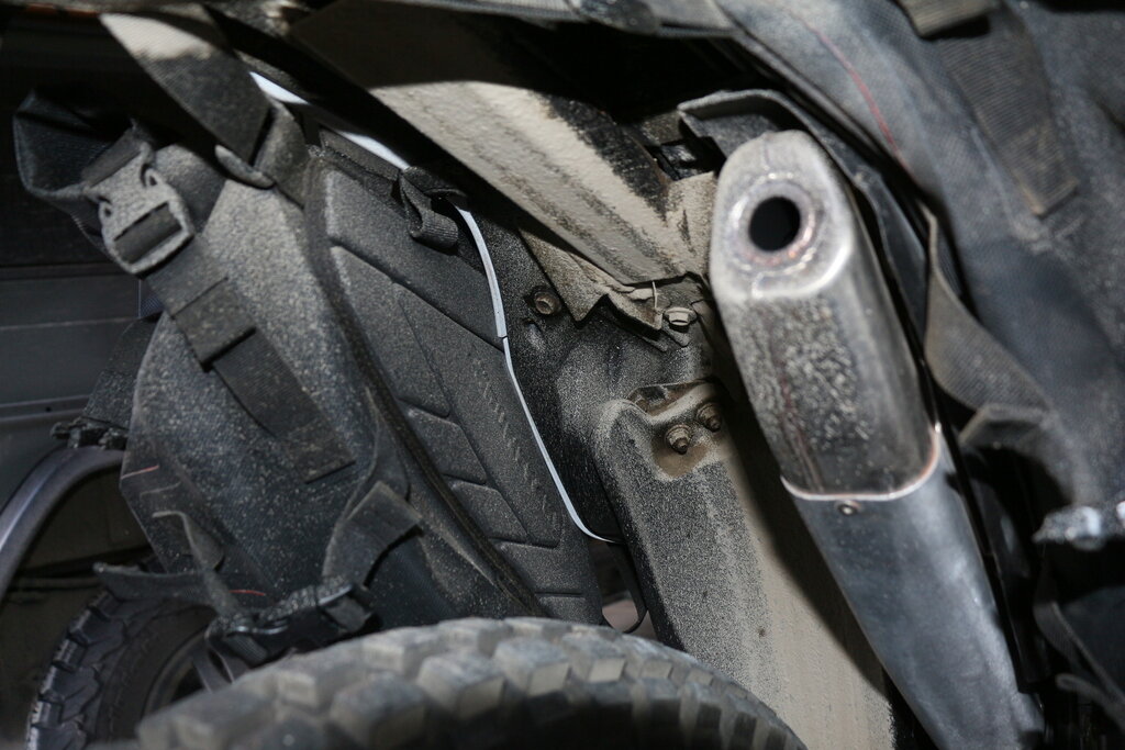

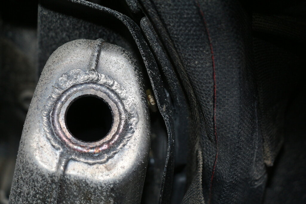

close-up of the heat shield; the thing at 2 o'clock is a stainless steel bolt (bolted on the plastic shield) that acts as a spacer to prevent the shield from bending under the weight of the bag and melt on the exhaust.

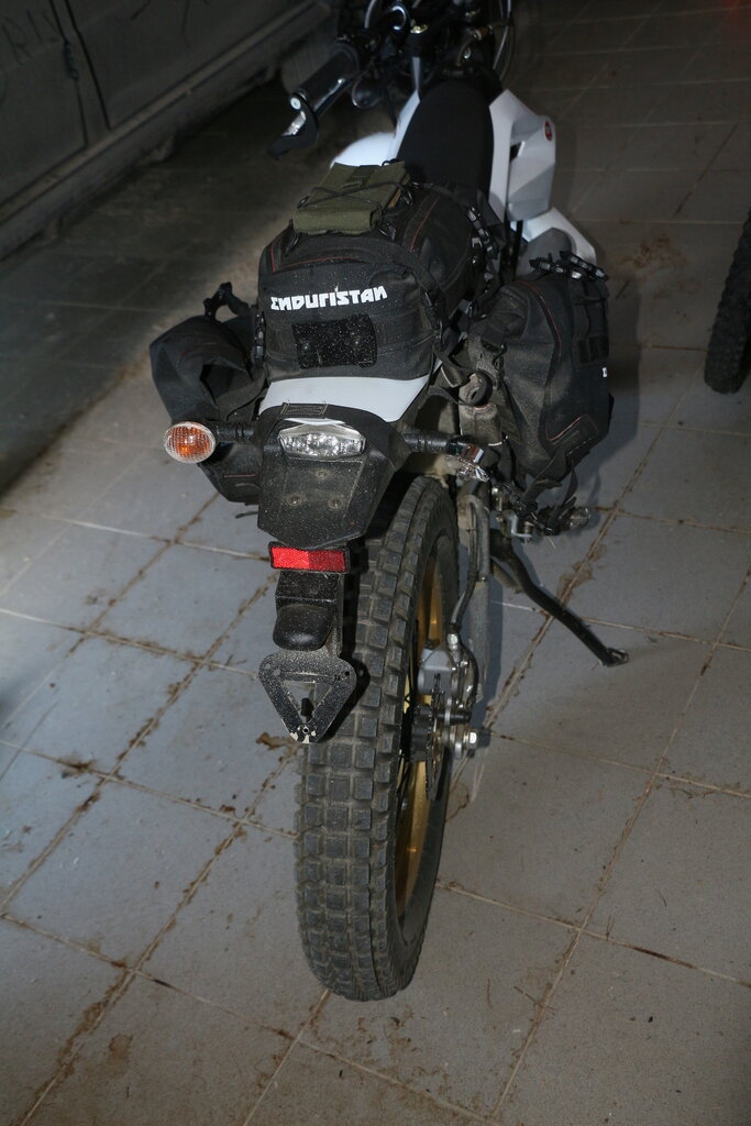

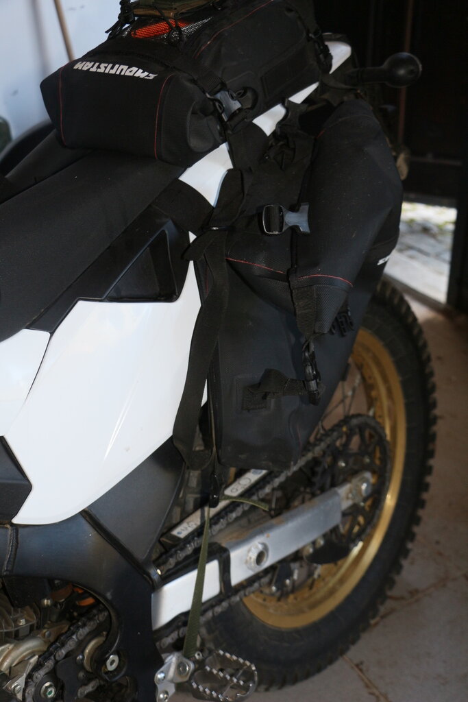

quite a bit of the left saddle bag is unsupported. It hasn't been a problem til now (ie. it's never been rubbing on the tyre) but more support would be better - eg. maybe a stainless steel / ABS hoop - like an inverted U shape - from one saddle bag to the other.
