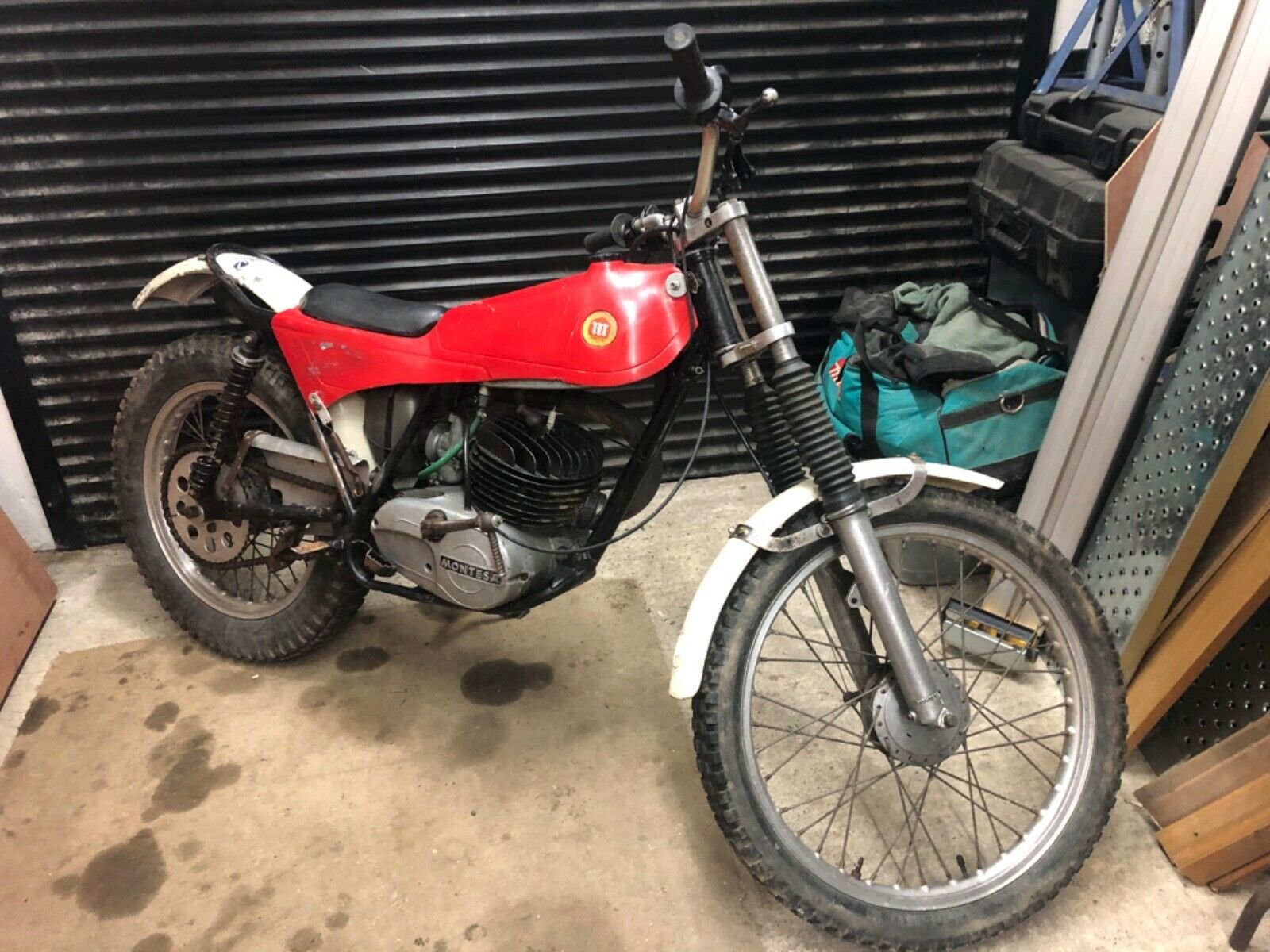

Hello I have just bought a 247 C chassis/engine number 21M26447 for restoration. Its a late one I think and has the air forks which I understand were fitted from 21M25137?  Any tech specs or literature specific to this model would be great as I want the restoration to be as accurate as possible.
Thanks Dave
I have a handbook for the 247c and will pm you re sending a copy of the vital data. Meanwhile  you should move the kickstart lever on its splines to the 1 o'clock position. If it's too far forward as in the photo it will damage the side casing.
