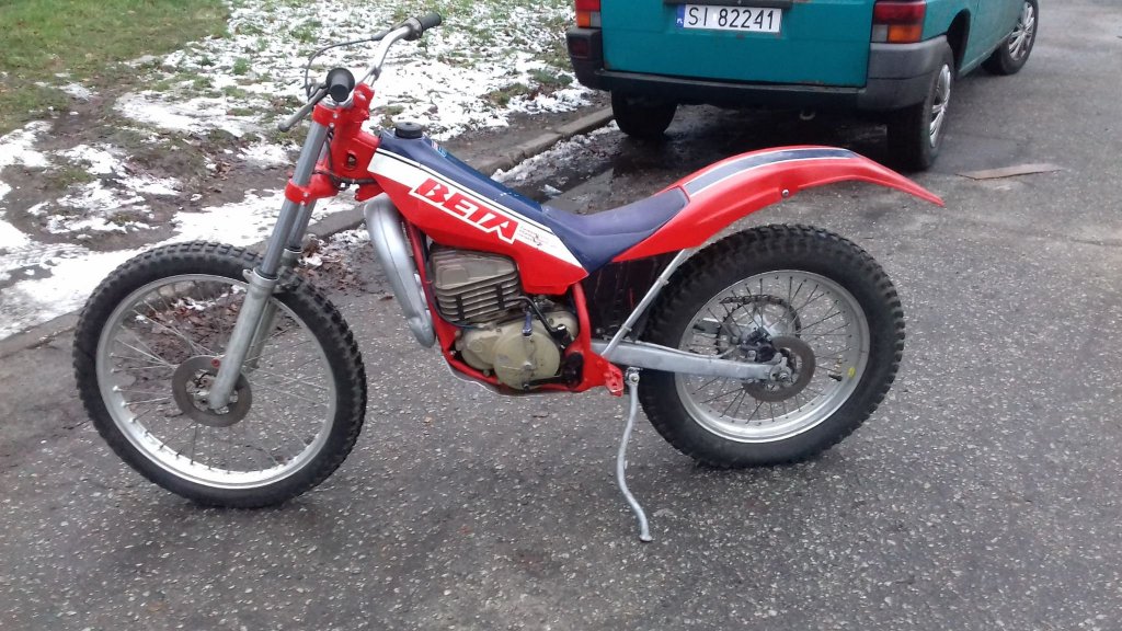

I've just bought a 1988 Beta TR34. It requires some TLC but nothing major I believe. It was dismantled by previous owner, so I bought it in boxes but I got a photo of it put together :)

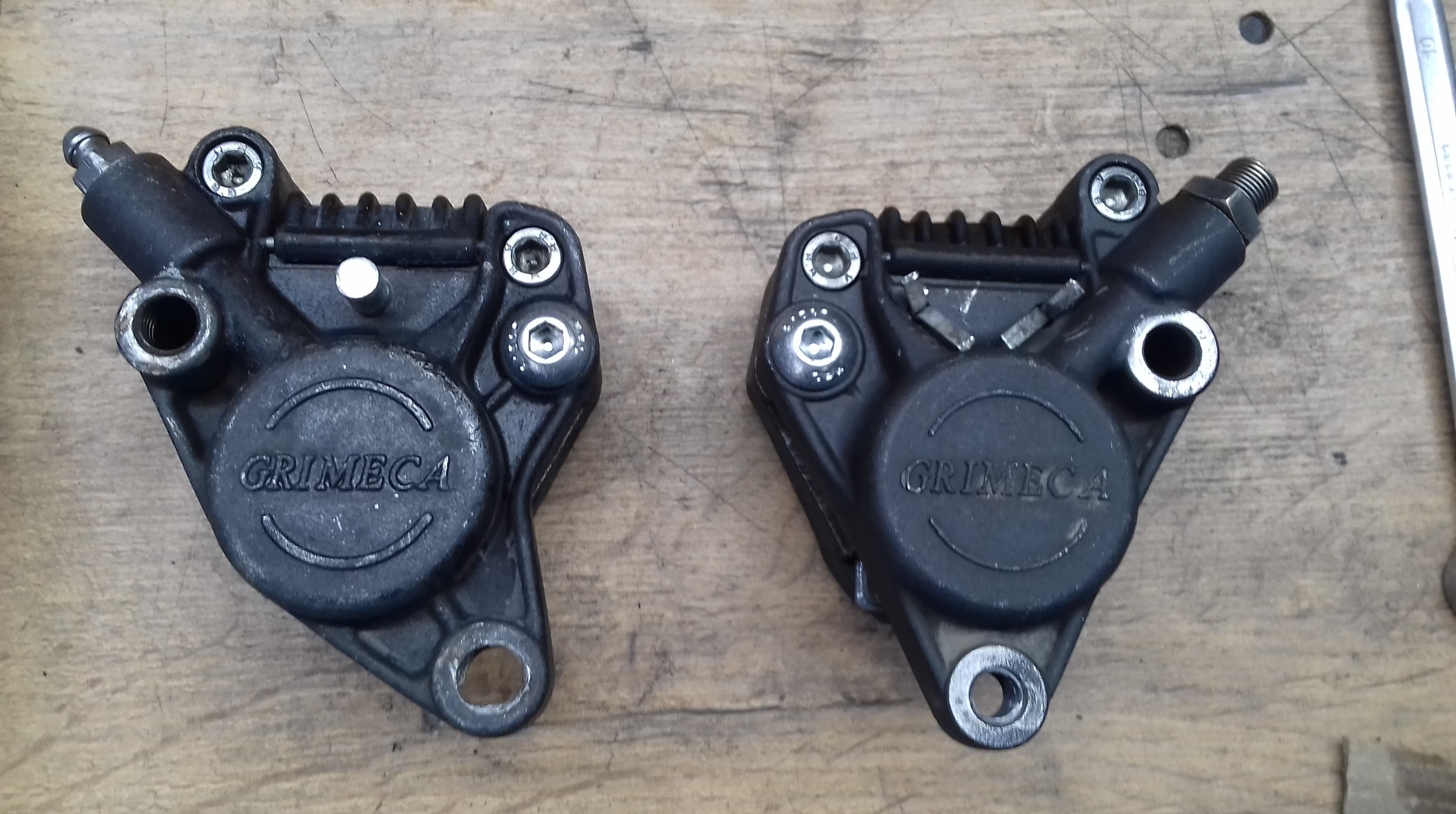

I've opened front brake pump - seems that brake fluid has turned into jelly :)

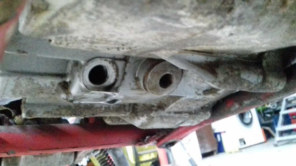

Next, I've removed the skidplate and drained the oil. I've screwed out both plugs at the bottom of the engine but not even 300ml of oil dripped out. I've tried leaning the bike to the sides but it didn't help much. I have repair manual for TR32 and it says the engine holds 1 liter of oil. I would assume it should be similar for my TR34. I haven't seen any signs of oil leakage on the casings, so seems strange to me.

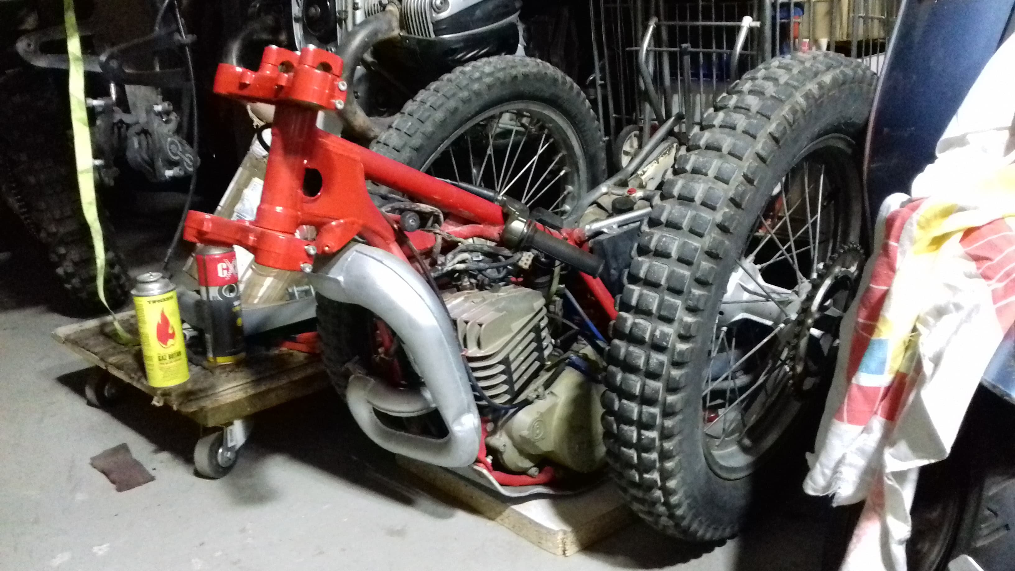

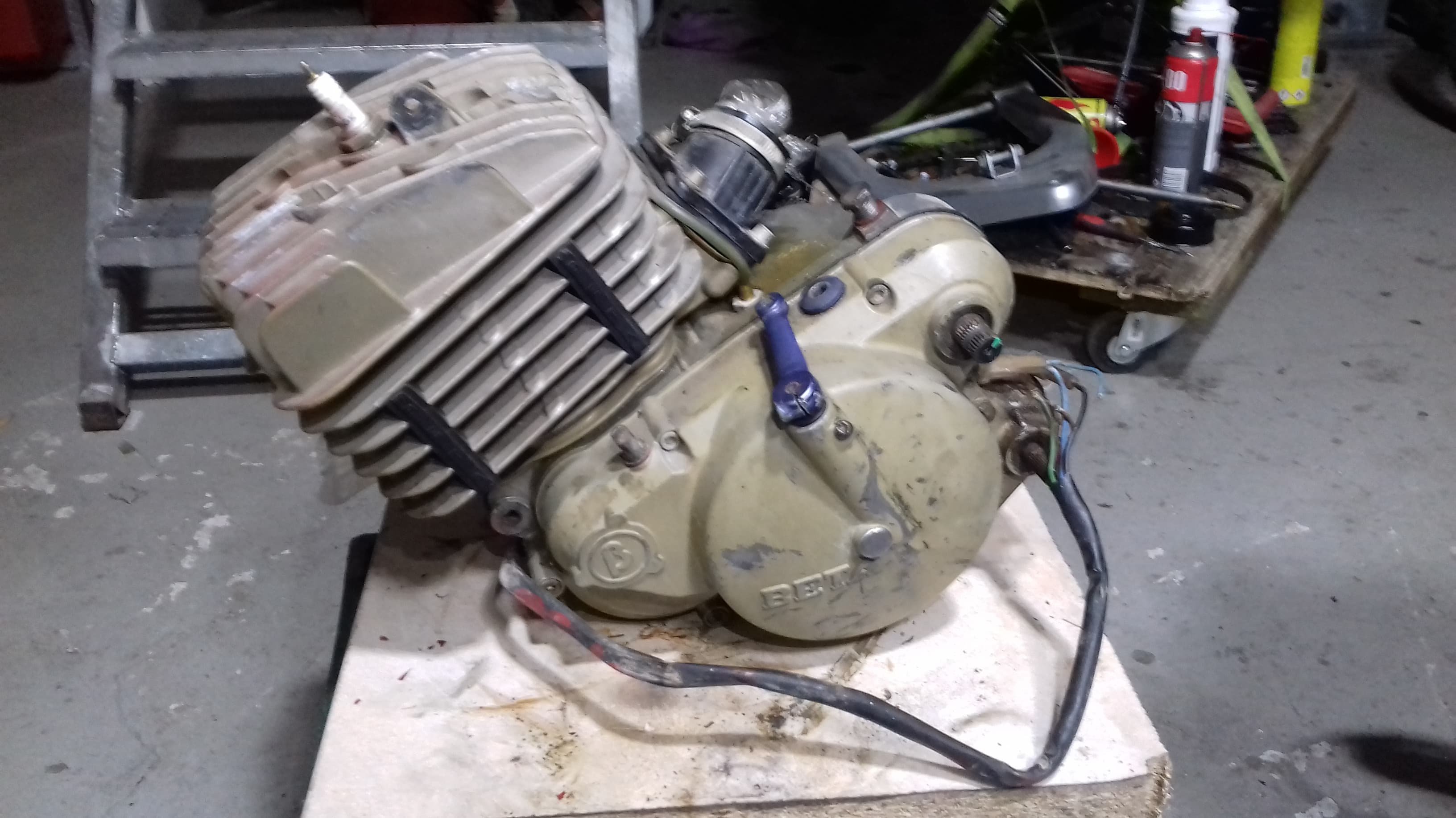

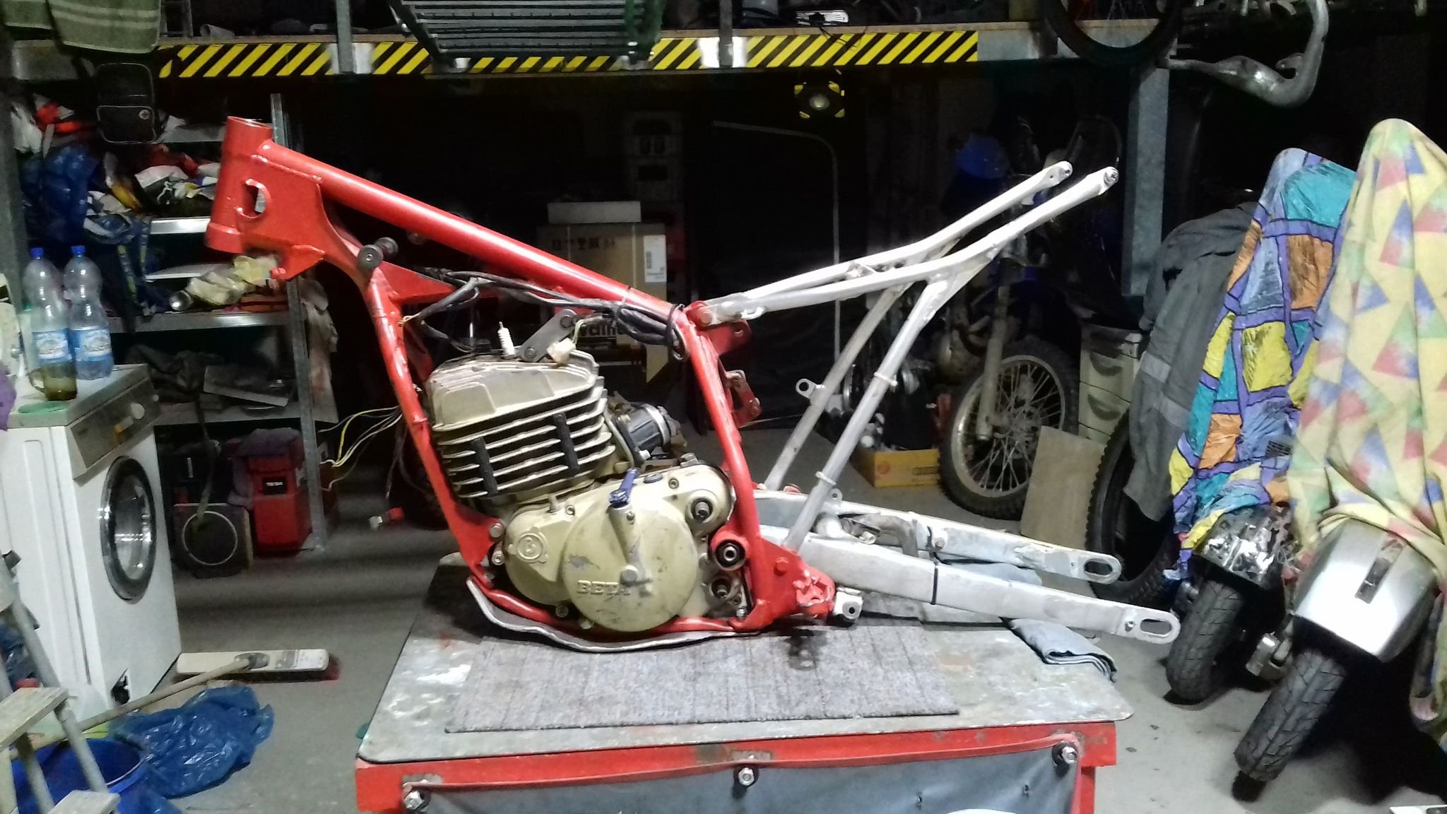

Engine is out, I need to weld up the crack in the frame:
131624535_145235750706484_5034451481589962661_n.thumb.jpg.3cb317cce9fe4f981ae0a906896af356.jpg131381992_432431527945995_8772047471075674677_n.thumb.jpg.aa4474961a15e6cdfab33eeed7a0a92a.jpg

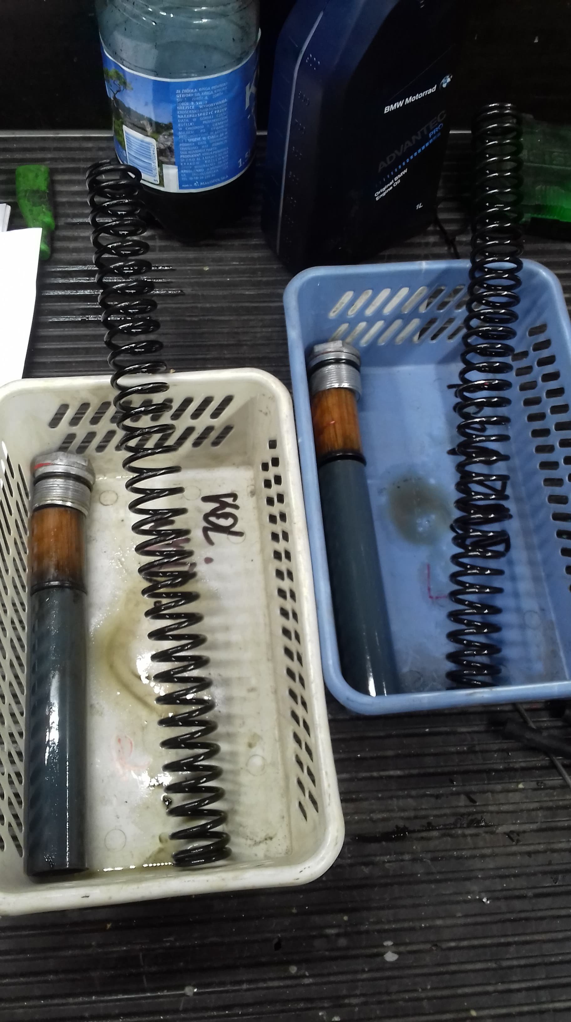

Forks disassembled, new seals on their way. Springs are quite beat up, there as additional woodden spacer for preload adjustment.

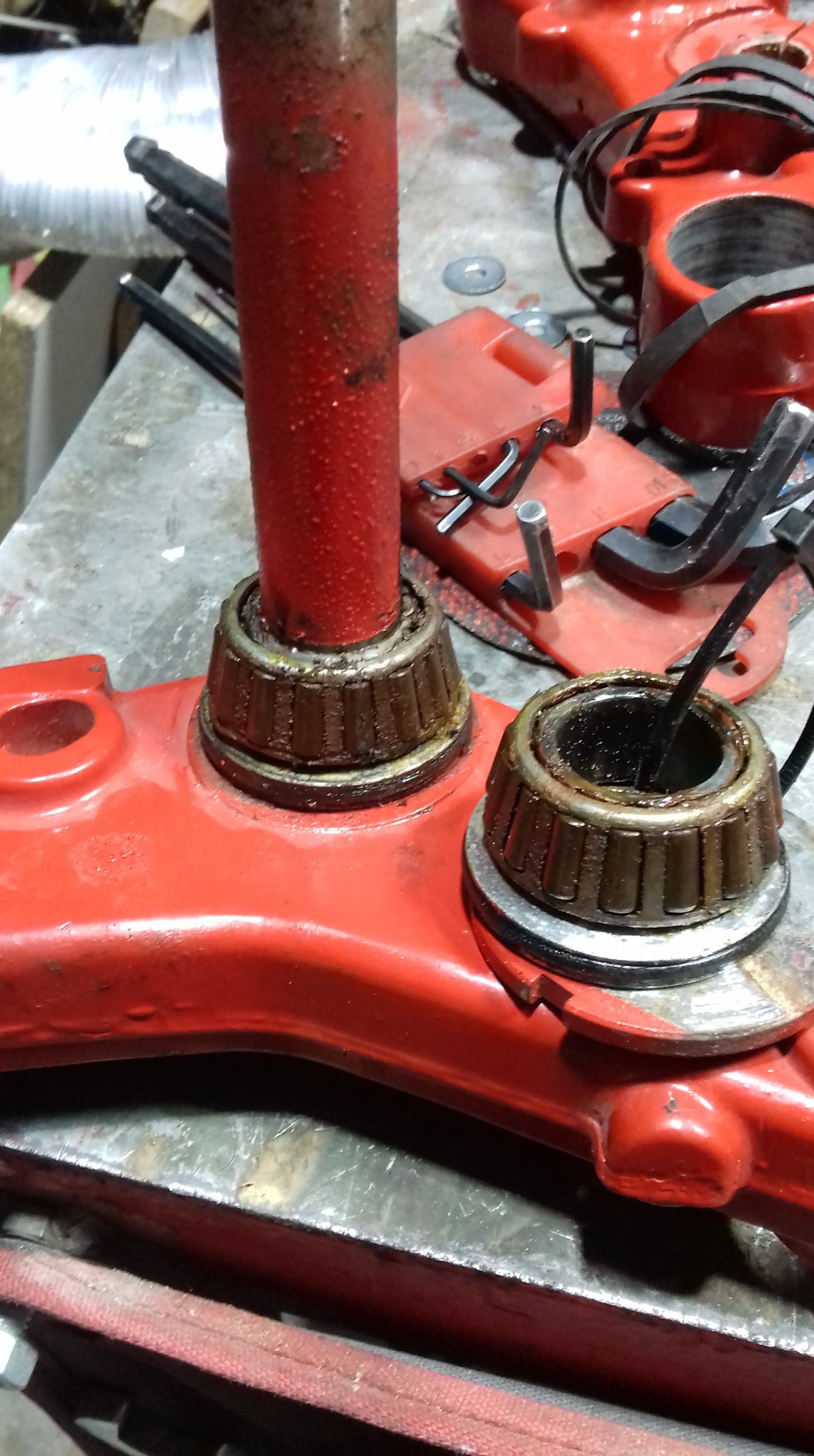

Headset bearings need cleaning and greasing.

Crack in the frame welded. Engine cleaned and back in the frame.
