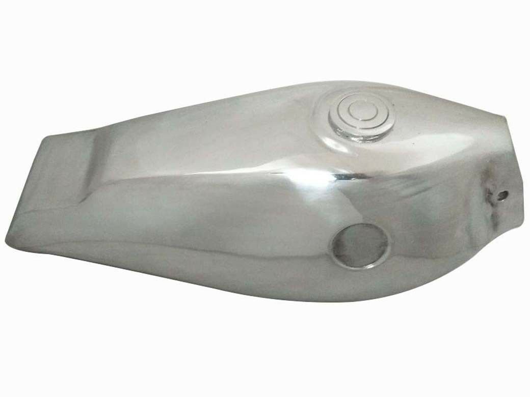

     Has anyone have any experience of the Butaco Sherpa Alloy Fuel Tanks currently for sale on Ebay?
These are made in India just wondering what the quality is like. The pictures of them show an unfinished tank without a Fuel Cap.

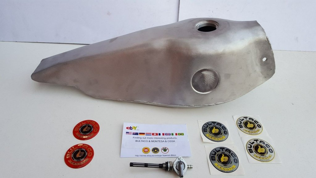

They might label them so but they aren't Sherpa tanks, they are Alpina
Who? The ones on Ebay?
https://www.ebay.co.uk/itm/BULTACO-SHERPA-ALU-BENZINTANK-NEU-BENZINTANK-ALU-BULTACO-SHERPA-ALU/182822949409
Claimed to be Spanish

The aluminium "Sherpa T" tanks on eBay made in India are replicas of late model Alpina tanks (model 212/213)
Alpina tank:
https://www.ebay.de/itm/Bultaco-Sherpa-Model-Gas-Petrol-Fuel-Ta309931913_Alpinatank.thumb.jpg.06fb8398223aef3c68ec492dd9098eca.jpgnk-With-Cap-Aluminium-Made-GEc/153824255290
Sherpa tank
https://www.ebay.de/itm/BULTACO-SHERPA-ALU-BENZINTANK-NEU-BENZINTANK-ALU-BULTACO-SHERPA-ALU/182822949409
Yes, like the first picture in Carl Ekblom's post.  I forgot to link my reply to your original question. As far as I know the Indian seller doesn't have proper Sherpa tanks, only Alpina
Also, there are two types of alloy tanks for later Sherpas and are different shapes. The alloy tank fitted to UK bikes from model 159 up to 199A are copies of the original fibreglass tank.  The UK alloy tank originally fitted to the 199B (now reproduced by JC Fabrications - see bottom picture) and the alloy tank now available from Spain (middle picture which is the tank In Motion sell) are based on the last models plastic tank. The slope of the tank where it meets the seat is differs from early to late and the front of the seats for each were shaped to match

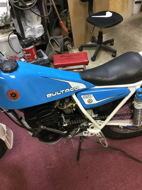

               Thanks for everyones help. I have a 198A that I am restoring. It came with I think a period Sammy Miller Fiber Glass Tank which is shot. I also have a correct Plastic Tank which needs painting as it is well worn. But I am concerned about the ethanol issue taking the paint off.
Plastic tanks from InMotion are not very expensive and should be good for 50 years or so.
I have one original 199A plastic tank and one 199B original plastic tank and they are good. Not very glossy but do their job. I have not found any quality marking but I´m quite sure they are made of HDPE
To the best of my knowledge  painting HDPE don´t work.
Painting plastics is difficult (not lasting) or impossible. Colour is added during the manufacturing process and will often be dull or 1/2 dull
Tupperware (PP) can be more glossy but not from paint.
This is my brothers 199A with the original plastic tank. He had an auto body painter friend of his paint it about 5 years ago and so far it is holding up. It lives at my house and after every ride I drain the fuel and leave the cap off for a few days. Im not sure what prep work was done before painting but I do know that the primer used was what he uses on plastic car bumpers.
