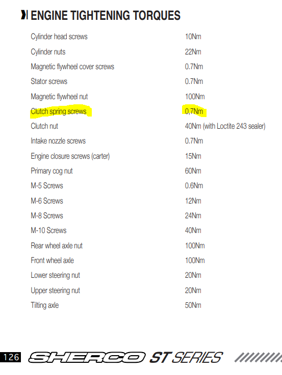

I did find for a Sherco, that the torque for the clutch spring screws is 0.7Nm (0.516 FT/LB or 6.2 IN/LB)
http://shercousa.com/pdfs/Workshop_Manual.pdf  Page 4 of 60.  in the PDF
I know it is a different brand, but the clutch design may be similar enough that the torque is similar as well.
 That is a good way to break a basket that might be hard to replace. Being spring loaded they only need to be snugged up and just barely a small bit more.
6 IN/LB is just snugged up and just barely a small bit more.
