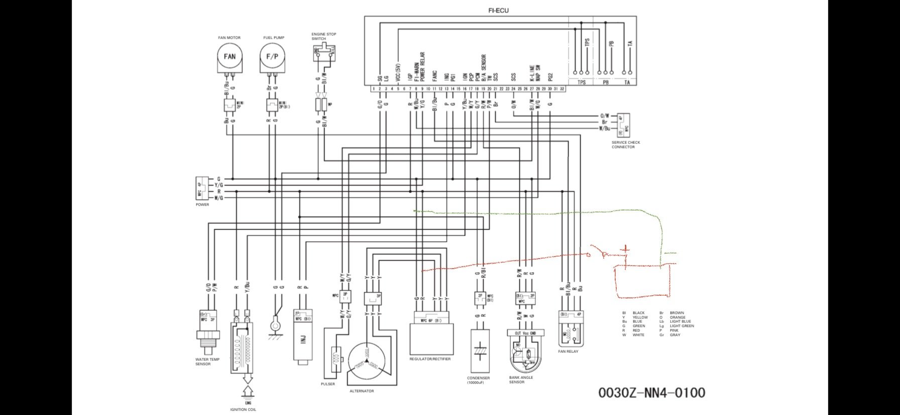

sorry tO make you confuse.. back oN basic.. this Montesa had some modification oN the electrical system.. now.. i like tO put back my Montesa tO original set up like you have.. i don’t know witch cable tO connect tO rectifier.. from there i Will start.. please sent me rectifier conection picture

Hi Jonny,
yes, i like tO remove the smart battery..? can you guide me tO put back 4RT standart? I need help tO put back the wire from rectifier tO the system.. bcs oN the manual book diagram only mention 5 cable.. and i don’t know witch pin need tO be used..

Can you sent me rectifier socket picture for cable color connection?

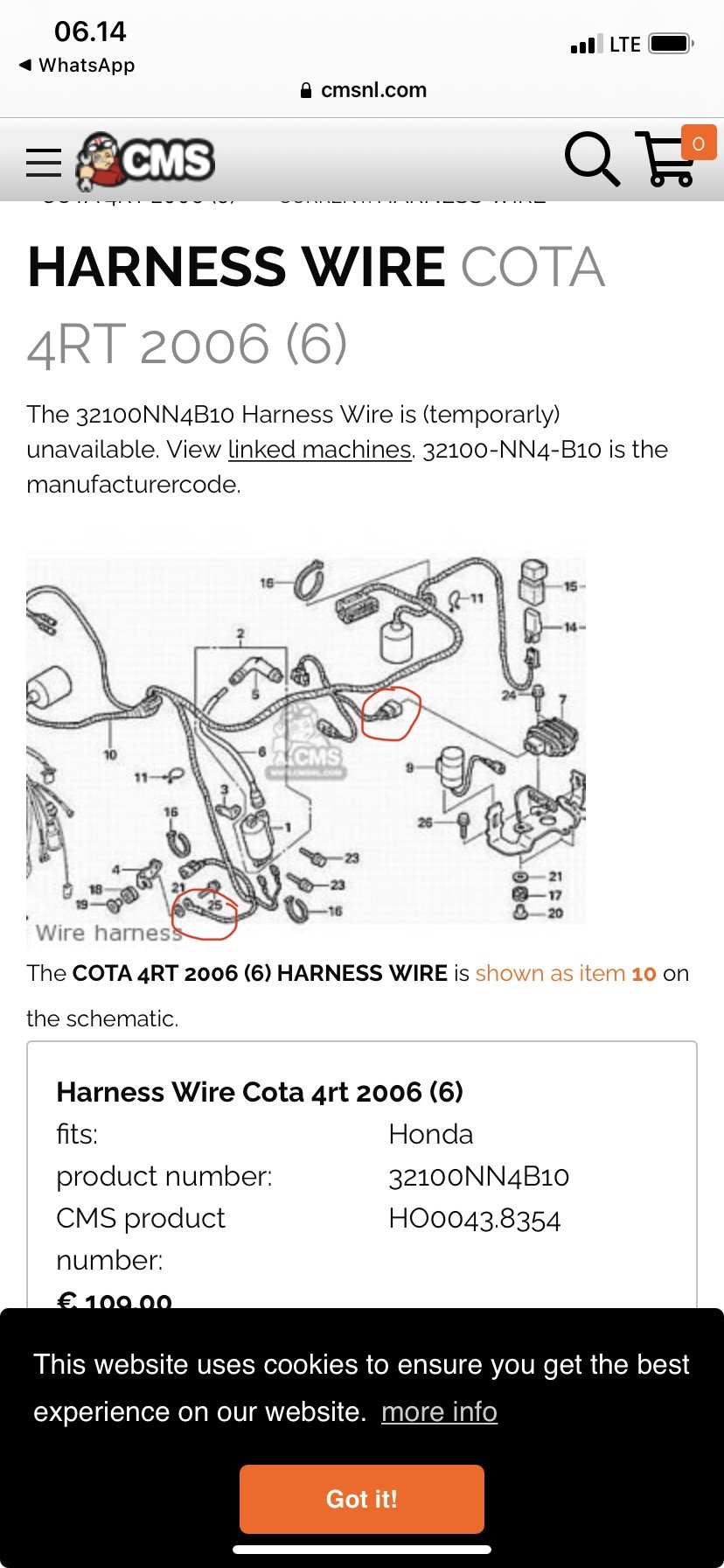

Hi Johnny,
can you help me for cable color & position oN the attached picture.. In the circle mark?

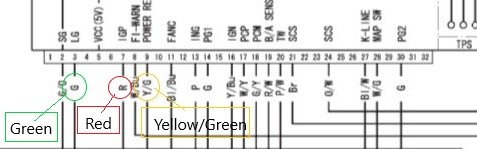

I am very busy with work and haven't had time to work on or do anything with my bikes in weeks.  It will likely be several more weeks before I would be able to spare the time to take it down to the point I could take any pictures.
However if you get a good copy of the diagram it has the color codes on it the legend is in the lower right of the image you posted.  See the example snip-it to see a sub section decoded a bit using the legend.  .
