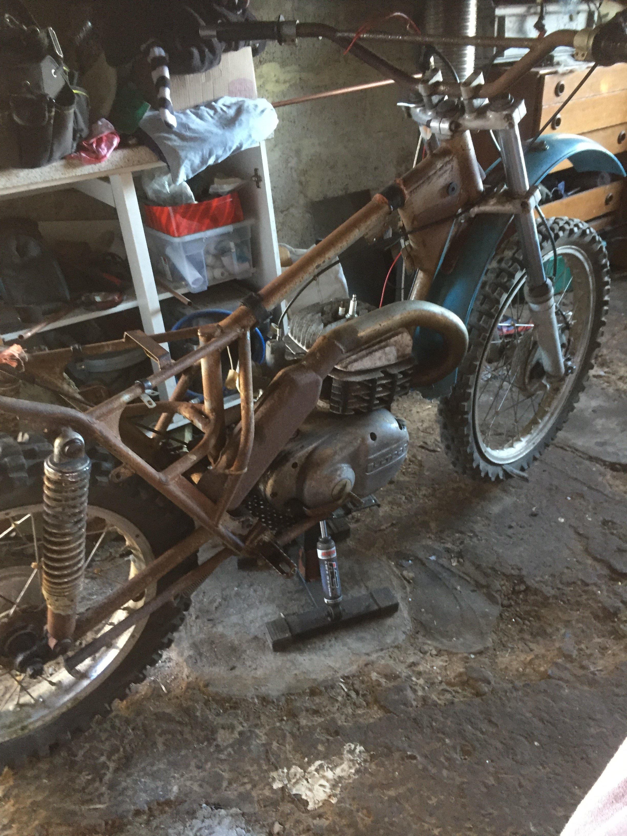

Hi . Just got a 116 Alpina project . Some of the missing parts are seat , elephants foot silencer and airbox /filter .
looking for parts .
Also advice on the fuel tank , I don’t know if it leaks but the rough inside finish and petriol soaked interior means it can’t be sealed inside against modern fuel ,any suggestions ?
i’m in Scotland so UK solutions would be appreciated

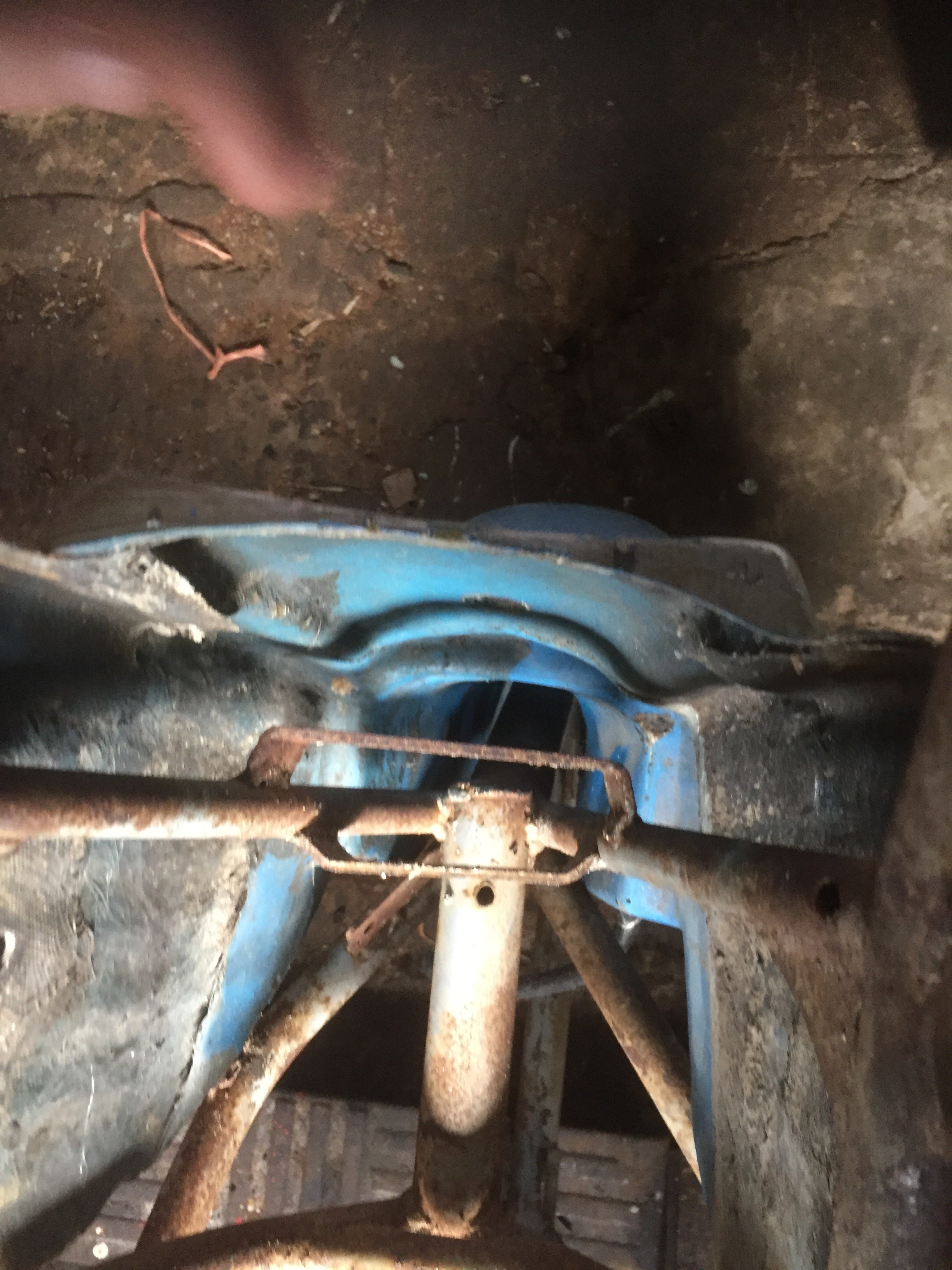

Re . Lining the tank , when I described the rough inside of my tank ( glass matt sticking up from a badly installed base ) to the chap at tank care products , he said it’s very unlikely that it could be lined .
I don’t know if it leaks at the moment but ir looks terrible inside . Where abouts are you Feetupfun ?

I'm in Australia, and every 1970s Spanish fibreglass tank I've lined looks the way you have described it beforehand or worse. It doesn't matter if it leaks or not before you do the job
I have repaired two tanks that were effectively destroyed from the inside out by ethanol and were leaking. I have cut the inside of the tank out carefully with a small dremel cutting disc, so I end up with two pieces, the part that goes over the backbone that you cant see and the outside cover that you can see. It then becomes very easy to clean up the inside of the tank and brush on resin over the whole of the inside. It's relatively easy to reassemble the two pieces as long as you are patient and do not try to do the job in one go. I basically glue the two pieces together without any matting, then fibreglass over the join using matting. When finished I pour a cup of colored resin inside the tank to go over the join from the inside. The last one I completed did not even require painting and both tanks are performing perfectly. This is a time consuming process and is going to take a week to complete, but is relatively inexpensive, the key being to plan where you are going to cut so that you have good access to the inside and the reassembly will be easy.

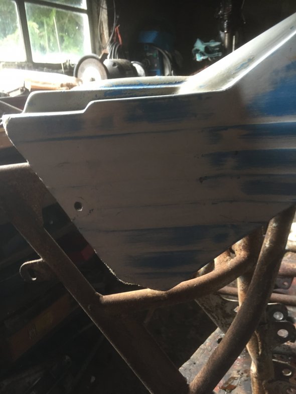

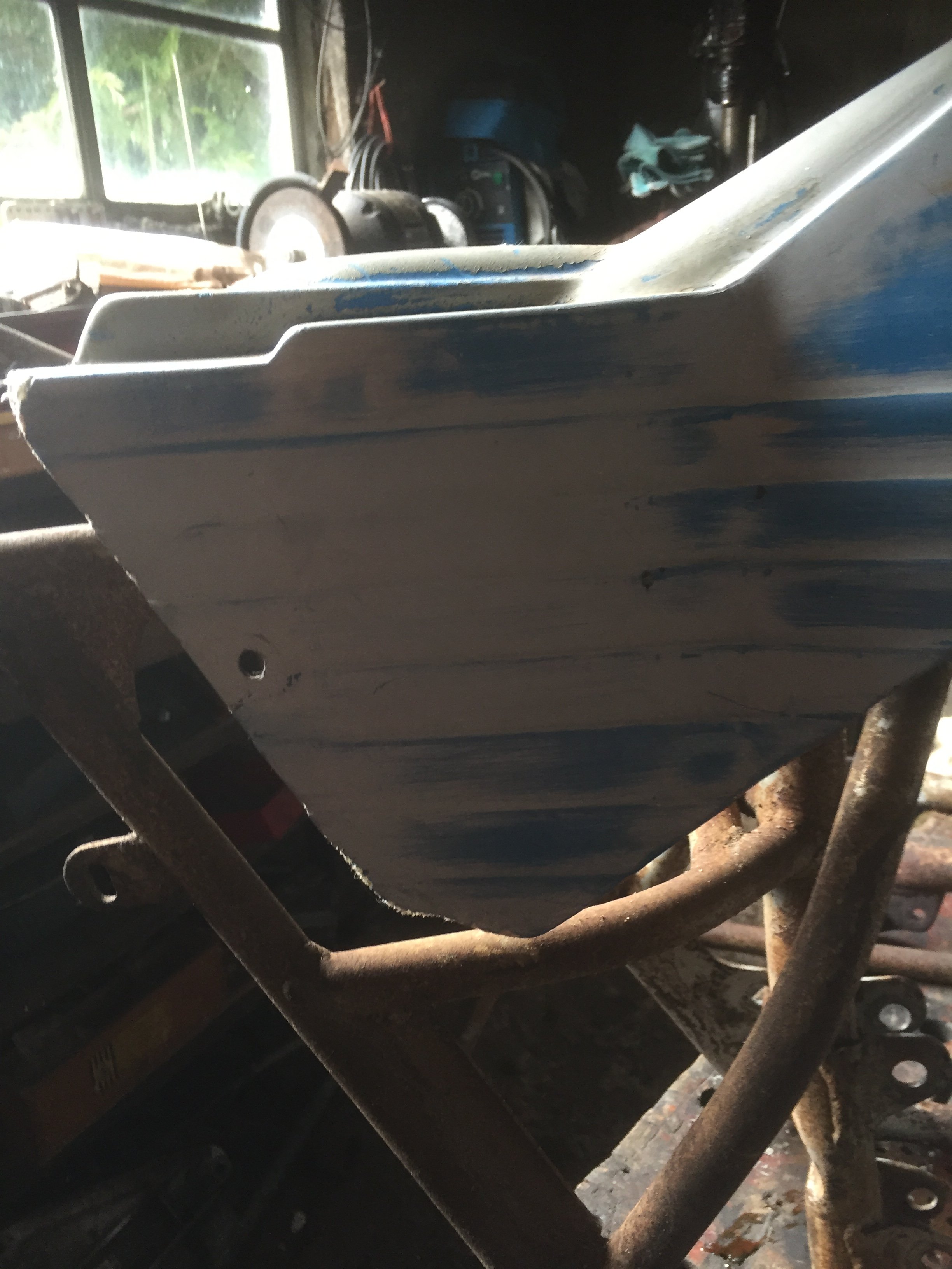

Greg, Do you think this is the right tank ?
Doesn't seem to line up at all .
Hard to say but it looks like a one piece tank off the earlier models. The reason I cut the tank apart was so I could clean up the inside with a sander, removing any matting etc and then paint on a coat of resin to seal it

That looks like a tank for Alpina models 85 and 99. That tank is made for the Alpina frames that don't have the frame element that runs upwards and forwards from the swingarm pivot
This what your Alpina tank shape should be to fit your frame. This is a 115 which is the the 250 version. The 115 and 116 have the same shape tank. The 250 has a silver stripe and the 350 has a yellow stripe
