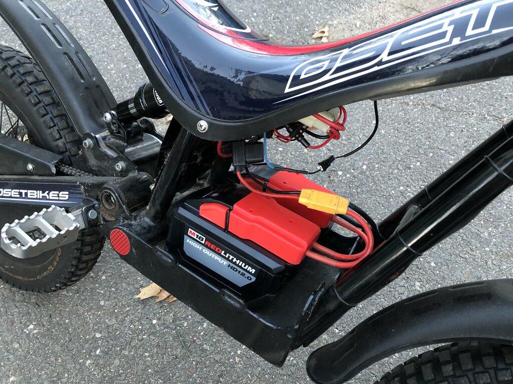

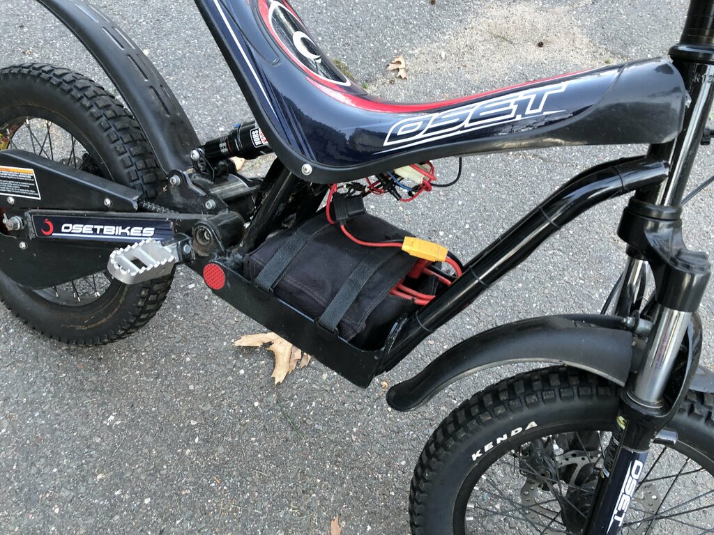

replaced stock batteries with 2 Milwaukee 12Ah.  3 stock batteries 20lbs 5oz, new batteries 7lbs.   battery adapters 3D printed from ebay and XT90 connector. retained  with stock cover on velcro's.

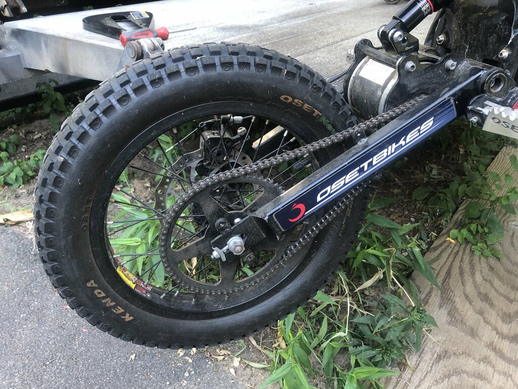

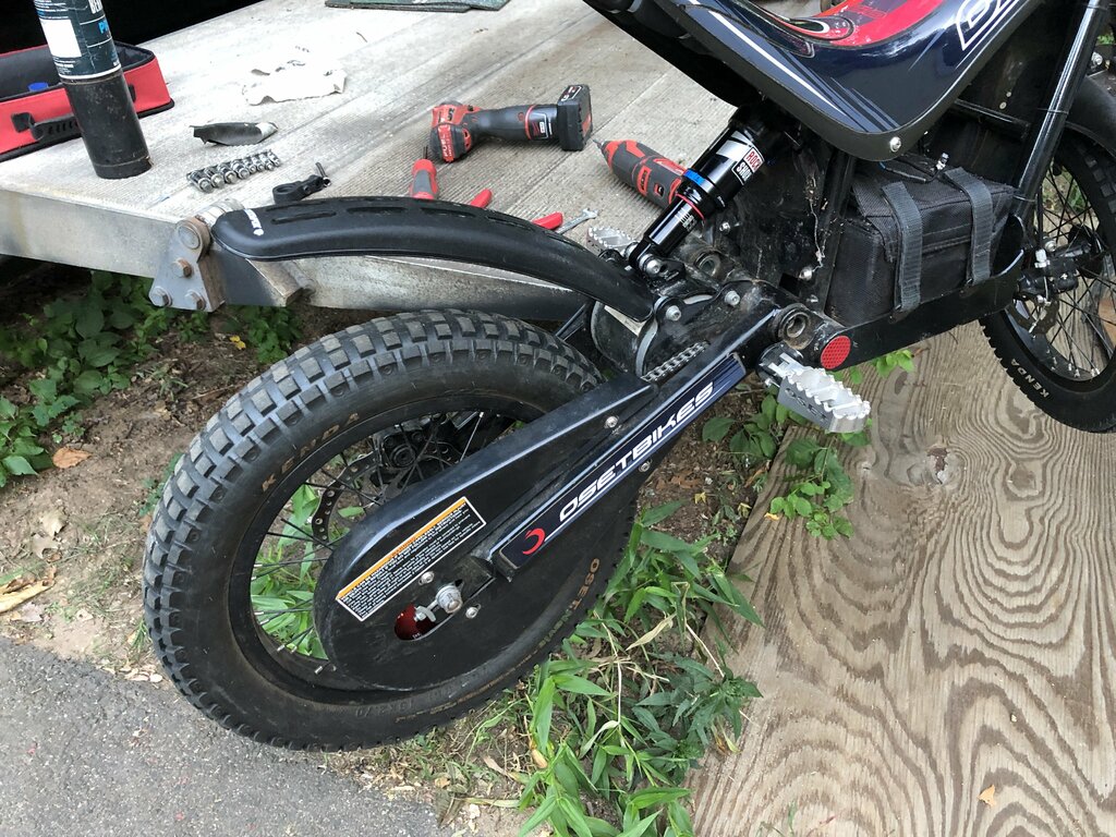

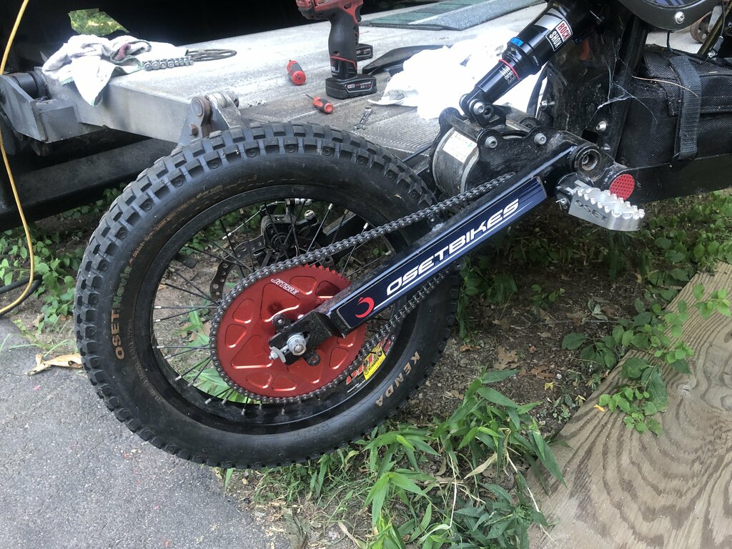

new plastic front and rear fenders.

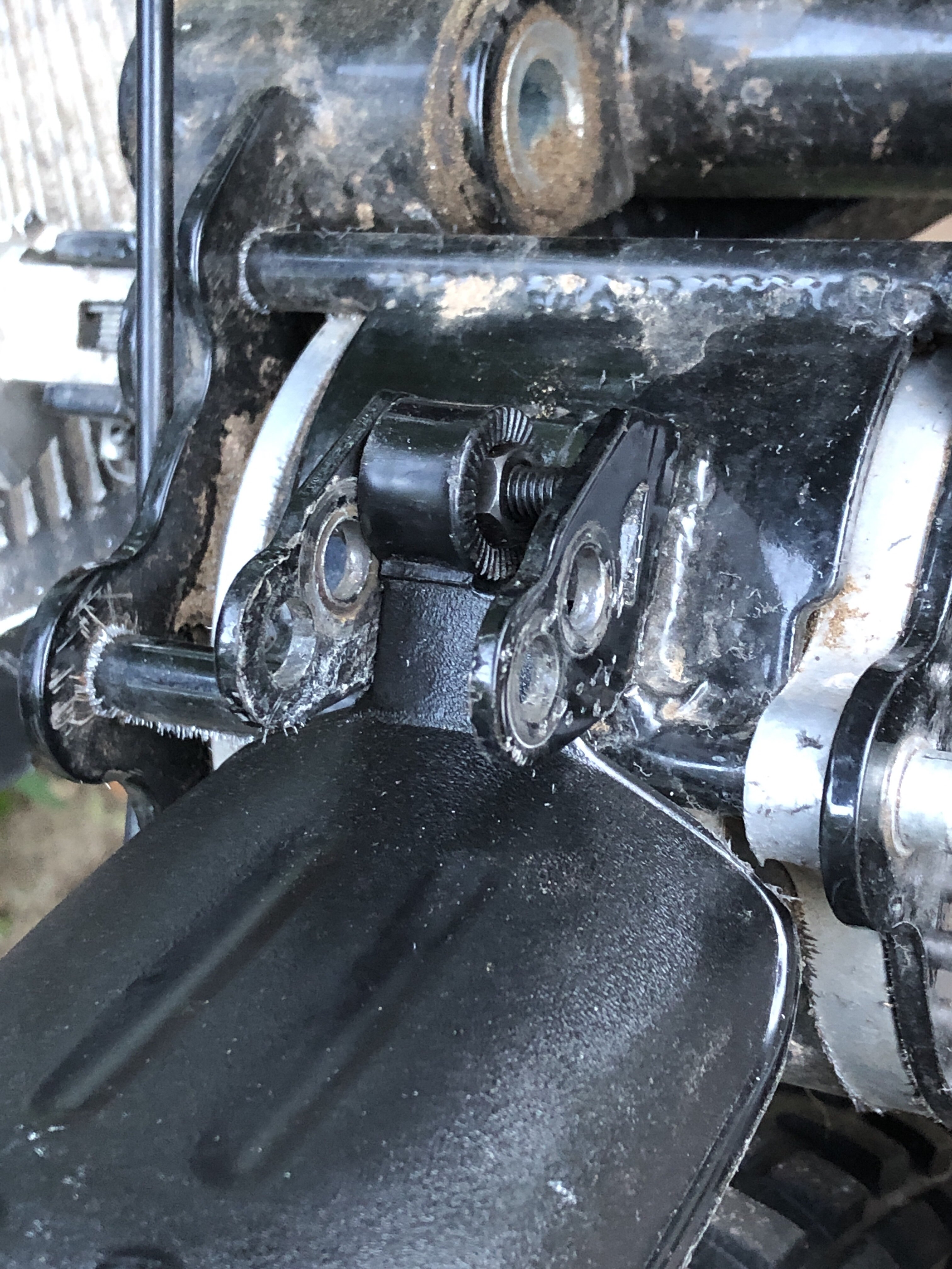

rear fender mounting required some modification of fender, also heating up and changing angle of plastic mounting tab.   and drilling new hole on a bikes mounting bracket where rear shock is mounted.
