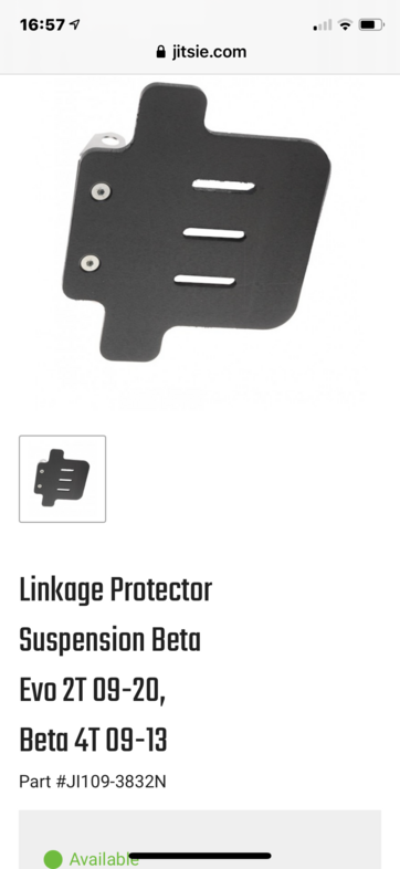

Anyone fitted one of these to a 4T. How are they attached? and has anyone fitted one to a 2013 to 2020 4T?  Thanks.
Beta do a plain plastic one fitted to all later years models which will fit all earlier models (mine was 2011) and are available from Beta UK or through dealers.  It is held between the rear edge bash plate and the bottom of the frame and may need a locating hole  drilling in the bash plate.  And it's a good opportunity to remove the bash plate and straighten out any dents so it is a stress free pull up into position on the engine!
