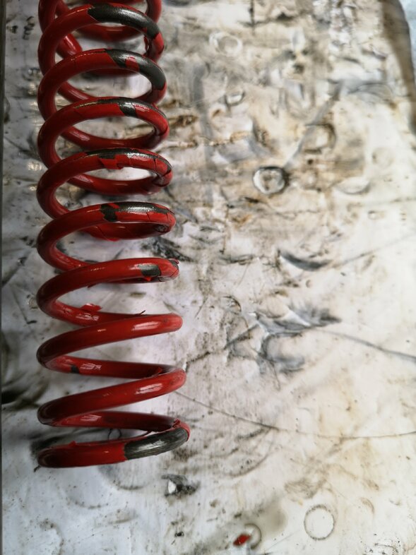

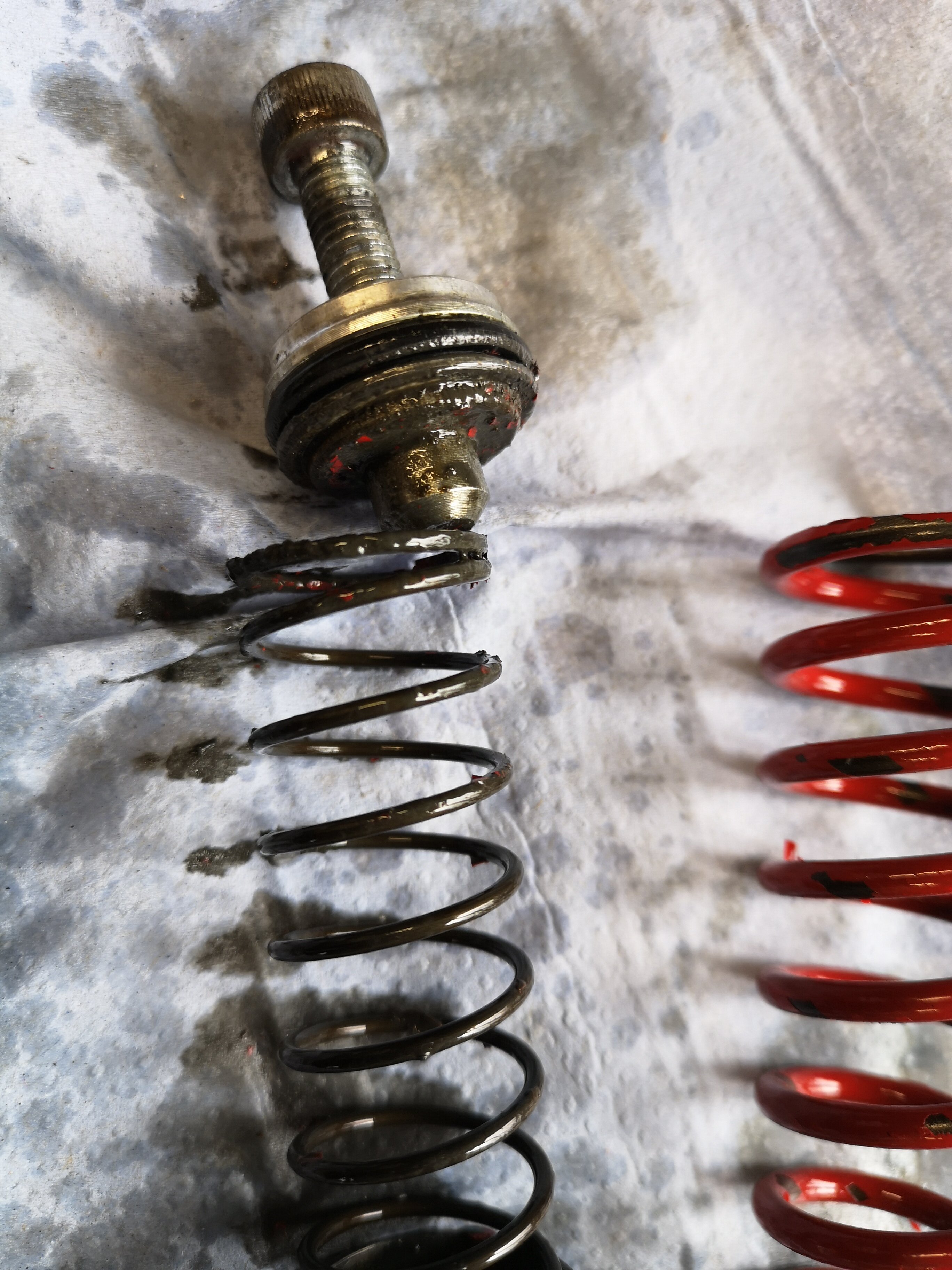

I haven't serviced forks on a trials bike before but have serviced forks on road based bikes several times. When I split the gas gas forks, I noticed the springs are coated in red paint and this has all started to flake off and obviously contaminate the oil as well. This seems like a silly finish to have on a fork spring. Are these aftermarket springs?
One of the forks also has a broken shim (RHS fork). I'm not sure if I was a bit rough removing the cartridge (it wasn't easy to disassemble as parts were jammed together with the ground up paint from the spring) or if it was broken in there all along. Where can I get parts for these forks? I've been googling and found a parts diagram but the part numbers show up as discontinued/out of stock everywhere.
18 hours ago, arnoux said:
Non standard finish on the fork springs, stock ones are not painted.

Oh, yes, the paint covered springs are after-market and are clearly a bad design; OEM springs are unpainted.

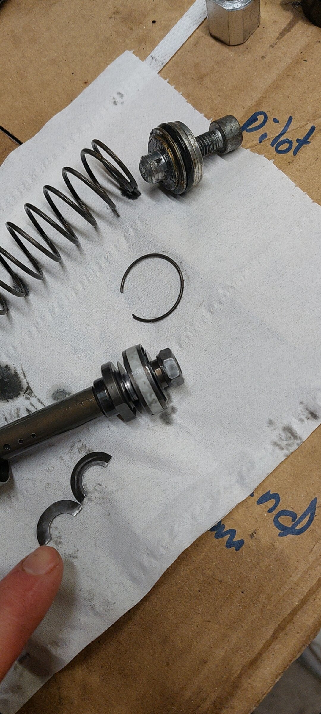

Screenshot_20230109_191415_Gallery.thumb.jpg.a432bd5d43b1305468cfff09cb1d53e7.jpgShady, I have just found the same issue with a broken shim, but I'm not exactly sure where mine fell out of....
Where did you get the shim in the end,  I'm based in Ireland also..
Thank you
