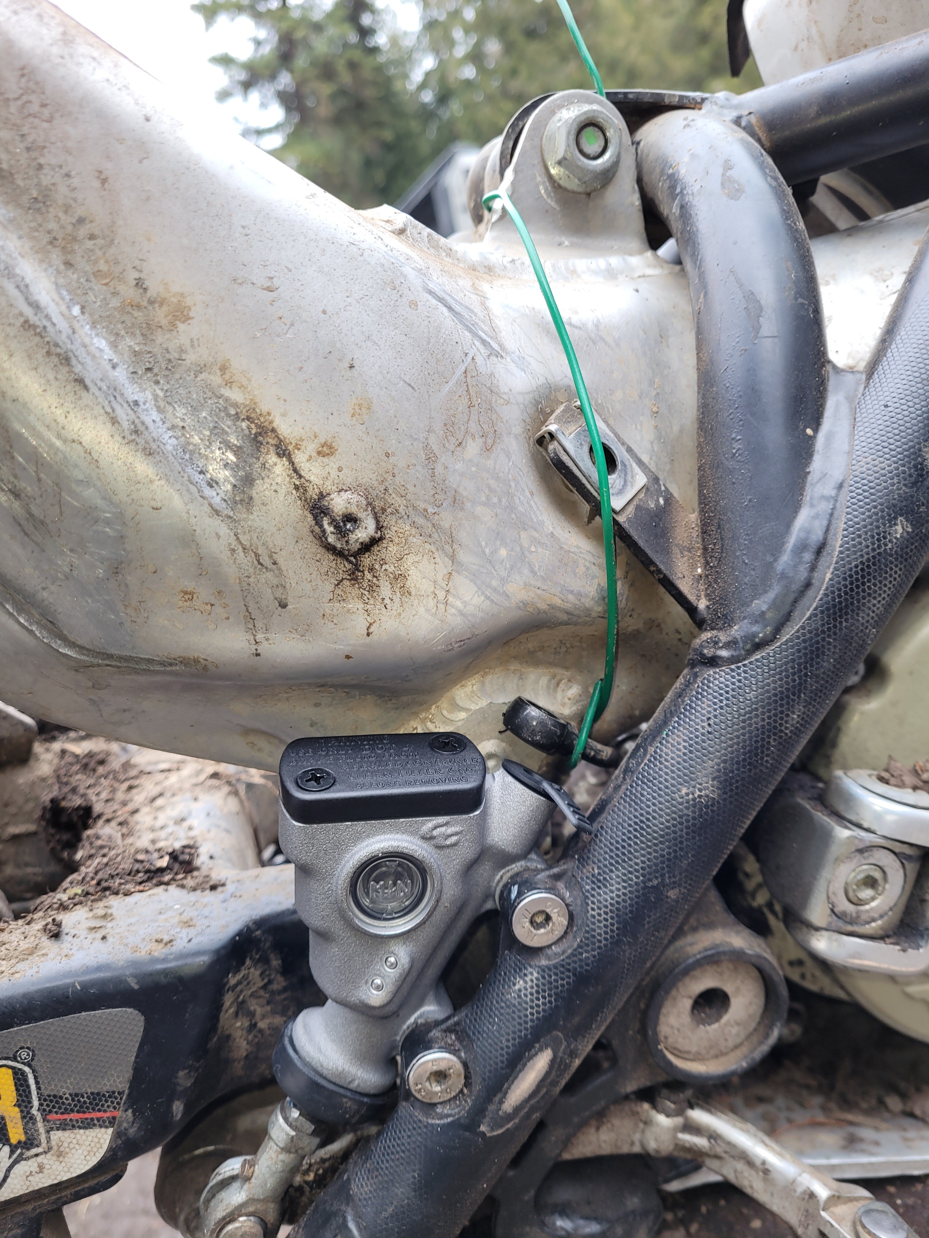

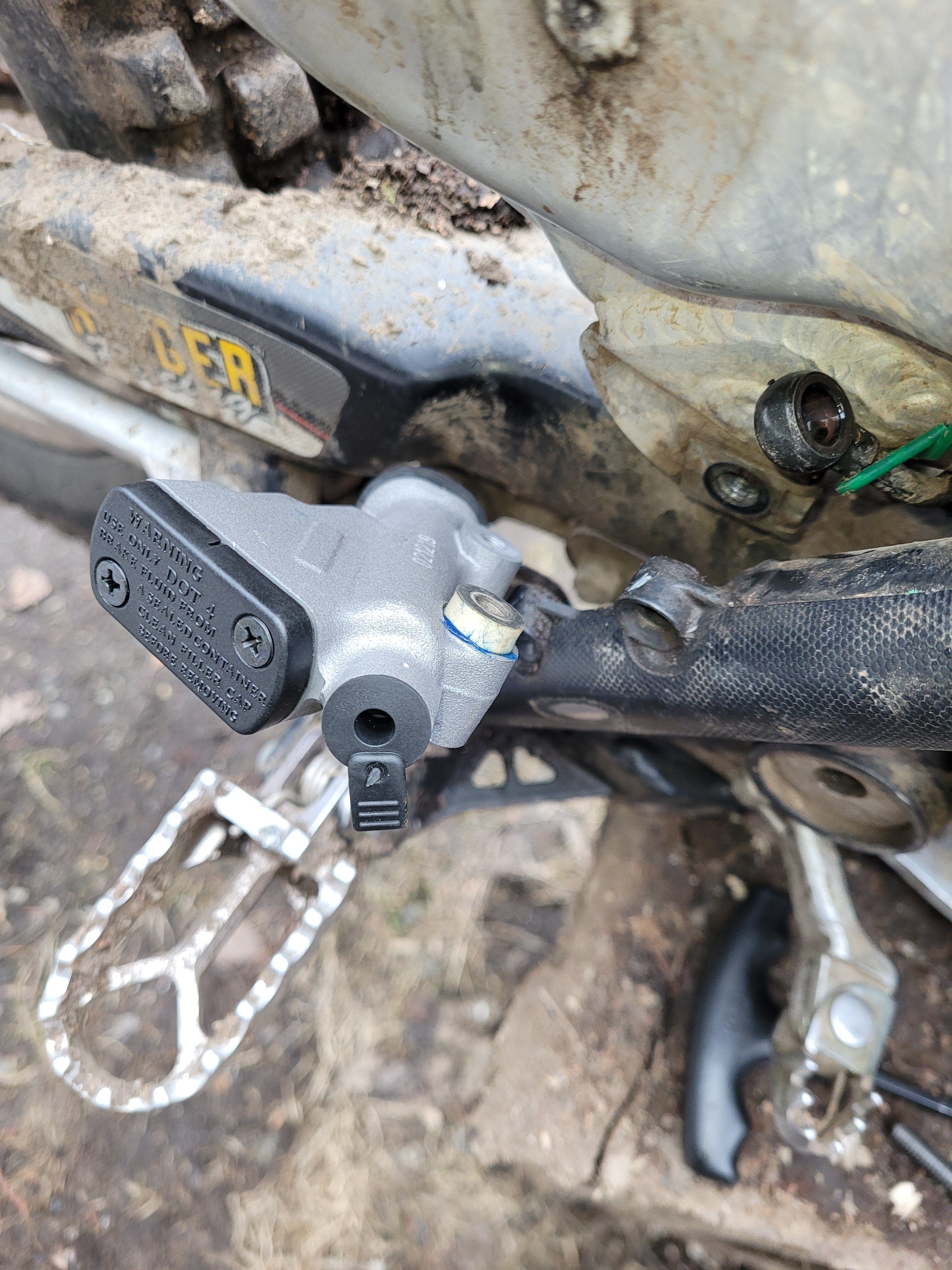

New master cylinder, brakes are rock hard. Could have easily lost the spacer on the top bolt and wired up the brake line to keep air from getting in. I'll try to add pics. Easily bled from the master banjo bolt... do they call that a banjo bolt everywhere?
