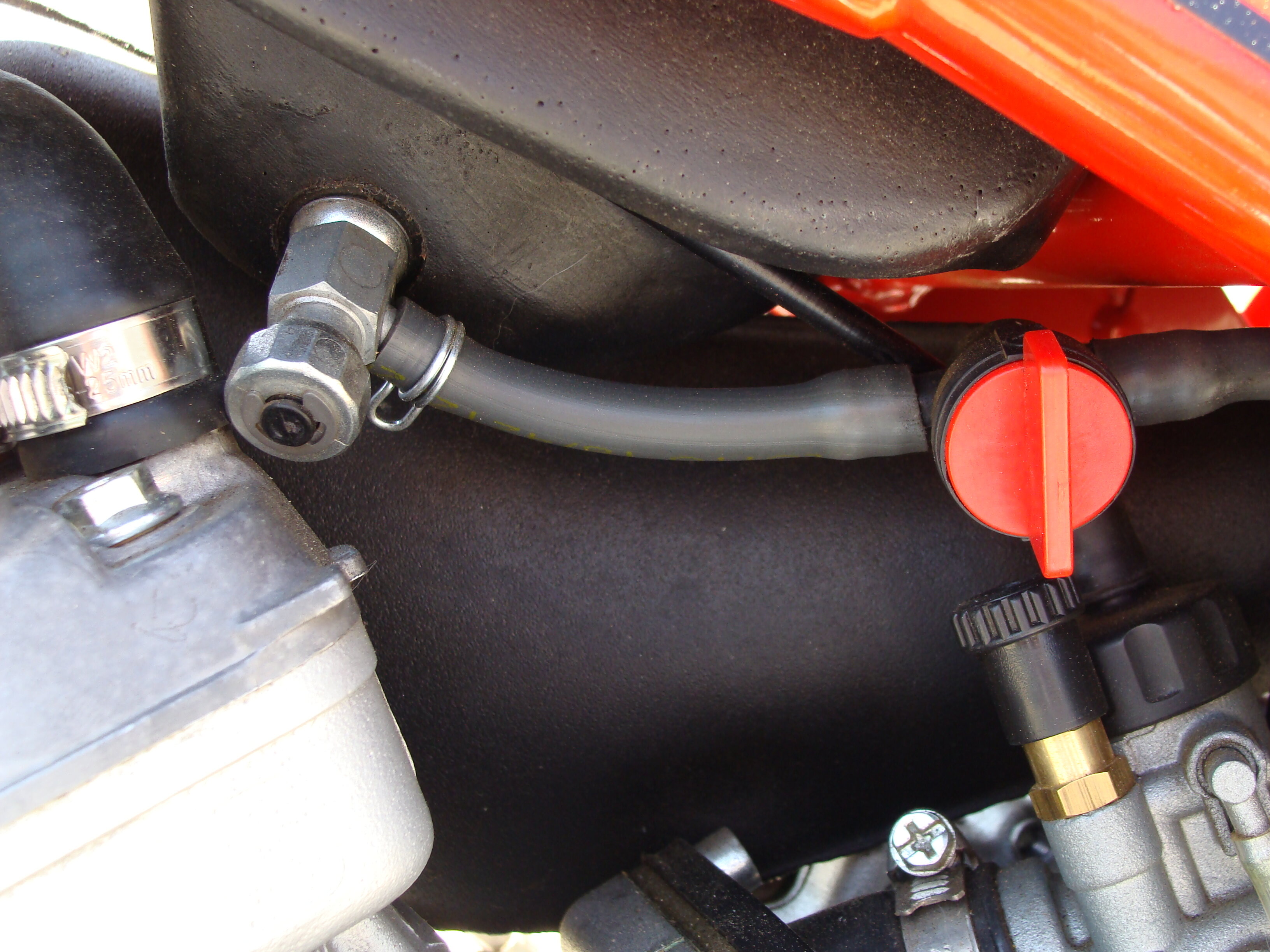

Was it running ok previously or has this just started. These bikes have a poor petrol tap. They can become very stiff to fully open, always a possibility that the tap isn’t functioning. Had to replace one on my sons for exactly this reason
You can get a lever style fuel tap from these guys https://www.trialsuk.co.uk/Beta-Fuel-Tap---EVO80REV80REV50---Lever-Style?search=fuel tap
More efficient & easier to use.

I agree with timdog, for I had the same issue on my 2022 EVO 80, and it was lack of fuel flow related.  I fully opened the OEM fuel tap, checked for adequate fuel flow and installed an inline shut off valve.  No more issues.
