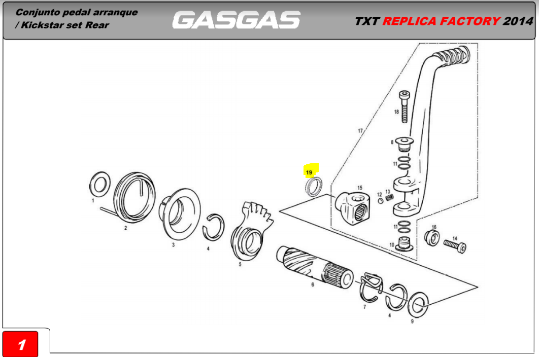

Where does this tapered washer go please
My lad has stripped clutch down to put new tophat in but got this silver coloured tapered washer left. Where does it go please. GAS GAS factory 2014 250
Any help welcome
Edited by nicbrrghs
missed out model
I'm pretty sure it goes between the clutch cover and the kickstart shaft. So you install the clutch cover, then this tapered washer then the kickstart itself. Larger end butts up against kickstart
I believe you are correct.
12 hours ago, Creepytheclutchmaster said:
Best idea would be to look on a gas gas spare parts schimatic for your bike. it will be clearer to exactly whare and which way round it goes.

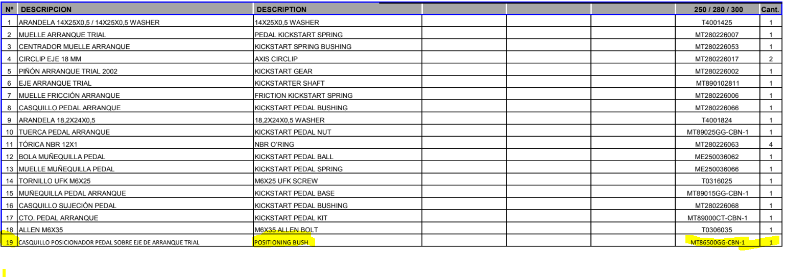

Here's one.
All credit to the Hell Team: https://www.thehellteam.com/technical-support/gas-gas-parts-and-service-manuals.html
Number 19
